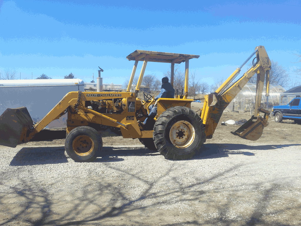

Front pump seems to have broken the shaft to the front of engine, or the woodruff key is broke.  Hopefully a reasonable fix.  Under A fame to decide if I want to pull loader or work around it.

Kind of a weird story.  My wife is inheriting a piece of land relatively close (no pun intented, but I'll take credit).  It has someone working an oil lease on it, and we are trying to get a grip on what that means.  I was looking on the letgo app, and saw it listed, and the 1 name and initial of last name matched that person, and his location matched.  So on  whim I called and asked if he was the one selling.  It was, so I looked at it, and agreed to purchase for $1000 delivered to my house.  Runs, drives. Just no hydraulic pressure for the buckets.  Tore into it yesterday and the splined shaft between the pump and the crankshaft pulley is either broke, or stripped.  Hope to finish today and repair or order parts.

That looks like a nice unit , I have never seen one ( i don't think there is any over here) what tractor is it based on? the loader looks well built . I think you got a good deal  with that  should be very handy to have around

my 615 used a double sprocket wrapped with a chain is what broke on mine if i had to do it over i would use a love joy connector

The splines were stripped.  Just had my machinist friend weld it up.  Hope to reassemble tomorrow.

  Aw shoot,,,Jim,,I was gonna tell you how I  "repaired"  mine for bout $25,,,and I bet it will never need fixin again,,,,,Clap you too fast,,,,,LOL
The loader looks like a TS500,,,??
