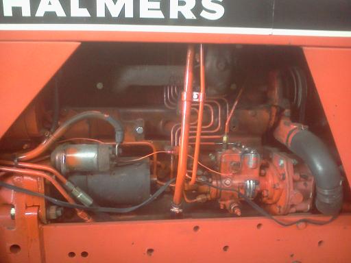

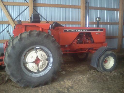

Here are a couple photos of my 170XT.

Never heard of one. Never saw one with those black stripes either. Learn something every day! Good looking unit!

Is that a 433 from a 6080? Looks great in there.

that is pretty nice . Hope you turned it down some. That's a lot of power for that drive line

That's really nice :D ive never seen the fenders black before.

Great looking 170xt!  Did you use a 433T or 433I engine?  I'm guessing you used a gleaner K2 433T?  Was it very difficult to marry up the clutch/transmission housing bolts?  Did you use the existing front hydraulic pump on tractor or use an engine driven hydraulic pump mounted on left side of front plate?  Are your rear tires 30"?

motor is out of a combine and is turbo and intercooled. had to make a spacer plate because clutch shaft was 1.75 too long  and I used a 190 flywheel and clutch. had to make a new adapter for front pump. alternator moved to right side. used 180 water pump housing. tires are 18.4 28.

Nice. What kind of road speed you got now?

The motor is out of a combine and it is turbo intercooled. I had to make a spacer plate cuz the clutch shaft was 1-3/4" too long. I made an adapter for the front hydraulic pump and used a 190 fly wheel and clutch. It has a 180 water pump housing and a 60/80 exhaust manifold. It has 18.4 28 tires.

The road speed is about the same as it was before the modify.

That's what I need in this guy.....the tall front spindles and 18.4 x 34's make it one nice riding tractor....that engine would be sweet in it!

From viewing the changed color of the chrome exhaust stack, I imagine you have put it under load to see how it compares for pulling??  Was the original engine a 226 gas or 248 perkins?

226 gas and it was very under powered

A model 170 with 16.9 x 28 rear tires at 2,000 rpm does 15 mph...........at 2400 rpm it would do 18 mph............18.4 x 28's would be more than that.

Flywheel was 95 HP, so PTO should be around 83 HP at 2,200 RPM (725 RPM PTO speed).
