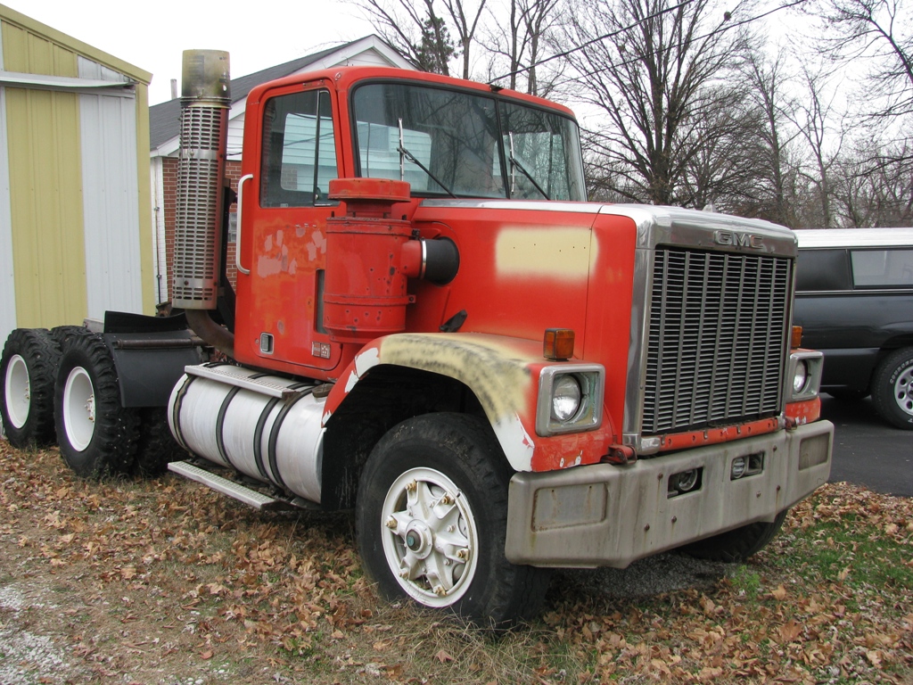

It's a strange general.1980.Short hood,Aluminum frame,day cab,6V92 screamer,5 star but only has single headlights unlike most 5 stars.Factory Air starter.Single seat(factory.Got bracket for BIG extinguisher on passenger side).Fiber doors.single 100 gallon fuel tank.Was ordered by Amoco for tanker service so it was ordered as light as possible.

That is very unusual because a 5star should have had dual headlights all the cab trim, and running lights on the cab roof. I have a Bison which all Bisons were 5 stars but not all generals were. Dont know what it is abut a general but Ijust love the looks of them.Would like to find a long hood 5star with a cummins 400 in, or better yet a Big AL which I dont believe was ever installed in a general. Your is newer if it has the fiber doors. Mine is a 77 that we redid a few years back has a 8V71 right now but in a couple of months we are going to put a MAck in it I just cant take the noise anymore.

Yea,I think the 77 was the only year for the metal doors.It was a bring over quicky fix from the Cabovers.The next year they had the mold in full production and went to fiber.I need a drivers side door as mine is nothing but a skin.Someone cut everything out of it.No inside panel,Window mechanism,frame work,etc.Also need to find me a hood or atleast the very front nose section.The cables rotted off years ago and someone let the hood over-extend to the ground bending the metal frame at the bottom of the grill,distroying the fiber and causing the stainless trim to fall off and go missing.The truck is a real project.$1400 but has a fresh rebuilt engine.The entire wiring harness is shot.the air system was shot,the brake cans were shot,the bearings and seals in all the hubs were shot,the interior is gone(removed and a lot of the parts distroyed).But it runs great,shift great,and before I tore the axles down to replace all the bearings and seals ran down the road great......considering the tires were 20 plus year old Bias 10.00x20s on daytons.

Buddy of mine came by yesterday to check out the lift and wanted me to fire up the Green Leaker(GMC General).Man that thing sound sweet.I have GOT to get it drivable.Wow a 6V92 straight piped sounds like satan himself.

I drove a 6V92 turbo'ed for 10 years. Mean little bitch and you couldn't yell at the person next to you in the cab at 2200RPM. Finally put a huge muffler under the wrecker bed and it tned it out nicely with dual 5" pipes. Ran great and pulled like hell with a 13 over behind it good up to 60,000LB's.
We have an 88 5 Star General Firetruck in my station. Long hood, twin headlights, steel doors. 300 Cummins w/4 speed allison auto behind it. Smoothest driving firetruck you've ever been in. Really goes down the road well.
