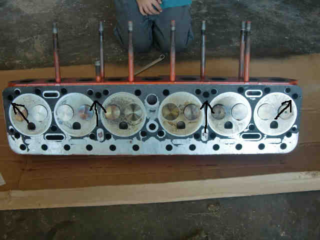

Hope this loaded and comes through OK.
This head has four "wet" bolt holes.  All are on the manifold side.
It was cast that way from the factory. That is obvious. Whether they were all that way from the factory or whether this one is defective, or whether there was a bad run of them, is up for discussion.
Still deciding my next move.  I don't want to source another head if they are all this way, and I'm not too excited about doing repairs if it's supposed to be this way.
If someone has one of these G262 heads lying around that he or she feels inclined to look at and advise me, that would be sweet.
Thanks!

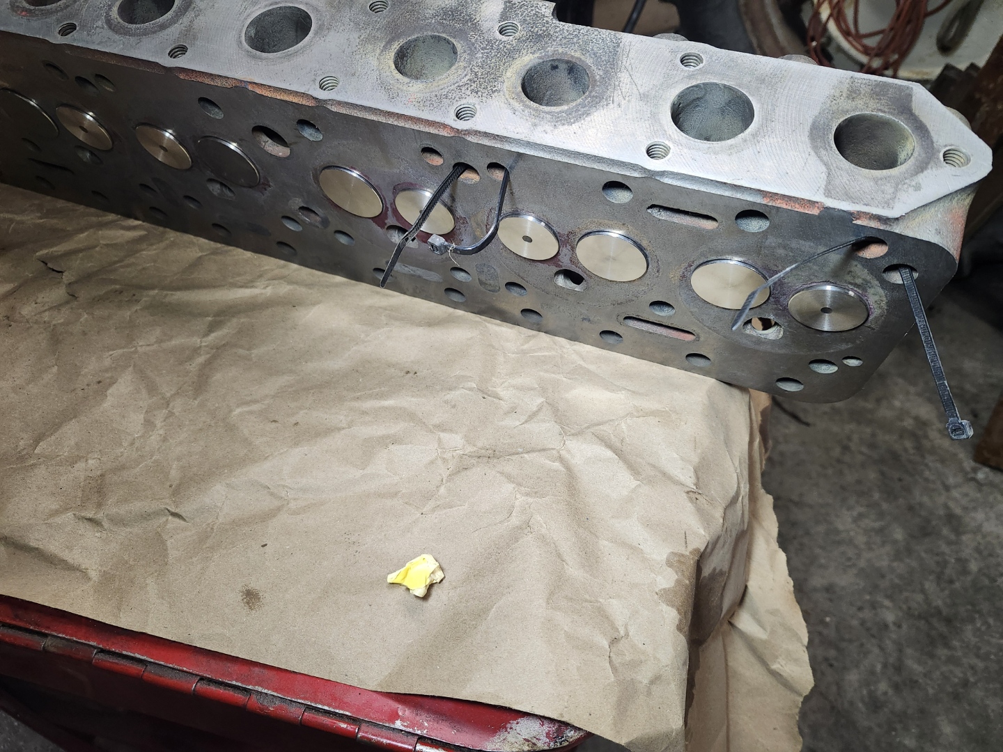

This is mine. Fresh from the machine shop
Note the zip ties passing through water jacket and head bolt holes

THAT'S IT!
I guess they are supposed to be that way! Who would have thought? One learns something new every day!
New washers and bolts coming up (some of mine are starting to stretch) along with sealant on both sides of the washer on the wet holes, and BUTTON THIS BABY BACK UP!!
