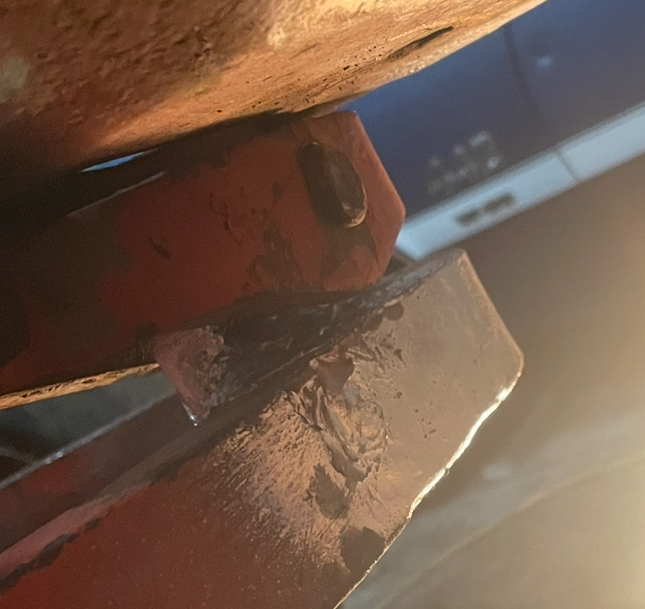

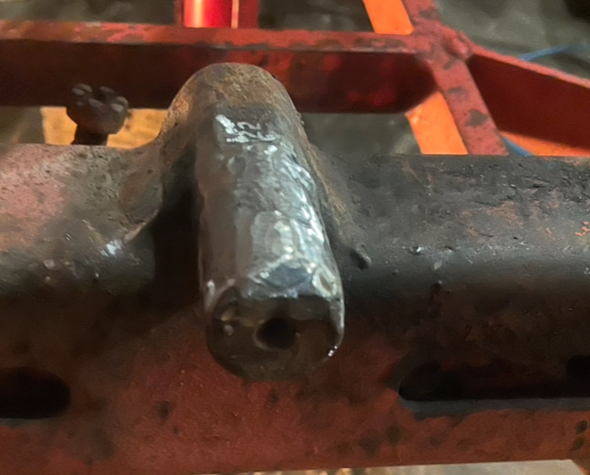

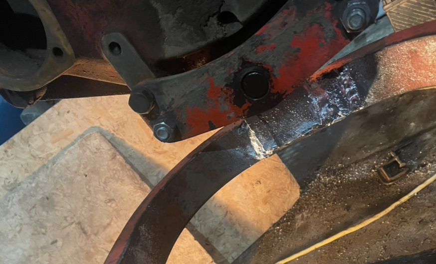

Got the front end adapted, wasn’t as bad as I thought it was going to be.
Cut the rear pivot point off and welded a 4”by 1 1/2” by 1/4” thick steel to space it out. Surprisingly that’s all it needed.
Also built up the front pivot shaft. So now there’s hardly any slope in the pivot system.
