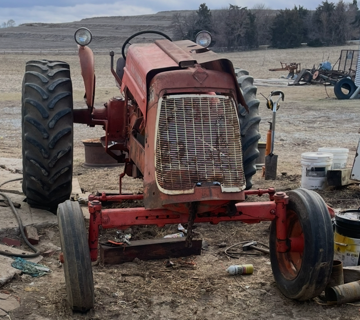

Set the new hood and grill on it today and put the rear tires on.
Still waiting on the crank, hopefully it comes next week.

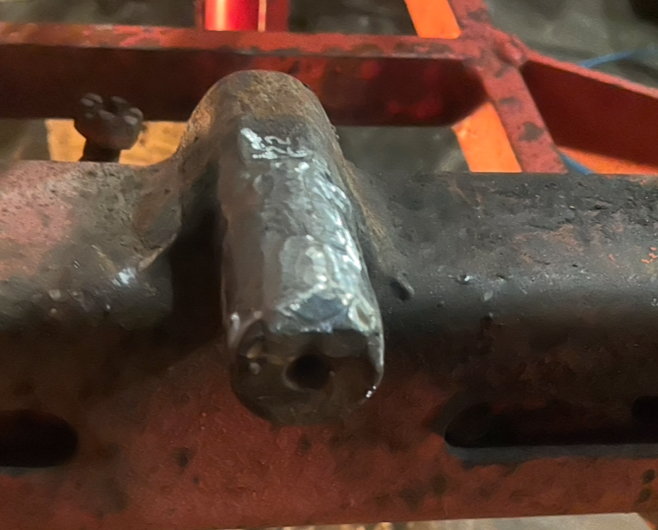

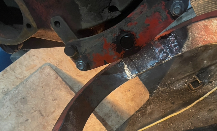

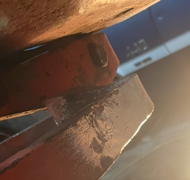

Got the front end adapted, wasn’t as bad as I thought it was going to be.
Cut the rear pivot point off and welded a 4”by 1 1/2” by 1/4” thick steel to space it out. Surprisingly that’s all it needed.
Also built up the front pivot shaft. So now there’s hardly any slope in the pivot system.
