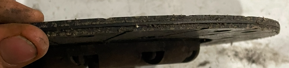

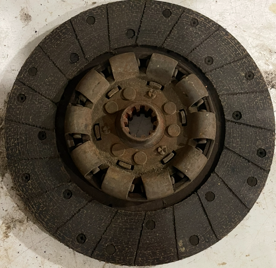

Does anyone know of a place to get the clutch disc relined?
The clutch it’s self isn’t too bad, just the pads getting worn down.
I’d rather fix it now before it wears into the rivets.

Doo a google search for clutch repair or reline. You should find some locally. There are a few near me. Sounth Bend Clutch and Fort Wayne clutch.
If you're doing the clutch you'll need to have the flywheel ground and stepped and also have the pressure plate rebuilt.

Clutch measures at 5/16” thick, measuring both pads and the disk its self.
Not sure what the specs are supposed to be..
