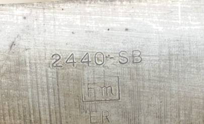

Got the crank off completely and the main bearings look good.
Found this number on the back of the rod bearings. [IMG]

Federal Mogule brg and probably their part #. Heard of using easy off oven cleaner where grimy.

I think the SB on your bearing is probably standard bore or standard bearing.
