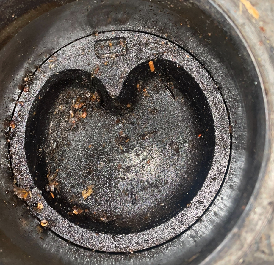

Post Options Post Options   Thanks (0) Thanks(0)   Quote 55allis Quote  Post ReplyReply Direct Link To This Post Posted: 22 hours 24 minutes ago at 2:40pm
Here’s a picture of the piston in it.

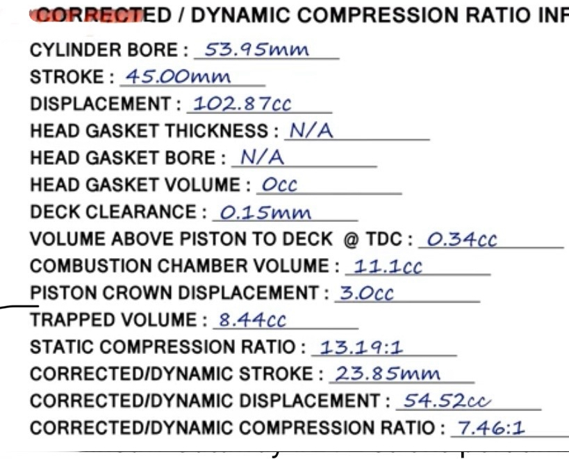

Also surfed the web and found this chart for a single cylinder.

Les Kerf View Drop Down
Joined: 08 May 2020
Location: Idaho
Points: 1345
Post Options Post Options   Thanks (0) Thanks(0)   Quote Les Kerf Quote  Post ReplyReply Direct Link To This Post Posted: 22 hours 2 minutes ago at 3:02pm
That piston looks just like the hoof on my Norwegian Fjord Horse's foot! LOL
Head gasket thickness and bore N/A? (Not Applicable/Not Available?) It is a pretty important factor there methinks Confused

Post Options Post Options   Thanks (0) Thanks(0)   Quote 55allis Quote  Post ReplyReply Direct Link To This Post Posted: 21 hours 44 minutes ago at 3:20pm
It’s just an example, not for this engine.
I was going to erase what is written on it and change it to the 226 engine.
