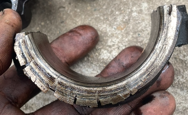

Got the oil pan off today and figured out why it was parked, it had spun a rod bearing…
scott View Drop Down
Location: michigan
Points: 2769
Post Options Post Options   Thanks (0) Thanks(0)   Quote scott Quote  Post ReplyReply Direct Link To This Post Posted: 15 Oct 2025 at 9:30am
Is the spun rod bearing on one of the good cylinders?

Yes, it was number 4.
1 and 4 has good sleeves but 2 and 3 sleeves are junk.
Got all the pistons and sleeves out and the pistons look all good. Even the rings don’t look too bad.

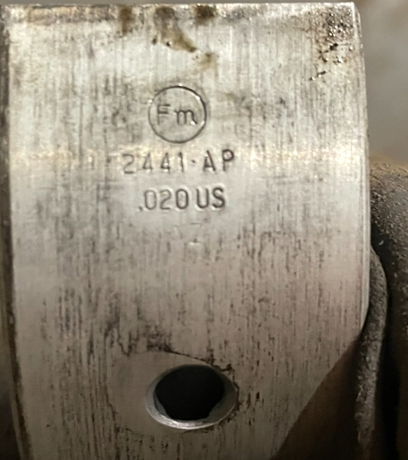

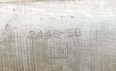

Got the crank off completely and the main bearings look good.
Found this number on the back of the rod bearings. [IMG]
Edit: doubled the pictures.
Edited by 55allis - 19 Oct 2025 at 10:36pm
Points: 8971
Post Options Post Options   Thanks (0) Thanks(0)   Quote SteveM C/IL Quote  Post ReplyReply Direct Link To This Post Posted: 19 Oct 2025 at 11:37pm
Federal Mogule brg and probably their part #. Heard of using easy off oven cleaner where grimy.

I use a regular pressure washer and elbow grease. Lots of spraying (solvent), scraping, brushing, then hitting it with the pressure washer. My pressure washer is 3000 psi and I use a turbo nozzle (stay away from wires and small lines).
I would use a hot water pressure washer in a minute, if I had one.
I think the SB on your bearing is probably standard bore or standard bearing.

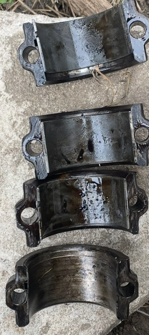

The main bearings have been turned once I think.
But they don’t look bad..
