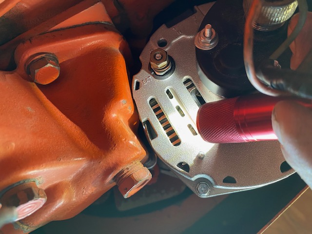

Lol…grinding and fitting grinding fitting grinding …on the alt case in order to mount the pivot bolt as the top of the case hit the thermostat housing. Once I could get the pivot bolt in and tighten there was plenty of clearance. Plus I had to “clock” the   alt 180* which was new to me. Ian and I made and mowed 3600 bales (40 lbs) this past week. Flying tomorrow. Thanks for everyone’s help! Dana

That's disappointing. I would have ASSUMED coming from D & B that it would have been a plug-n-play not needing anything. I'd be complaining if it was me.
Points: 88672
Post Options Post Options   Thanks (0) Thanks(0)   Quote steve(ill) Quote  Post ReplyReply Direct Link To This Post Posted: 01 Jun 2023 at 7:11pm
A "replacement for"...UPGRADE.. but not EXACTLY the same size... . Maybe one was made to INCHES and the other was made to MILLIMETERS ? Wink
How did the TACH work out ?  everything screwed together and it reads correct ?
your ORIGINAL was a 10DN ...... that is the difference.. GOOD JOB !

D&B had a great price with free shipping si I bought 2.

D&B equip is Excellent ............ Just a little TIGHT for this application... I would have thought SOMEONE would have told them about the interference fit since they DO advertise that this is specifically for the ALLIS tractor.....Its probably the only option with a TACH, but they could warn you that you need to "grind the corner of case".

Finished the alt hook up…and it seems perfect. Turn on that AC and she goes to work nicely. I bought 2 so we have another spare. Oh yeah tach worked good too.

Is the PIVOT HOLE in the engine block..  or could the bracket be LOWERED 1/4 inch to get room ???

The "DN" series case is shaped a little differently than it's "SI" cousin. Doesn't surprise me that the "SI" needed a little mod done. That is pretty tight in there fir' sure though, even for the "DN"....!
