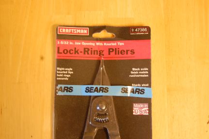

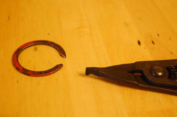

After all the help I received on this question, I thought I owed it to you guys to show you the solution I wound up choosing.   I drove to my local Sears store and found these pliers for $14.99 plus tax.  You guys saved me a lot of time and trouble.  Thanks.
