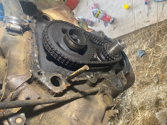

Cover is off (and it wasn't easy) and broken bolt is finally out. Had to hack up the cover and once inside was very plain to see, corrosion to the bolt was holding it on. No amount of heat or soaking was going to free it up. Had to go postal on it. Once cover was off, the bolt backed out easy with vice grips.
Once inside, looks to me like timing chain is suspect. Good amount of slack in it. If going to replace, no time like the present.

Your issue was same as one shown in video link you posted. Corrosion of dissimilar metals in the cover itself. The flaw in design is not addressing the problem before the corrosion begins. Some sort of anti seize or bushing would be in order.

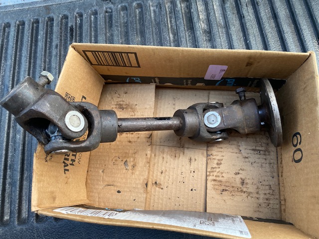

Found a solution for the PTO U joints. There is a welding / fabrication shop about 20 miles from here in middle of nowhere. Bearings, U joints, hydraulics and related. If they don't have it, you don't need it. Total cost........$30 installed.
