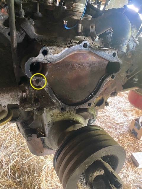

Quick update......with new replacement alternator, pulled the old one and was ready to install new........instantly ran into trouble. The lower, main support OEM alternator bracket is held in place by either two or three bolts......depending on the age and style of water pump......but that braket and the bracket to tension it is held one by only one bolt. One of 7 that holds the water pump in place. The key one.......the one that has to be used.......was found to have been snapped off inside the water pump housing. That bolt passes thru bracket, bracket, water pump, timing chain cover, then screws into the block.....and the end of it is open to coolant. So to install, a good thread sealant has to be used. No telling now many youtube videos there are documenting removal of that snapped off bolt. Now my turn to figure it out. Has been soaking in penetrating oil for days. Trying hard not to snap it off again as that would require removal of timing chain cover.  Exciting times.
Next question.........I now have 3 or 4 of these long bolts out, and hopefully 4th and final is coming out with no drama. I normally would plan to chase the threads in engine block with an oiled tap before putting bolts back. Problem being my 3/8" tap appears to be damaged (won't go into a matching nut without binding) and not long enough to reach thru the timing chain cover to get to the threads in the block anyway.
Do they make a longer than standard tap with 4 inch or so shank? If so, what is now a good brand to buy? What I have now are Blue Point, which as I understand it was an economy line of tools sold by Snap On. I may be able to buy Irwin or Hanson locally. Anything else to consider?

Post Options Post Options   Thanks (0) Thanks(0)   Quote modirt Quote  Post ReplyReply Direct Link To This Post Posted: 16 Jul 2025 at 3:32pm
As she sits now.........that big 4 belt pulley is in place of a harmonic balancer. Have no clue how that is being held in place.......and no desire to find out. But if that bolt gets snapped, I get to find out.

Post Options Post Options   Thanks (0) Thanks(0)   Quote Acguywill Quote  Post ReplyReply Direct Link To This Post Posted: 16 Jul 2025 at 11:15pm
If you just want to clean the threads take a grinder and cut a groove or two through the threads of a bolt that is long enough to reach. I have done lots of times. Simple cheap and don't have to worry about damaging a tap.
Next question.........I now have 3 or 4 of these long bolts out, and hopefully 4th and final is coming out with no drama. I normally would plan to chase the threads in engine block with an oiled tap before putting bolts back. Problem being my 3/8" tap appears to be damaged (won't go into a matching nut without binding) and not long enough to reach thru the timing chain cover to get to the threads in the block anyway. Might be that the nut is not made to the standard of the tap. All that means it you're cutting more thread, and that particular nut would fit a little looser...
Do they make a longer than standard tap with 4 inch or so shank? If so, what is now a good brand to buy? What I have now are Blue Point, which as I understand it was an economy line of tools sold by Snap On. I may be able to buy Irwin or Hanson locally. Anything else to consider?  Try Mcmaster-carr, link below...
