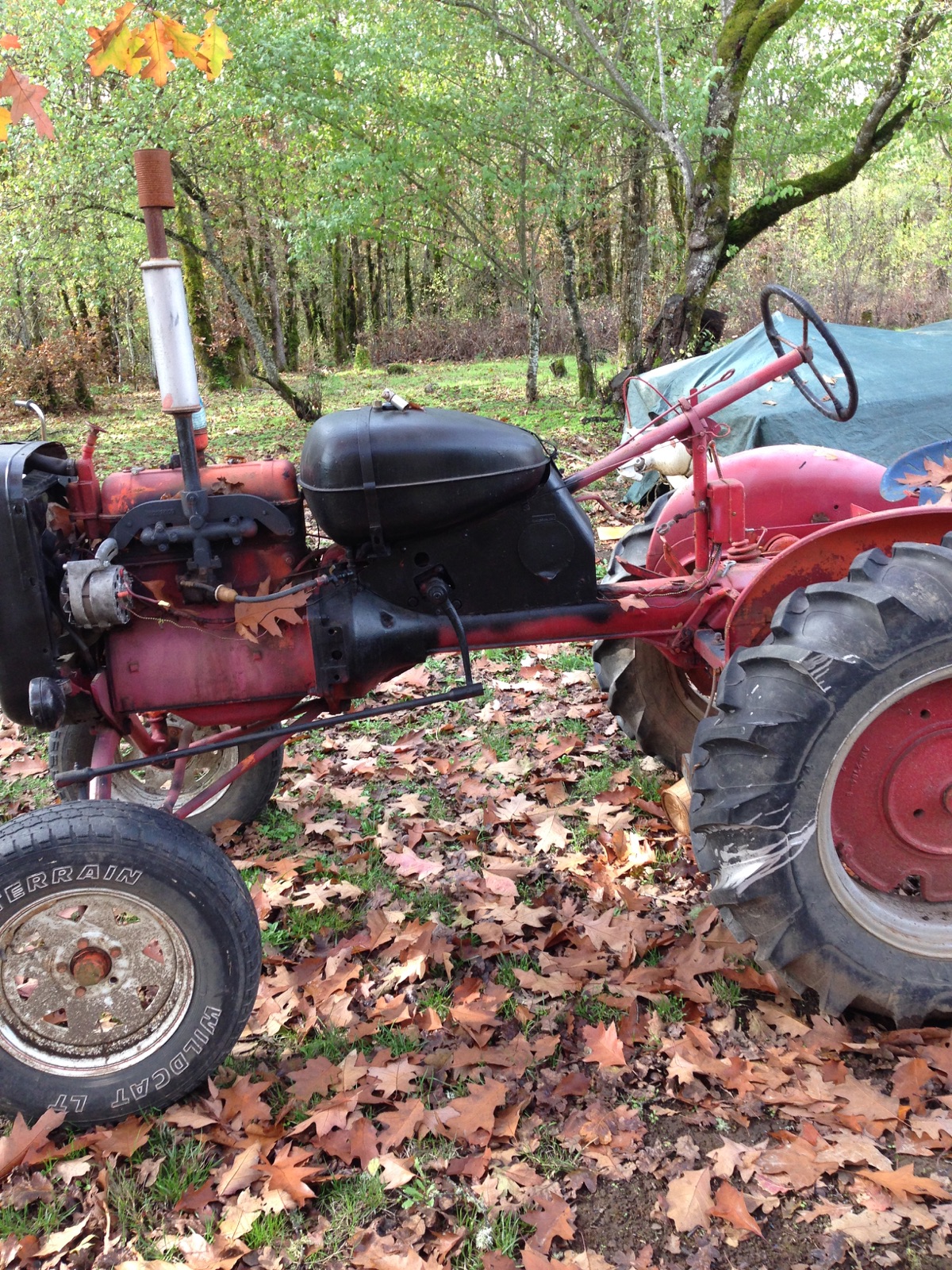

I believe its a 1940s AC model B but im not positive its a 3 speed 24 tires and i dont believe it has a frame around engine.Here are some numbers ive pulled off it.
Am 2976 13
J or n 25 z
am3208 2
am 2787 18 or on other side20
Thanks for the help any one know engine? Year or model?

It's a b their are cereal numbers stamped into transmission. Right in front of the gear shifter

Arched front axle is a B. 3 speed could be a B or a C. That front axle would fit the B, C, and CA.

No problem!  Delighted to be of assistance.  This is my favorite Allis Chalmers Tractor the B.  It has electric and foot brakes.  Therefore it is at least a 1942.
The numbers you have presented are casting numbers and outside of replacing items are of little use.  Look for the serial number to the rear of the shift lever.  Be sure to clean the area so that all the numbers appear.  There is a page of serial numbers on this forum so you can tell the year from there.
There is an engine model number on a flat place on the rear of the engine.  I hope others will chime in with exact location information.
Looks like you have a rather nice looking unit.  You can see that the battery box, hood and seat are missing.  You may want to check behind the differential housing to see if there is a PTO. If so you may see a hydraulic pump located on the right of the PTO facing front.
The tractor does not have a frame around the engine since the engine was the frame.

Yes, you  have a B tractor... the steering gear box and rod are off a B, not a C... Your rear end has B hubs on the axle, not the bolted C hubs. Like mentioned, it is post 1942 due to the electrics.. Does not have bolt boss on the torque tube, so probably pre 1950.

B 56150 would be a late 1941

Nice old B for sure,very unusual to see a set of original fenders that good.

It's got an aftermarket seat on it--possibly a Monroe, rather than the original bench. Makes it a lot easier to get on and off of.  My '39 has the Monroe seat and I wouldn't change it for the bench, even though it's padded!! LOL.
My other two 'B's have the bench seat.

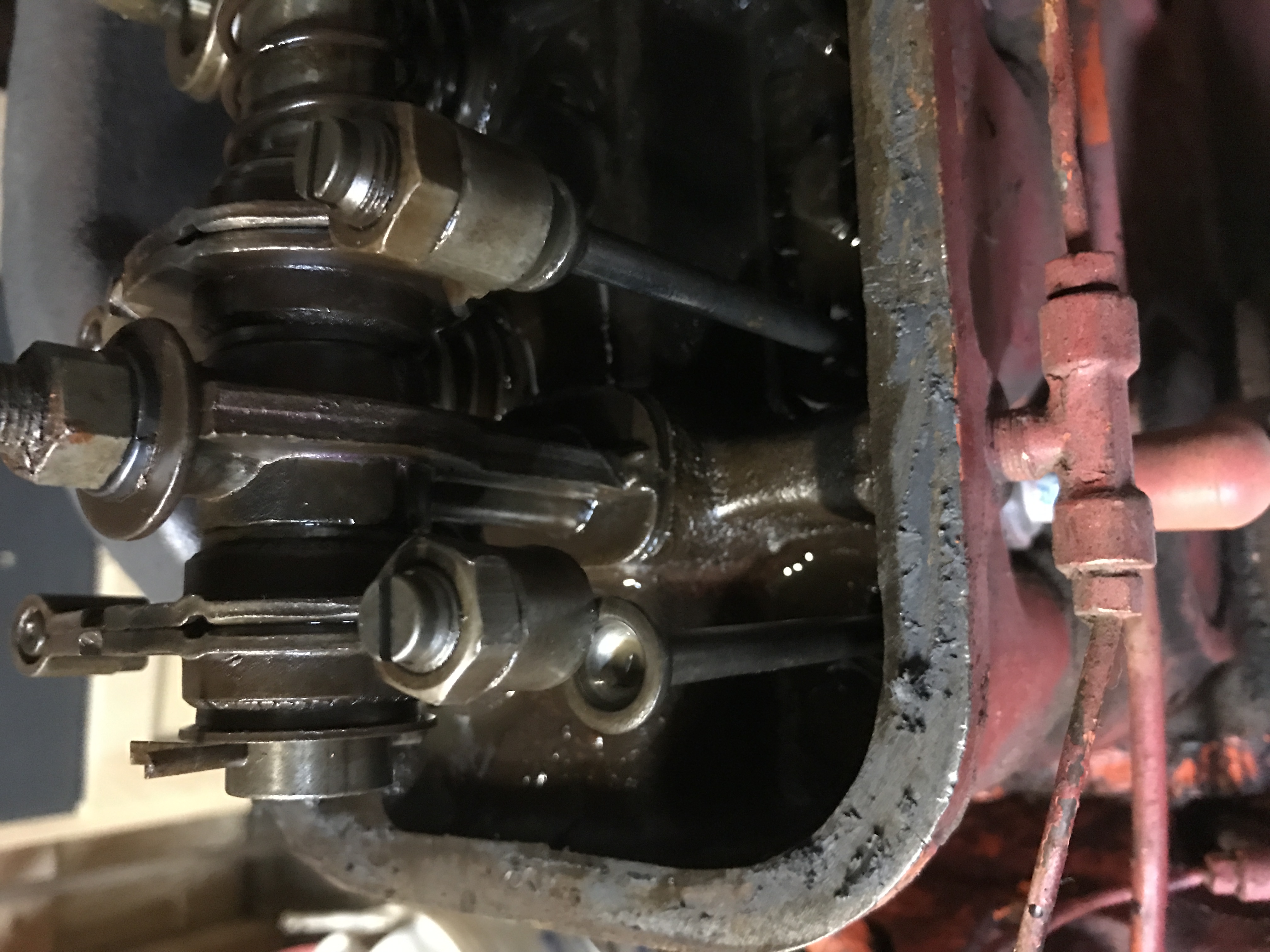

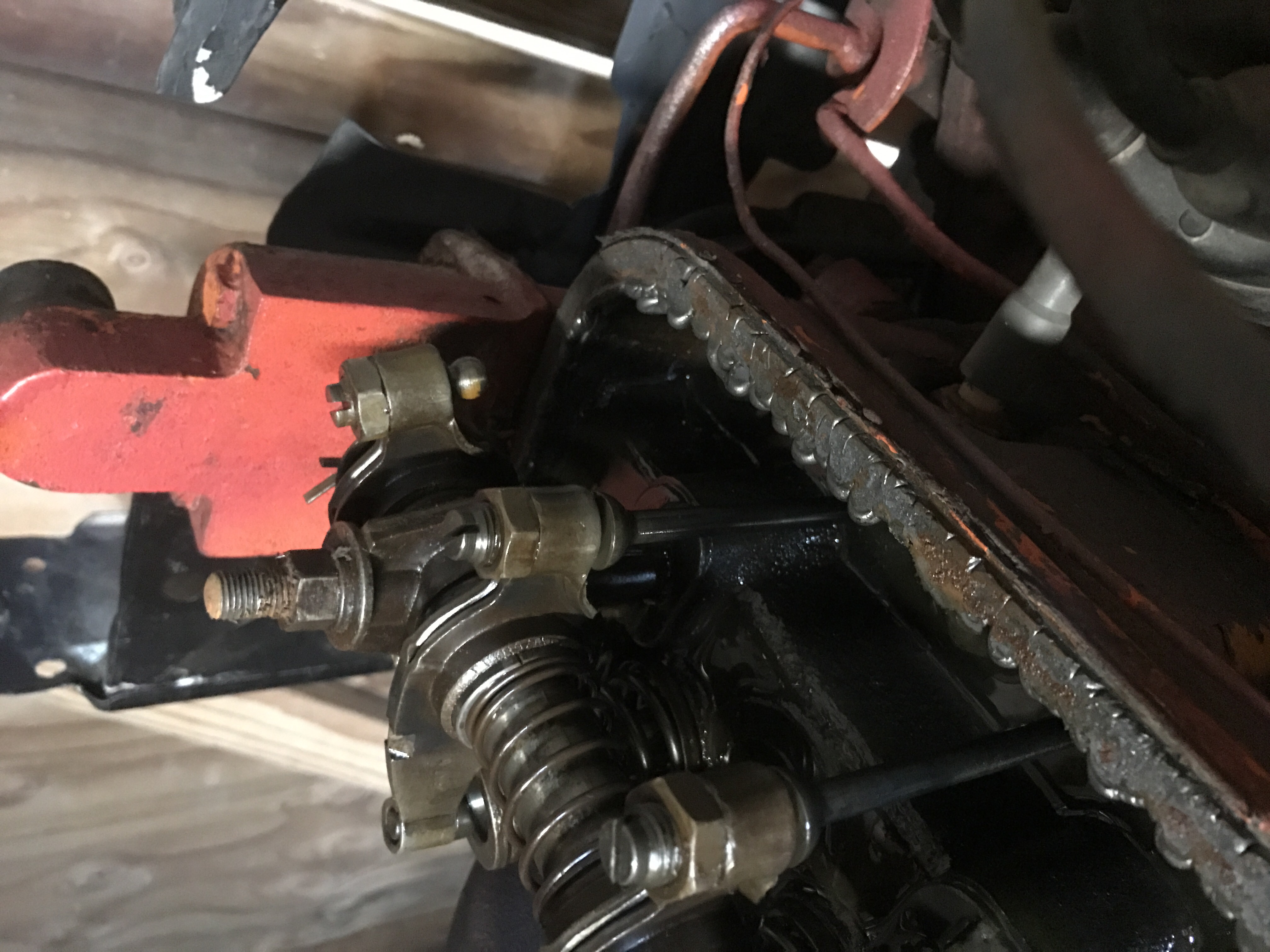

Just cracked open valve cover to discover this

Can't see 'em at that scale, don't have a 5000 pixel wide screen.
