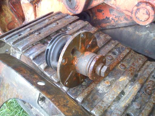

Post Options Post Options   Thanks (0) Thanks(0)   Quote skybum1 Quote  Post ReplyReply Direct Link To This Post Posted: 13 Feb 2012 at 6:19am
Originally posted by gemdozer gemdozer wrote:
I am still have some HD6G water pump
Hector,  Yes I still need a water pump.  Does your pump look like this one?  Can you post picture of yours and way to arrange shipping and payment?
Thanks,
John

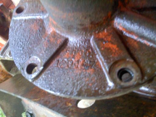

gemdozer View Drop Down
Points: 1074
Post Options Post Options   Thanks (0) Thanks(0)   Quote gemdozer Quote  Post ReplyReply Direct Link To This Post Posted: 13 Feb 2012 at 12:32pm
 I am going to my small shop and get the part number on the water pump and getback to you.
