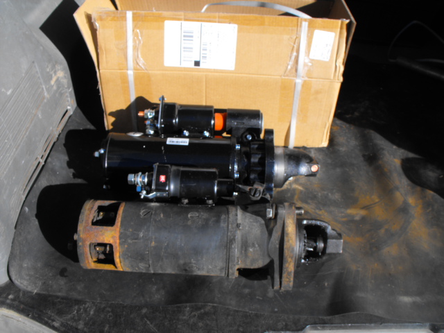

I received my eBay starter motor today. It is a universal starter that fits many pieces of industrial equipment. The eBay post says it fits an Allis Chalmers HD6G. The gear opening on the new starter is on the wrong side indicating it is set up for installation on the left side of the motor. That should not be a problem because the mounting flange can be re-positioned. Looking at the original motor the curved bendix spline indicates CCW rotation looking at the motor from the gear end. The new motor does not have a visible spline. The eBay posting says the unit has CW rotation.
      QUESTIONS:
Do the HD6G and the HD6E have the same rotation?
Am I correct that the HD6E starter rotates CCW?

The eBay starter and the original

The eBay starter motor can be configured to fit over 130 industrial applications. eBay security does not allow telephone communication so I could not resolve the issue of the incorrect rotation. I was told that taking it apart to change the relationship between the armature and the field would void the warranty. I have returned the eBay starter motor. I recommend the eBay type starter motor but you have to purchase it from someone who understands the configuration. Most eBay sellers do NOT understand what they are selling

The HD6 startor 24 volt  is turning  left side and have 2  off them -1 with the shaft twist and wide gear and the second on have a standar shaft and narrow gear

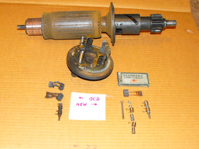

Post Options Post Options   Thanks (0) Thanks(0)   Quote Dozer987 Quote  Post ReplyReply Direct Link To This Post Posted: 08 Nov 2025 at 4:25pm
The starter worked when I purchased my HD6E but would not turn when I finished working on the clutches. I cleaned the starter commutator with sand paper.
The brush springs and brush stands were damaged. I made 2 piece brush stands from 3/8 bolts. I made 2 piece brush stands because it is easier to install the brush springs.
