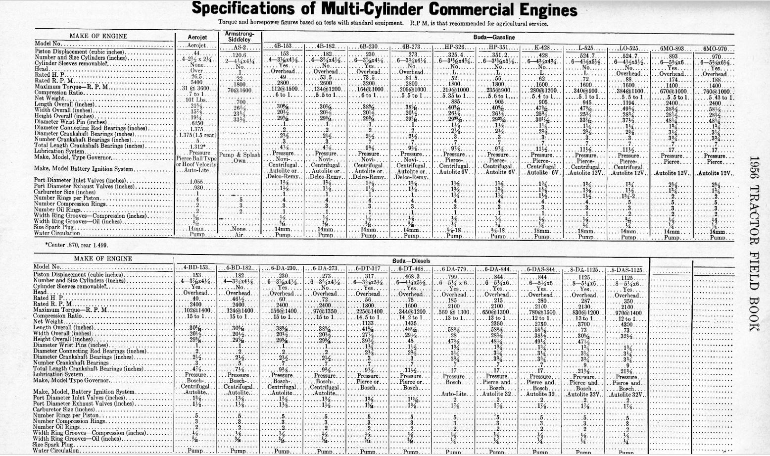

How much HP can a little HD3 handle?
 The Buda D175 was  32 pto HP.  Couldn't seem to find BHP on it
I sure wouldn't want to go beyond that D2200's range 50- hp
Looking in a 1956  'The Tractor Field Book',  under multi cylinder commercial engines section, They listed Buda having 11 different gasoline power units and same number of diesel units  from the 4B-153 gas / 4-BD-153 diesel to the 6MO-970 gas / 8-DAS-1125 diesel.
 Nothing for Allis there, but Allis-Chalmers  were listed under Tractor Engine Power Units specifications and only gas models.  They were powering their construction equipment with Detroit Diesels prior acquisition of Buda.
Here's a scanned image of the Buda specs from 1956.
