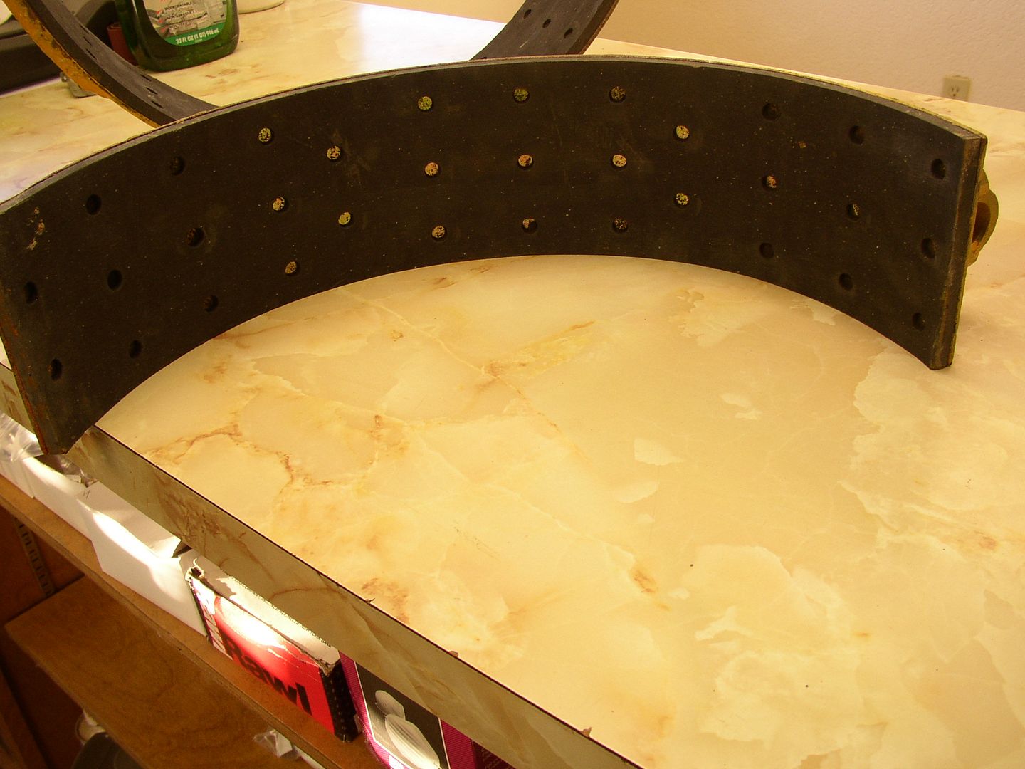

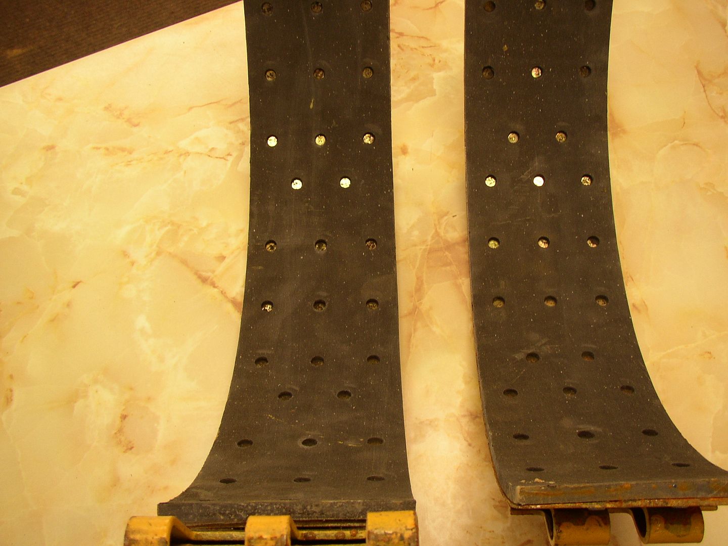

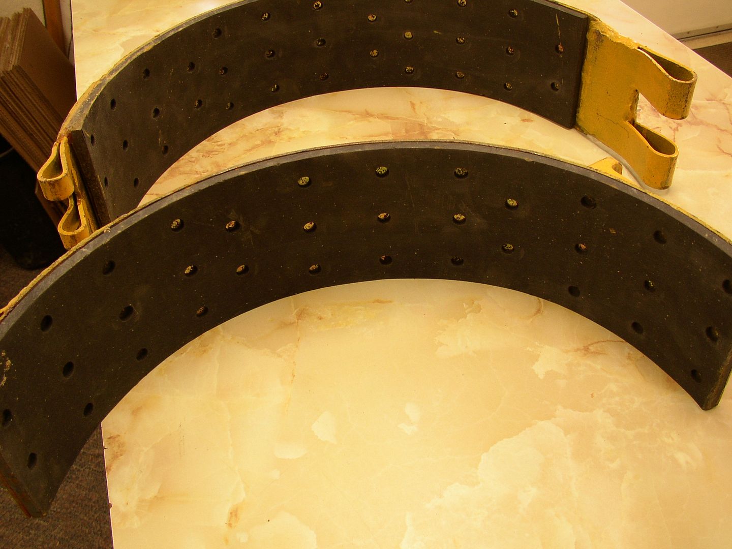

Here are pictures of some HD15/16 brake bands we had relined recently. These are from one of are HD15s. I haven't had time to get them put back in yet. photo P1010028_zpsb7a01d35.jpg
These were done by Capitol Clutch in Sacramento Ca. They had a couple of options. This one being that the lining would be in one piece in stead of the 3 pc segments that were OEM. They had to order in the lining with the right radius and then drill and countersink for the rivets. photo P1010026_zps72c2ce47.jpg
They could apparently do the 3 pc segments but it was more money. Oh, and since I heard someone just say, and the price was? $320.00. Yes, we thought it was pricey, it was convenient for us because they have a salesman that comes through the area once a week. It appears to be a good job and the lining in one piece should not be as apt to come loose as the 3 pcs? (maybe) I'm sure there are other people throughout the country that could do this that might be closer        http://www.capitol-clutch.com
