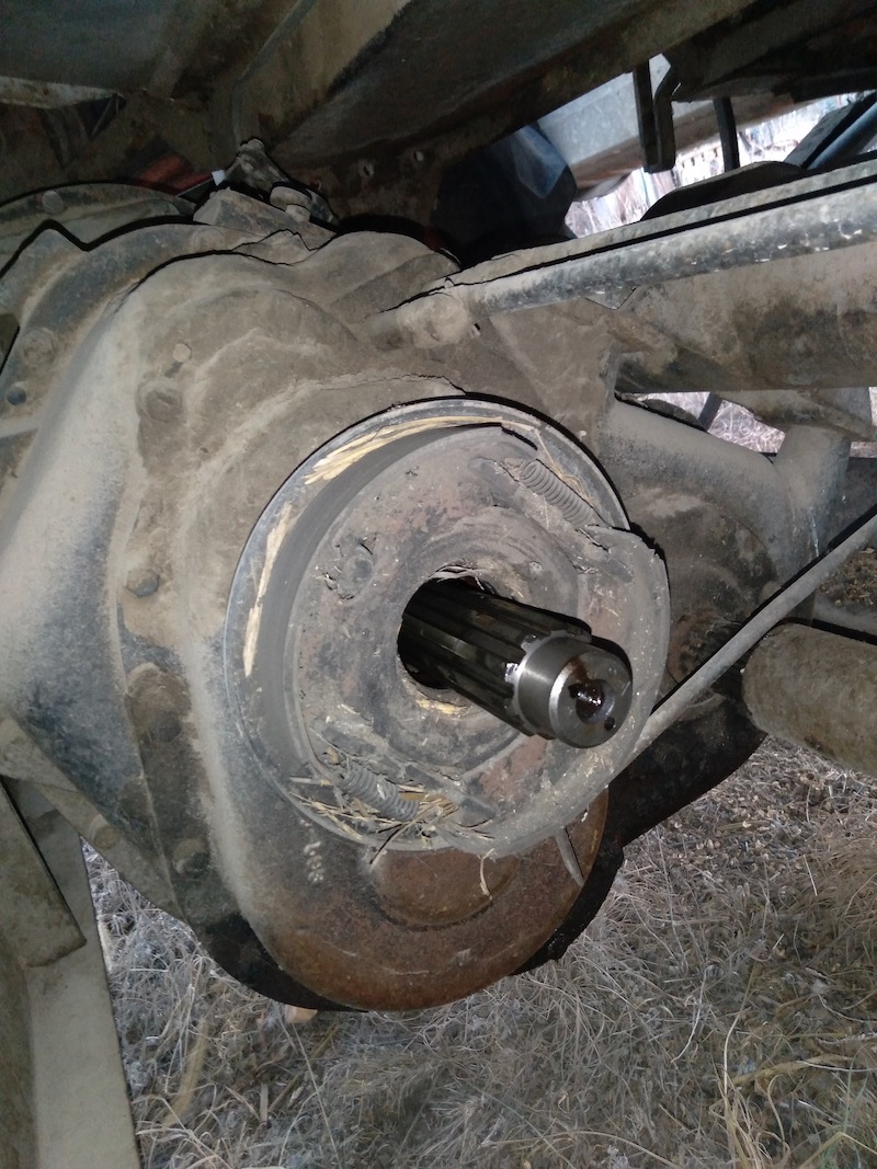

I decided to pull off the steering brake covers today and I'm glad I did. I decided that milo leaves were wrapping around the axle shaft and were just thin enough to get past the felt seal on the axle. Of course the cylinder must have been leaking too.

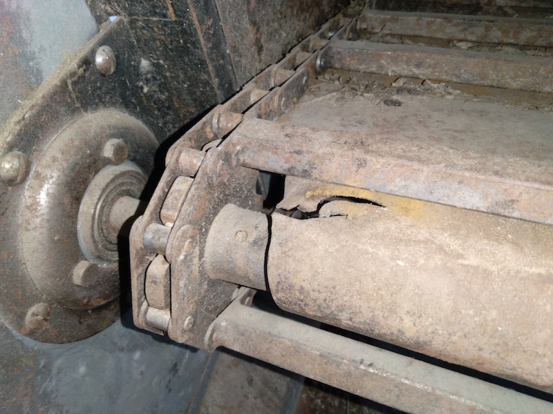

I noticed the false floor of the raddle was torn up in one of the rear corners. I think it was very slightly bent up which allowed the steel slats to ride on it as the wrapped around the drive sprockets. It seems like a good spot for something to catch and tear things up worse on a day when I'm trying to get wheat in, so I'd rather head that off. I debated trying to repair it in the machine but I'm glad I didn't - I would've driven myself nuts trying to weld the paper thin metal inside the combine, and then I found a couple more cracks along the bends for the sides.
I know the book says to pull the false floor out the front but I pulled it out the back since I have the separator beater and straw walkers already out. It seemed easier since the header is still on.

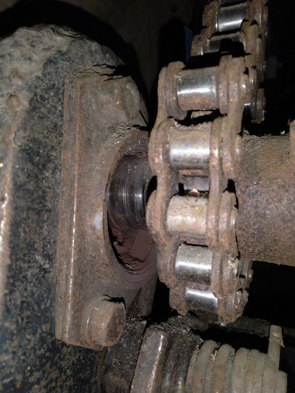

It also looks like the one idler had been locked up for a while even when the machine was still in use by the previous owner, as it's worn down. Thankfully you can still buy these new.

My welding shop rolled new ends and welded them on on both my A2 and F2.

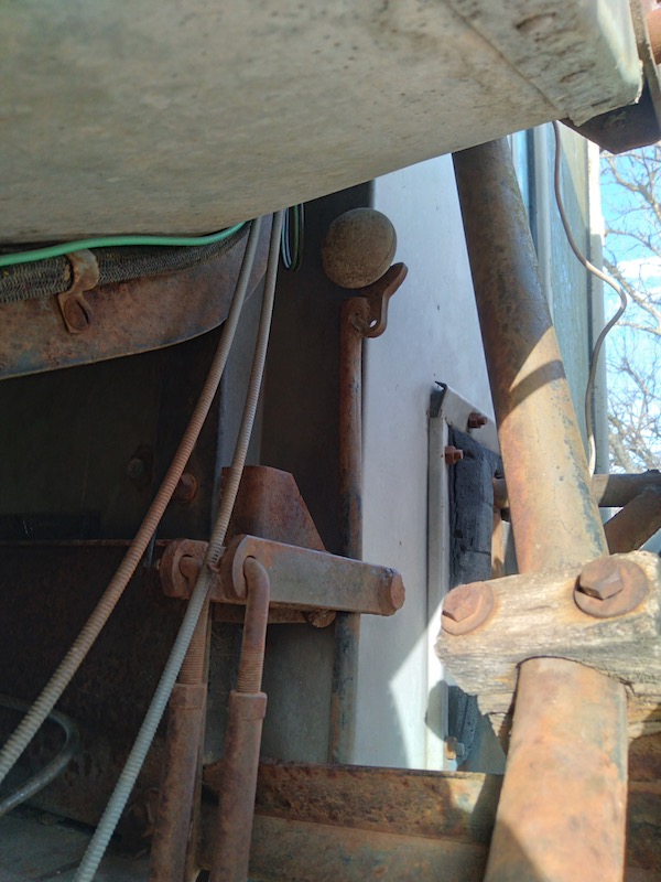

I was pulling things off of the parts combine tonight and noticed an entire linkage and knob that is not on my running combine. I followed it down and it goes into the side of the transmission, and the transmission has a larger extra case bolted onto it compared to my running combine. Is this some sort of high/low gearbox? I couldn't find any mention of it in my Gleaner literature, but this is a later serial number machine so my books might be too old.
Parts combine with larger case and extra shifter knob/linkage setup:
My running combine (no extra shifter and normal-sized gearbox):

wJohn, congratulations on getting your parts gleaner safely transported. It is a 1967 (sn 17201 & up) CII. No factory CII diesels ~ so maybe someone swapped in a D17 262 diesel, 2800 (301) from a 190, or 2800 (301) from newer 1968&up Gleaner F ???
Guessing it has a gear reduction added to its transmission? Gleaner offered a “Slow Speed Transmission” as one of their “options” to base machine. In slow speed trans mode, all gears (1,2,3 &R) speeds would be about 35% slower than “Standard trans in base models” for certain field conditions such as downed/lodged crop, high moisture grain, etc…
