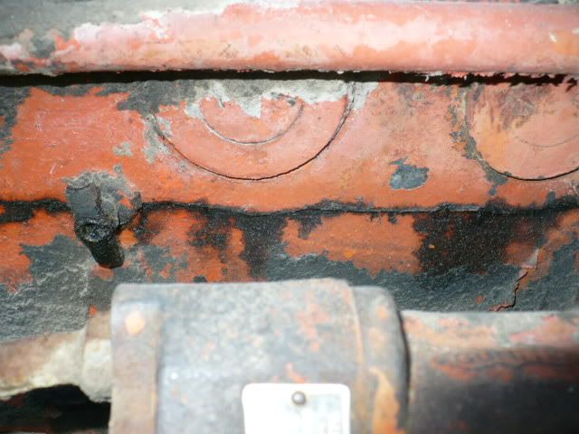

Post Options Post Options   Thanks (0) Thanks(0)   Quote Don(MO) Quote  Post ReplyReply Direct Link To This Post Posted: 17 Jul 2012 at 7:46pm
Here is the right side of the block.

Post Options Post Options   Thanks (0) Thanks(0)   Quote dave63 Quote  Post ReplyReply Direct Link To This Post Posted: 17 Jul 2012 at 8:38pm
It ran when i parked it!! LOL

Post Options Post Options   Thanks (0) Thanks(0)   Quote jnicol6600 Quote  Post ReplyReply Direct Link To This Post Posted: 17 Jul 2012 at 9:02pm
Looks Like some grinding and jb weld should be good to goWink

Post Options Post Options   Thanks (0) Thanks(0)   Quote Richard Quote  Post ReplyReply Direct Link To This Post Posted: 17 Jul 2012 at 9:04pm
I'll bet he knows.  Pretty hard to not see a crack like that.
