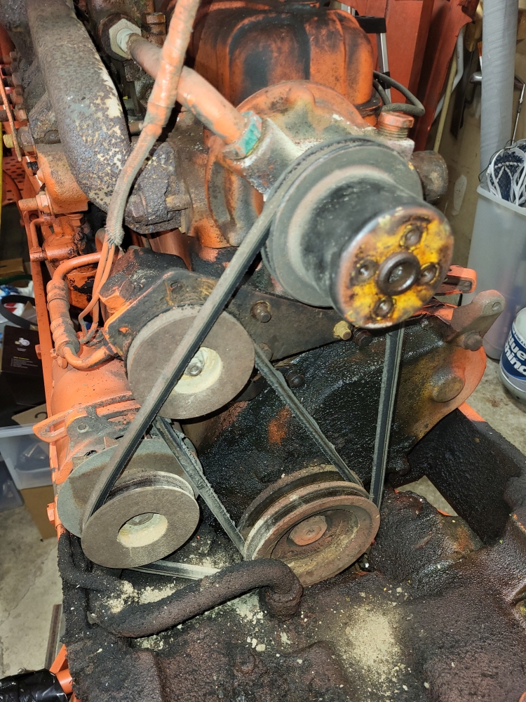

Post Options Post Options   Thanks (0) Thanks(0)   Quote PoppaBear Quote  Post ReplyReply Direct Link To This Post Posted: 12 hours 32 minutes ago at 11:02am
Update: About to remove the Water Pump.
Removed the radiator, and need advice on the Power Steering Pump bracket.
Looks like I need to remove the P/S pulley, then the pump, to get the bracket off....
Any advice would be greatly appreciated.
Note: This is an Early Gasoline 1963 D-19, S/N 13101.
