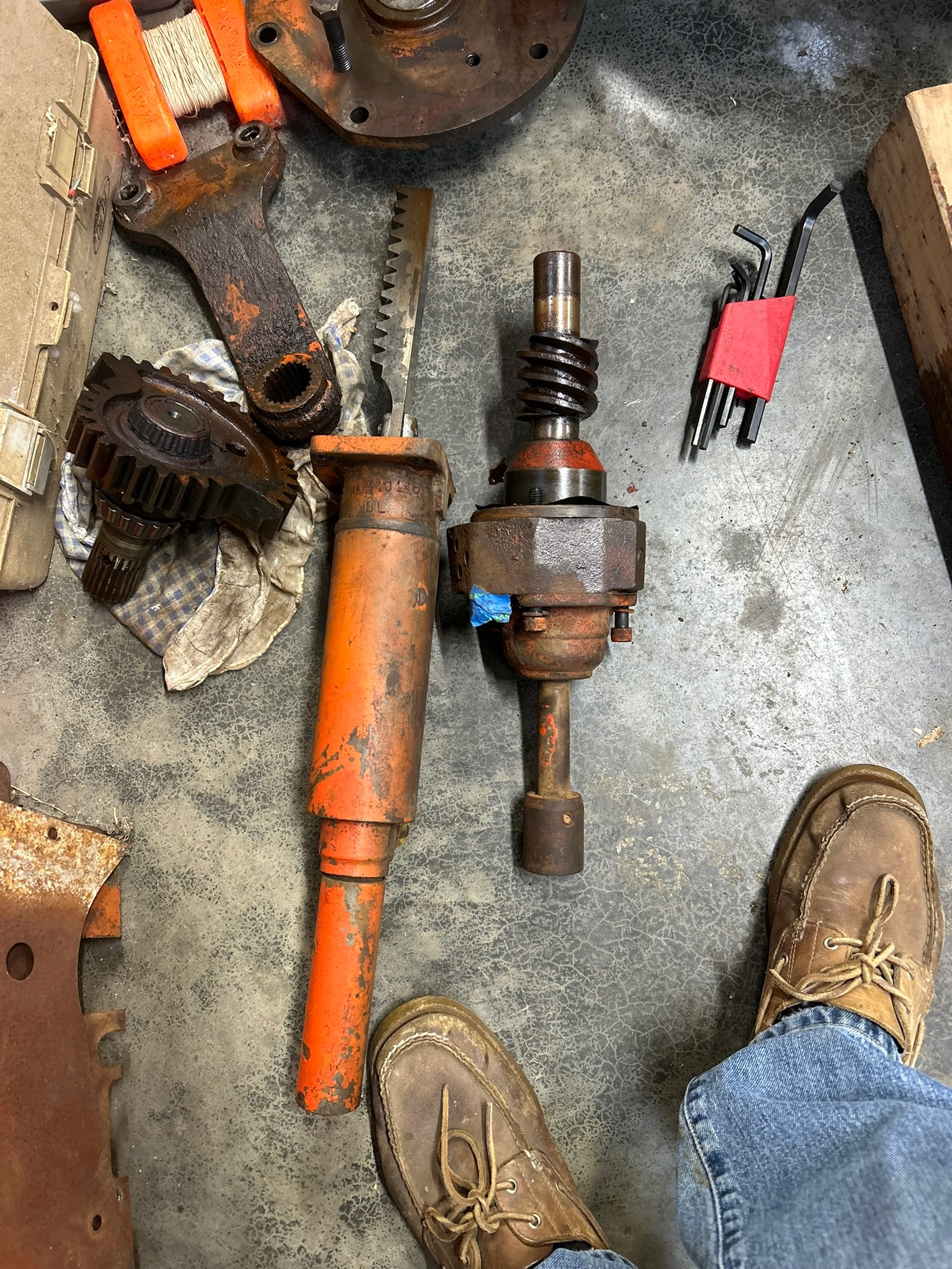

Post Options Post Options   Thanks (0) Thanks(0)   Quote AC720Man Quote  Post ReplyReply Direct Link To This Post Posted: 29 Dec 2024 at 9:59pm
Points: 5232
Post Options Post Options   Thanks (0) Thanks(0)   Quote AC720Man Quote  Post ReplyReply Direct Link To This Post Posted: 29 Dec 2024 at 10:04pm
The steering shaft sector that I am referring to is on the left. Both bearings are damaged due to water in the front support. Bearing cup in the front support and the other bearing cup in the shaft retainer. Those shims provide the proper clearance for both bearings.
Edited by AC720Man - 29 Dec 2024 at 10:05pm
