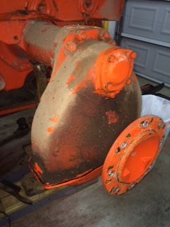

This is a tractor I just purchase and going through it for the first time. I just took the pan off the left side final drive and cleaned it, put a new rubber/cork gasket on it and put new fluid in. (had about 3 or 4 cups worth when I took it down.
Is this a good time to check anything else in this area while I have the tire off and jacked up like the rear bearings or anything? I took the small plate off with 4 bolts and saw that rear bearing but I guess I can't do much from there.. it looks like to really access them you have to take the 8 bolts off that hold the final drive unit on....
These bearings get lubed by the final drive fluid I just put in?

If the stub axle don't have any in play, put it togather and forget it. It has ran 55 plus years and should run another 55.   MACK
