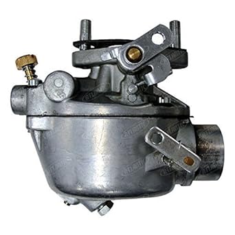

I have a question about one of the floats in my carburetor was bent when I disassembled it (not the arms that hold the floats but the actual float is bent in, in other words it does not look the same as the other side and I'm wondering how do I check the floats to make sure they're not damaged or allowing gas to get inside of them?
Post Options Post Options   Thanks (0) Thanks(0)   Quote CTuckerNWIL Quote  Post ReplyReply Direct Link To This Post Posted: 27 Mar 2020 at 7:43am
  Been a long time since had mine apart but I thought it had the tube behind that external power screw...like a Briggs &Stratton.
 It does have a 'tube' behind the 'external power screw' but that screw is on the bottom front of the bowl, not the top, and doesn't interfere with splitting the carb in half.
 If the power adjust needle is on top, the needle goes way down into the bottom and has to be removed to split it.
 Pic 1 below. The TSX B has the power metering screw on top and has to be removed first. Pic 2 The TSX C has the power metering screw on the bottom and does not have to be removed for disassembly.
Amazon.com: Ferguson To20 Te20 To30 Replacement Tractor Carb ...
NAA carburetor adjustment - Yesterdays Tractors
