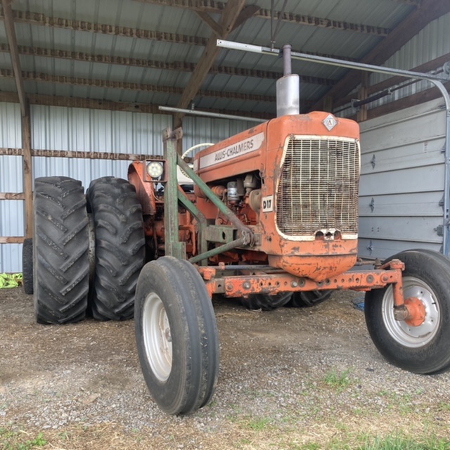

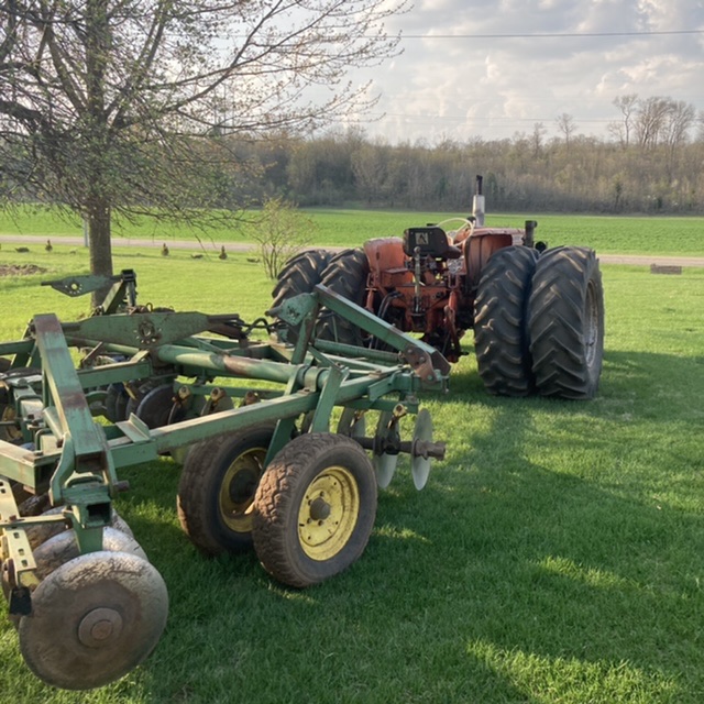

Picked up a set of duals for my D17 (cheap), looked online to try to find pictures and really couldn’t find many. Figured someone might want to see them, I don’t really need them but I think they look pretty bad azz!

You won't believe what a difference it makes in plowed ground discing.  The disc even works better !!!

In plowed ground your tractor won't leave nearly so deep tire tracks. You'll see a big improvement in how the disced ground looks. They will cause wear on brakes unless you make a wider turn,
 We had duals for our 180, silly me got rid of them when I quit using it on a disc. Now wish had them back. They were 18.4x28".

That looks pretty sweet.

That not only looks awesome no doubt your traction really improved.

I like the 10” spacers on the wd-45, I like the look of an open platform tractor with duals. I have 300lbs of wheel weights on each side rear plus fluid. The duals do make a big difference in ride and as far as “lugging” power.

To Travis , your D17 with duals is EXACTLY what we ran in the early '70's minus the loader arms (they were on the WD), brings back GREAT memories from my childhood Big smile !!

Once you find a D17 it shouldn’t be too hard to find a set of duals for it. I paid $100 for the the ones on mine, they’re not great and look better in the pictures but hey they’re duals and don’t need to be in pristine condition for the little work I use them for.
