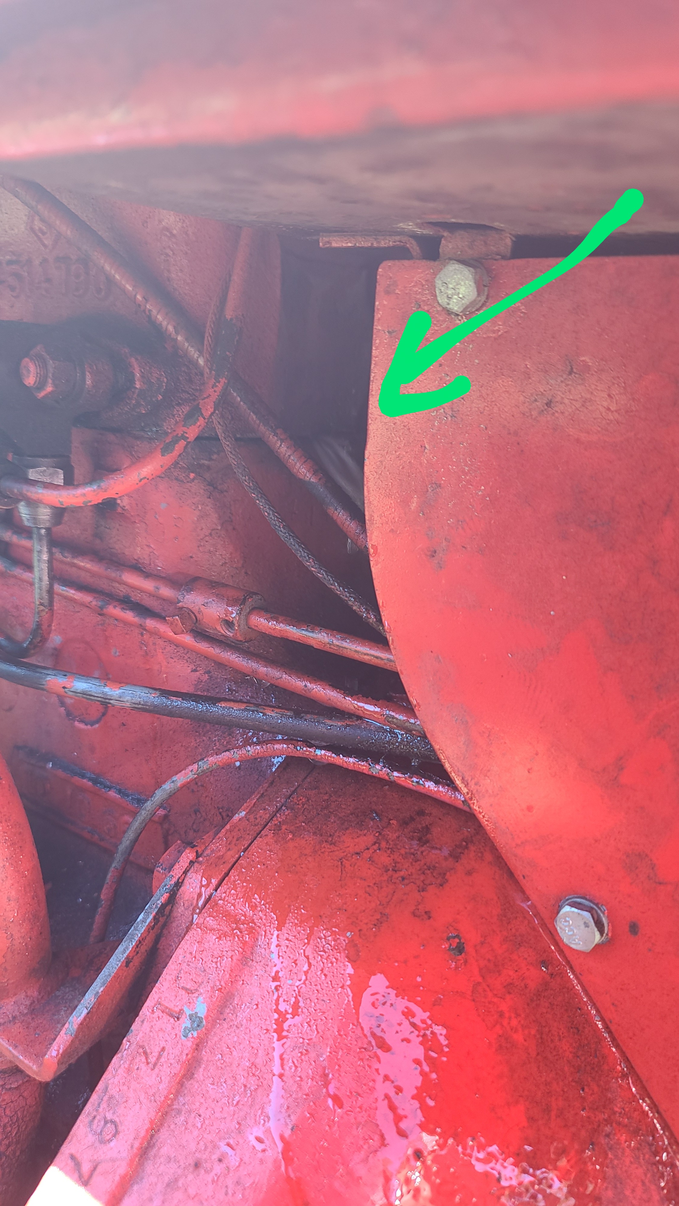

Well I finally got the pump rebuilt and reinstalled, bled the system and got it running for about 5 min before the head gasket started spewing coolant. Talking to an old timer neighbor I am pretty sure it's because of the timing I screwed up taking the pump off. Does that sound likely?   It was running really strong when I got it running. Anyone have any good resources or advice for changing a head gasket and fixing the timing? I didn't know what I was doing taking the pump off and didn't set the timing marks.

For reference water was spraying out here.

What year is it? Mine is a ‘59. Timing the pump is very easy when removing the pump. There is a timing pin screwed into the flywheel housing right behind the frame rail on the same side as the pump. Remove the pin with a wrench, flip it around and place the pin in the same hole. As you place the pin in the hole against the flywheel have someone rotate the engine clockwise with a socket on the front crankshaft bolt. When the pin slips into the hole in the flywheel it is timed. To verify, remove the timing window on the pump. The timing lines will be lined up. Do not rotate engine or the pump once pump is pulled. When reinstalling, the pump should be timed when you get it back from the pump shop. If they are slightly off once it is installed, rotate the pump to correct and tighten the mounting bolts.

Thanks for the reply. It was Running good before the pump had issues, the return was getting clogged from some things breaking down internally and folks on here said it was the pump. Unfortunately I didn't read up on things before pulling the pump and never timed it, so I just never turned the tractor over, lined the pump up with the flat side of the shaft and the dot and hoped for the best. That didn't really work out lol. Can I fix the timing now? It's a 1967 I think, when I looked it up it was series IV diesel.

probley wasnt fireing all the cylinders good before the pump was done and now their is good combustion preasures  and the head gasket was allready tired

DB-series injection pump remove/install is not hard, provided you did NOT remove the pumps drive shaft from the engine !! There is really no need to even check or set the timing if the engine has run for years and ran just fine. You orientated the "dot-to-dot" on the drive shaft and the socket inside the pump?? Then all you have left to do is look at the two nuts and their washers that hold the pump to the engines front plate. The holes on the pump are slotted, to be able to change pump timing a few degrees either way. The nuts and washers leave a mark on the pumps slotted holes. Put it back where it was and you are timed where it was before, which is usually pretty close to center on the slots. The fact that you had it running indicates the timing is probably very close, as they are NOT a great cold starting engine. A leaky head gasket on one of those engines?? Take notes when you make the repair. You might get to do it again down the road. Your biggest concern on the pumps install is keep a close eye on the engine oil level and make sure it stays where it belongs. If you gain engine oil you have rolled over the first umbrella seal on the pump drive shaft.

The 856 won't have umbrella seals, it's seals are in the drive adapter. When I do those I have the customer send the drive to me also so I can reseal it also. Also, when I rebuild a pump that has cup seals, I offer to loan out my tweezer tool that aids in compressing the seal. I really like the oring idea from Doc! That guy has all kinds of great little tricks. The D17 in the op, very likely had head gasket issues to begin with, doubt you could get it far enough out of time that it would run ok, but blow the gasket, with no load.

IMO the 2 gauges on an engine that need to work on a tractor is the oil pressure gauge and the temperature gauge, especially on a Buda diesel. They do not far well if you allow them to overheat. Pull the head and have it checked for cracks and warping. Buy a quality head gasket, not a cheap one or you will be doing it all over again. Sleeves have been known to sink in these engines so that needs to be checked as well.

Thanks so much for all the replies, any recommendations on quality brands for head gaskets? I did as directed above and left the shaft for the pump in then lined up the dots and centered it back on marks where the nuts were. So it sounds like the timing wasn't really off, it was running really smooth for the 5 min or so it ran. Should I do something to check the timing, or is it probably good to go?
Points: 21746
Post Options Post Options   Thanks (0) Thanks(0)   Quote DrAllis Quote  Post ReplyReply Direct Link To This Post Posted: 28 Dec 2024 at 9:01pm
It's fine.
