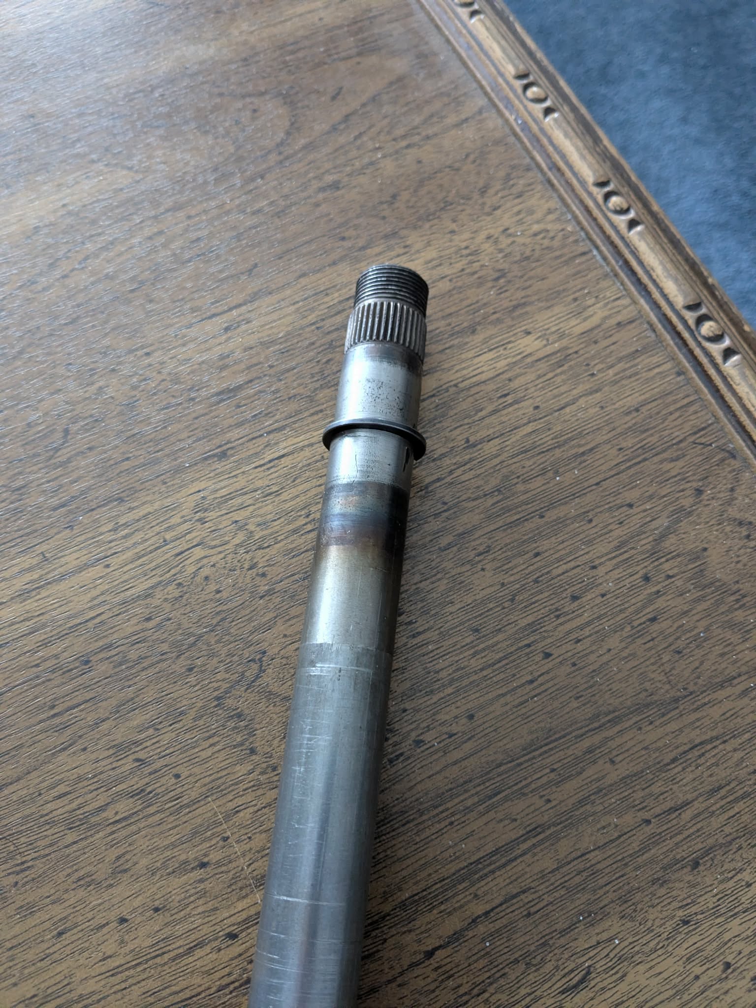

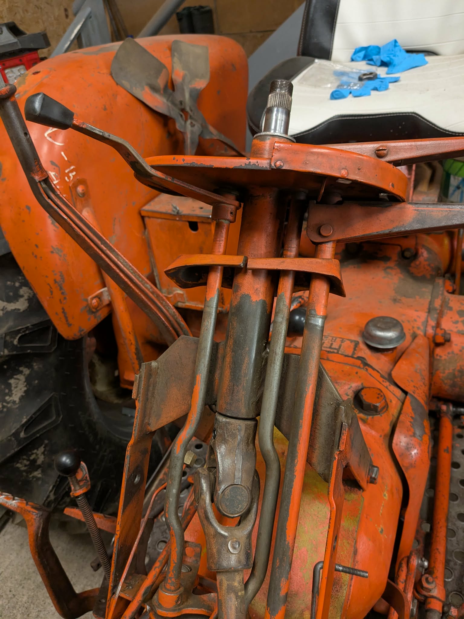

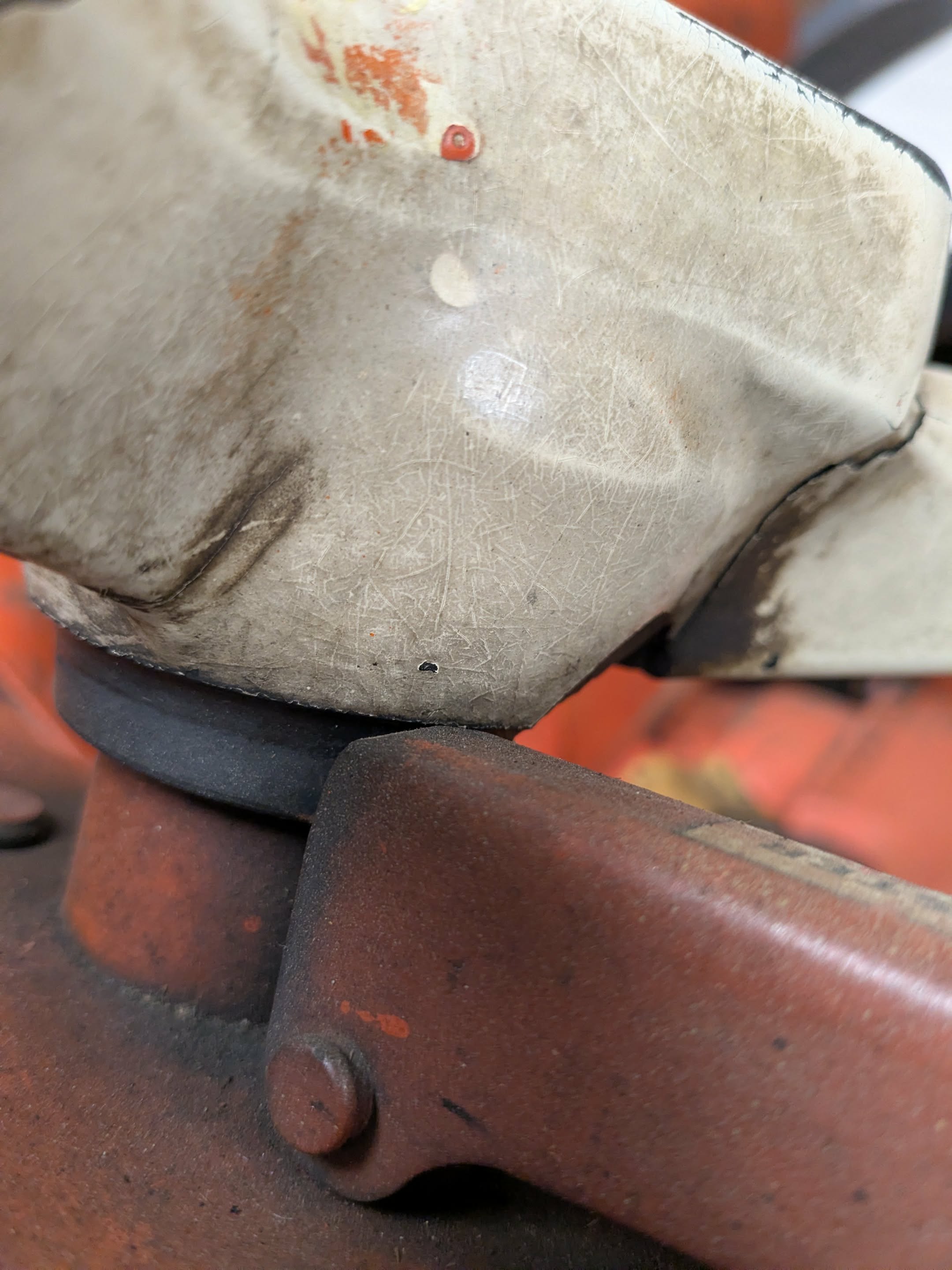

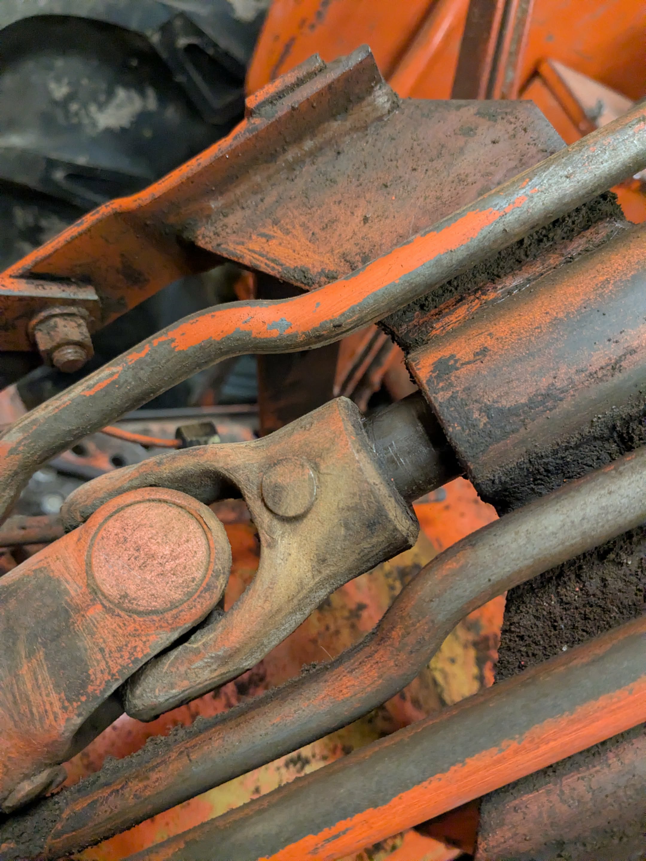

What is the best way to separate the U joint from the upper steering shaft.  I am assuming it is a solid pin that is pressed in.  Am I correct?  You can also tell that the steering shaft has slid down a lot.  I think the snap ring groove has worn out so the snap ring no longer stays in place.  Any way to fix it aside from getting a better shaft?

Grind off the pin on one side so it will drive out using the proper sized punch and a 3 lb hammer while someone else holds the steering wheel from turning. Turn the steering wheel hard until the Ujoint lets it spin free while pulling up on it. Find a stack of machine washers to create the distance you want and place them inside the bottom of the steering wheel. Grease/oil the shaft while reinstalling. Use a 3/8" bolt and lock nut to replace the Ujoints pin of the exact length. You are fixed. You want a new shaft and snap ring?? This is a better permanent fix.

Problem solved.  Had my local fab shop weld up the shaft around the snap ring groove and cut a new groove.  Snap ring fits good and tight now.  The old snap ring was actually sitting 1/2" higher on the shaft when I removed the steering wheel.
