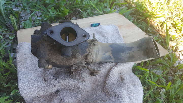

Good news! Sound like it is in good hands. Wanted to mention that that carb looked brand new! Hope the clutch system gets fixed soon. Will be watching!
Yes, Monty did a number on the carb. And FWIW, he charged half of what the implement shop did and did 5X the work. Sometimes you get lucky and find a true artist to help you out. I know there are guys on this forum who would have done as well, but I'm not one of them. Nice to find a local guy who could do it for me.
PS: Rumor has it he is equally as good with starters and generators. We may get to find out with the D15 starter, which needs dire attention.

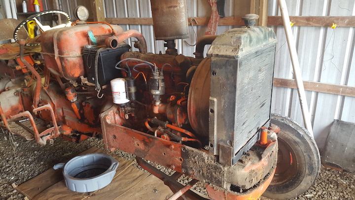

Here she is, stripped down and prepped for surgery.........
She crawled up on a truck and left for town about an hour later. Things appear to be moving fast. Was told the engine would be out and all would be revealed late tomorrow morning.
Alternative theory is that the clutch may be OK. Knowing I pulled about 2 gallons of mouse nests and assorted crud out of the housing, it has been proposed that there remains at least that much crud still in the pressure plate, clutch, throw out bearing, etc. Or that mice could have chewed on the fibers. Hombres if they did.
Since she has a working tach, showing 5,200+ hours, it is also possible she still has her first clutch and it is just flat worn out. Rumor has it they don't last forever. Some longer than others, depending on who is doing the clutching.
