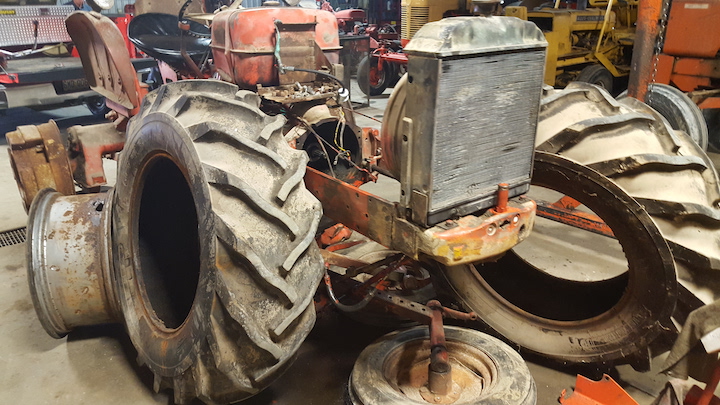

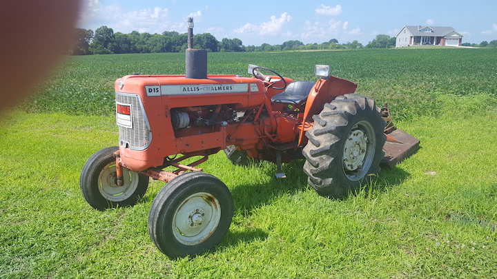

Congrats man those back tires literally have no use on them. Like I said before give me a call if you want me to tell you all what I did with almost the exact same situation except I had to pay 800 which is still a steel

Dads D-15 series II pulling the rake, new paint about 7 years ago. Has been a great tractor since new in 1968.

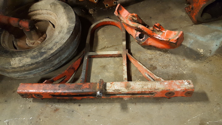

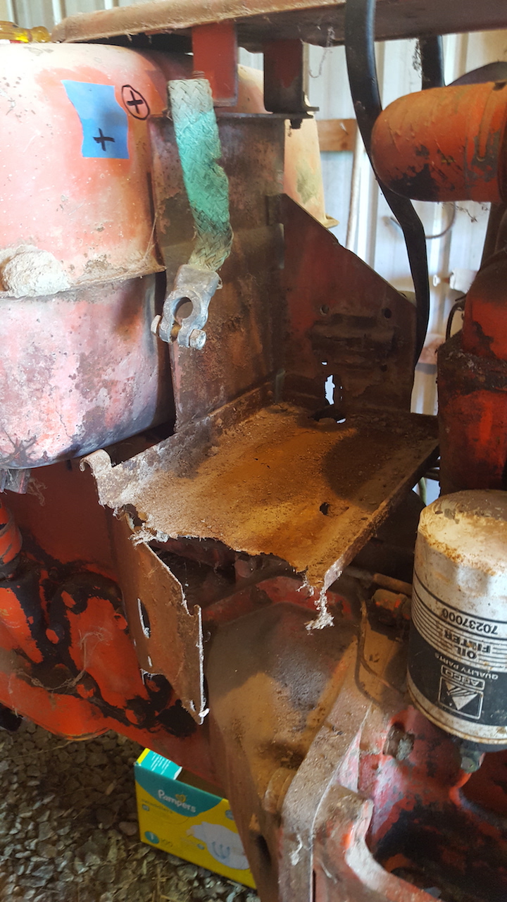

Modirt, congrats on your find you'll love the D-15. I see you've the mounting brackets for a cultivator and I believe the rod is part of the cultivator also. Have fun with the old girl.

I suspected the rod may have been for a cultivator. There is a forward projecting bracket mounted to the top of the left side 3 point link. We had something similar on a JD 620, which carried a front mounted cultivator. Except that one used two push/pull rods....one on each side, and they were more like 1.5" pipes. But if this one was used to lift in a pulling motion vs. a push, a single solid rod may have worked.
I was also wondering what those brackets would have been used for and a front mounted cultivator was the only thing I could think of.
My first "car".....was a JD B tractor. I got started on it when I was about 10 or 11. At the time, my interest was in the fact it had an engine and didn't need to be peddled like my bicycle did. It also had a 2 row cultivator and I tried to talk my dad into letting me put it on and use it. He refused, insisting that if I was interested in running a cultivator, I'd get more done with the 4 row, and the 620 had power steering and the B didn't. My guess now is he simply wanted to get out of all the work it would take to mount it up, knowing the glamor of that would wear off in about 10 minutes once I tried to steer the old B by hand. (Known of then as Armstrong Power Steering) Especially with the weight of the cultivator on it.
The D15 was probably big enough to have handled a 4 row cultivator too.

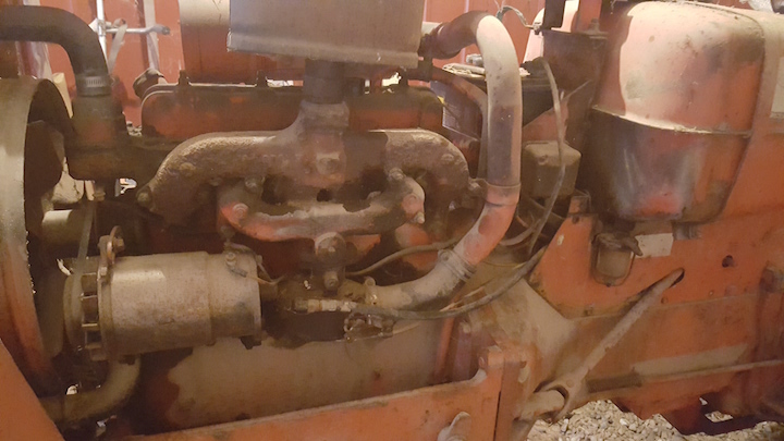

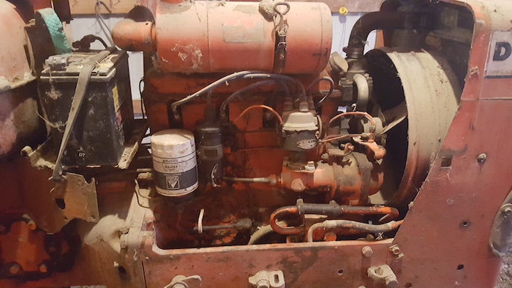

Progress updates:
This is starting to remind me of my first date with a lewd woman. Curiosity running wild as to what I'm likely to discover next.
Hour meter is showing something like 5200 hours. No clue if the tach is working or original.

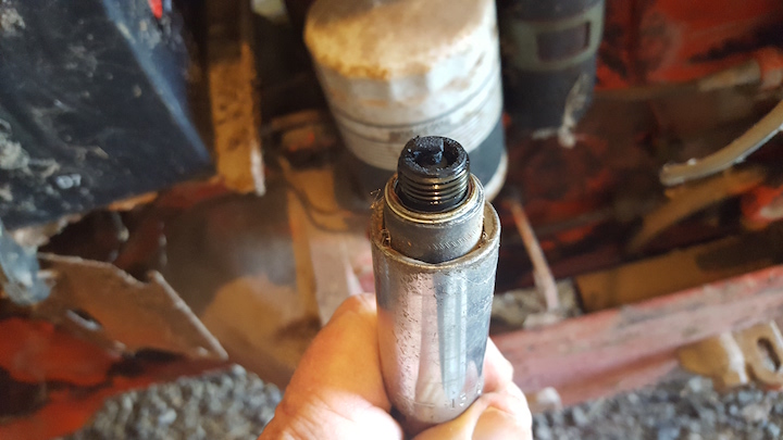

Oil plug is out. Black as midnight but at least all oil. No water.
1 cup ATF in each cylinder.
Plugs a bit black for my taste. Two blacker than the others.
With plugs out, AFT in, and my curiosity getting the better of me, I rocked her a bit in 4th gear and fan blade twitched about 1/4". That was good enough for today.

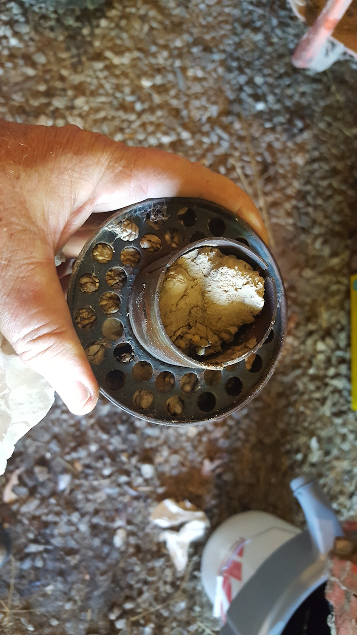

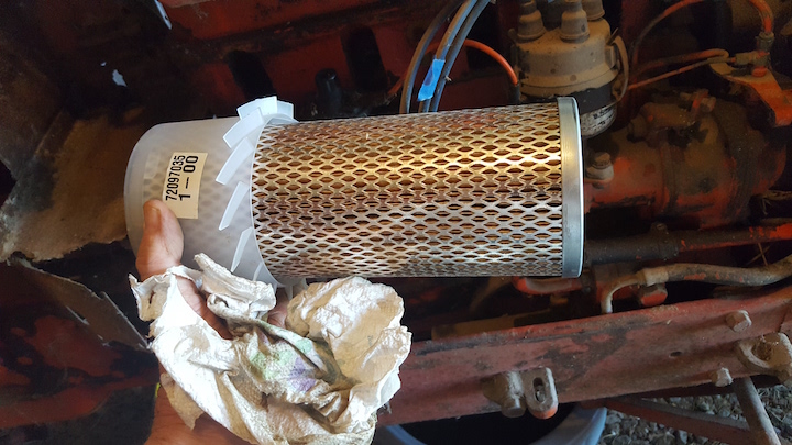

Air filter pulled and looked newer than new. Air breather cap and stack tube full to the gills with mud dauber nests. Shop vac to the rescue. (Secondary benefit to this is I'm on my way to gaining 1/2 acre of accretion dirt from all the mud dauber nests).
Battery pulled and first real clue as to how long she may have been sitting. Battery was marked Sep - 7. Too old to be 2017 and not old enough to be 1997, so that leaves 2007 - 2010 as to about when she was running last. So maybe 10 years vs. 15? Battery box has got the cancer, so has a little life left, but not much. I'd put a new on one if I could find one. Battery was much smaller than the box it was sitting on and in true "make due" fashion, was held down with a tarp strap.
Aft of the engine dip stick, found two more dip sticks. Both had clean....bordering on new.....oil in them, although the one under the seat was barely showing anything on the dip stick, and I remember there was some dark dirt below that area where she had been parked. May have a slow leak.
Gas tank smells as bad as you would expect it to from ancient gas, but no rust. Carb is froze up solid. Time for that to come off for a cleaning / rebuild / kit job. Right now, that is looking like my biggest obstacle to a running engine.
Too much fun!

The pistons have a bowl top. One cup of oil maybe doesn't quite fill the bowl, so you need another cup to flood the rings/sleeves.
Will do. Good thing I bought 2 quarts!!!

Modirt, I think Matt Scott from Jordan make battery tray for  them but I could be wrong I know he made some hold down for them, his # is 612-508-4759.
 If you want to sell them cultivator brackets I may be interested in them or if you would like a cultivator for D-15 I would sell the one  I have because I don't have the brackets.

Added more ATF to the cylinders.......enough it ran out the plug hole of the aft one and I could hear it sloshing around in the others. Hopefully that should do it.
And while I understand what the purpose of the ATF oil is in there, I remain somewhat fuzzy on what becomes of it. On the other hand, the oil drips coming out the drain plug are now the color of the ATF, so given enough time, it may all seep past the rings and out the bottom?

Yeah as long as Stuff Isnt locked up most of it will penetrate in between the cylinder wall the piston... Personally after you get a new battery I would leave the spark plugs off and blow most of that out of there as it seems your engine is free when you crank it over. Then proceed to put your plugs in them put fresh fuel in it and see if you have a running a tractor might smoke for a couple minutes. Before doing that I personally would have just seen if the engine would move in a gentle fashion but to each their own this is fun it’s like I’m reliving my D 15 barn find again!!

I think I'm OK on the rings and pistons. With all the oil in, I jogged the fan a bit and it moved about 1/2" and I could hear stuff sloshing around. Sounded wonderful.
But at the least, she is going to sit where she is until the carb is working.
Next big worries are the starter and generator. Fan belt looked OK.

Luckily with the 12 V system the couple D series tractors I had brought back to life I haven’t had to mess with the generators they charged right away and you might get lucky with the starter!

You need to get it turning over good without spark plugs to blow the oil out because you can't compress all the oil. Whatever is left in there thou will prevent a dry start and help the compression.

You can use a shop vac to remove what oil is left in there.

just clean or replace points. set point gap at .22.  your old condenser will be better than a new one. clean contacts inside dist cap. no need to throw a bunch of parts at it. you can get carb kit and tune up at local parts store as needed.  you should put new plugs in and contrary to what most will say, I use champion plugs in allis with good results. use a J8c. they have changed the number but a J8 is the right heat range especially if it uses some oil.  I have a lot of seat time on a tractor just like yours.  looks like the ground cable will cause trouble too. the breather/dip stick under the seat is important to have enough oil in it.  send me a personal message if you like.  good luck and don't grind the gears. that is the death to those transmissions!
