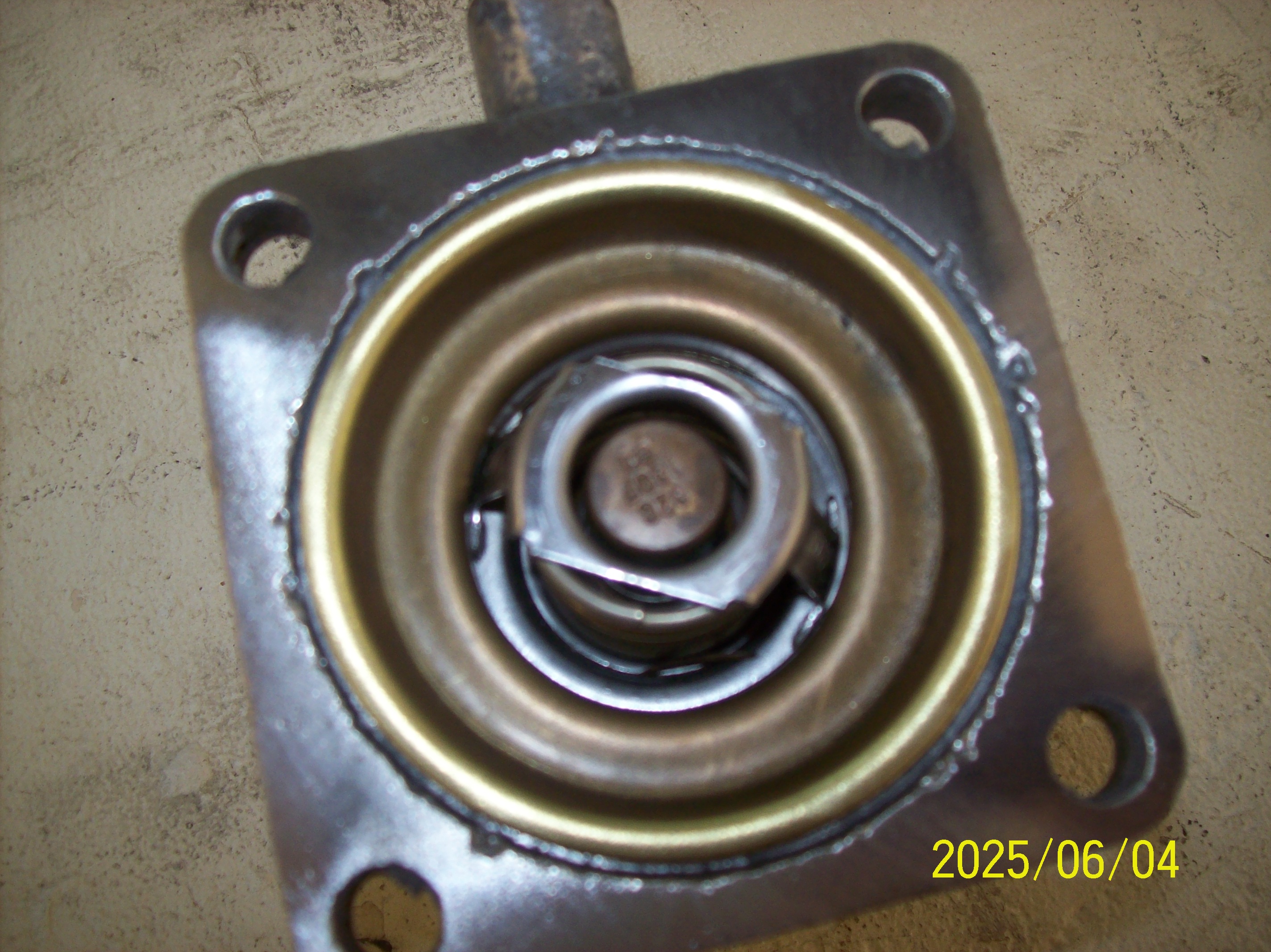

OK. 'Troy' wants to peg the temp gauge so....
1) drain all the 50/50
2) water flush rad ,both ways, comes out strong,no krap
3) water flush engine, both ways,comes out strong, no krap

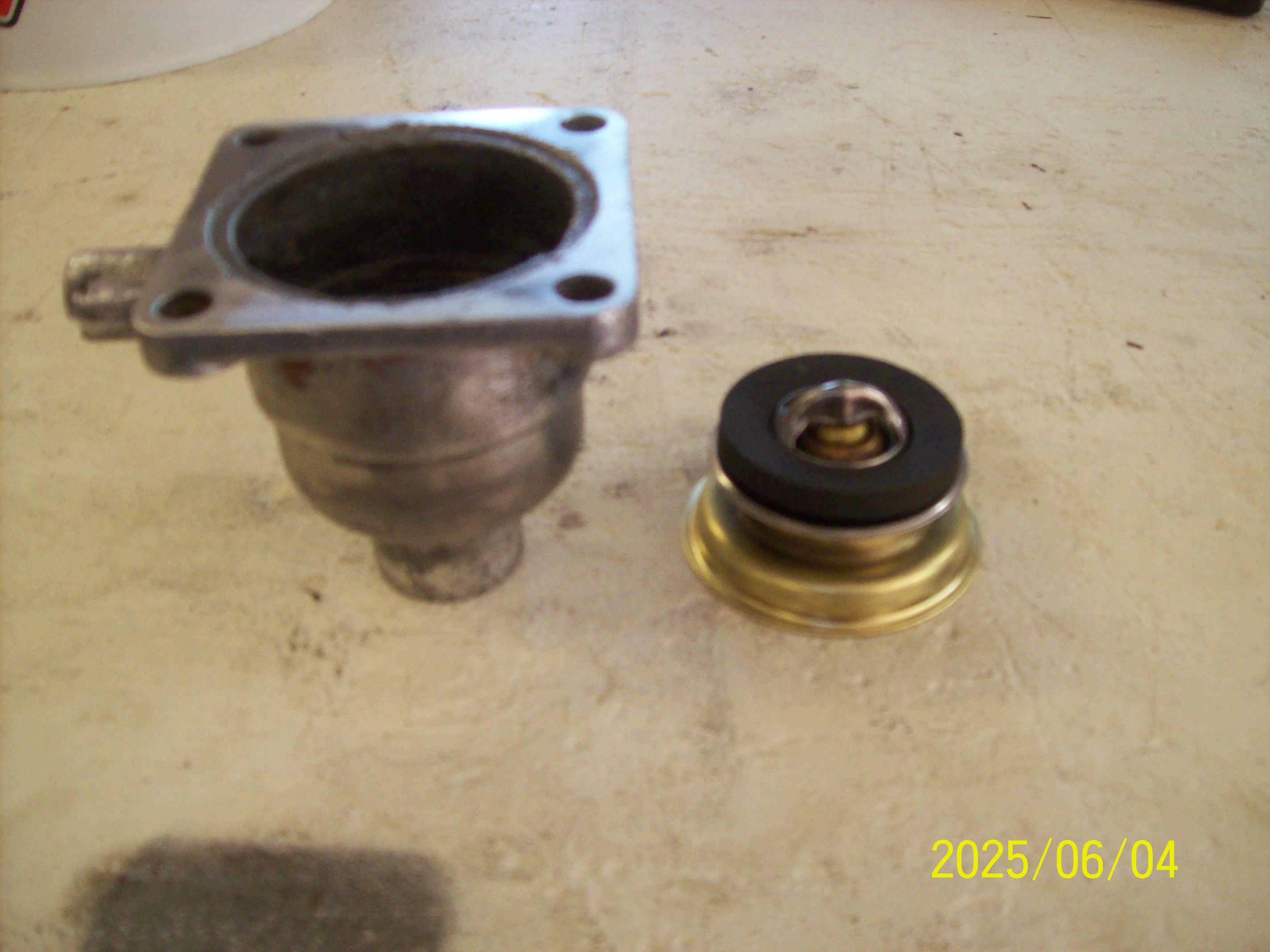

4) buy new stat kit ( rubber ring, stat, brass adapter)
5) install new Vbelt...
fill rad with cool water, eventually rad 'boils over' ,though NOT hot water
IR gun says block by plugs is 120*F, so really not 'overheating',though gauge says 'red'.
Tractor is kinda 'nose down' on the grade,so thinking 'air block' ?
New stat kit...different rubber ring and brass adapter, can't use(brass won't fit into housing) # 228124.
Tomorrow I'll remove the temp sender and fill from there.
ANY ideas,thoughts, guesses are  appreciated. Kinda stymied on this !!!
Sure glad I don't NEED the tractor......
Thanks

Coolant temp sensors for series 2 model D-15's were both ways. The early G-160's were still on top of the cylinder head towards the rear. Only the later model tractors had the sensor moved to directly underneath the thermostat. We had two of them over the years and they were the older style. I myself had a later model one with the brake pedal latching feature and it was under the stat.
