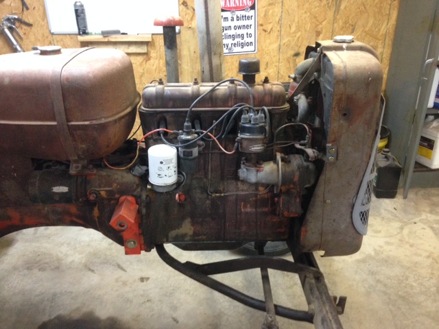

My D12 has been burning oil pretty bad ever since it was givin to me in 2009. It will oil foul no. 3 spark plug every few hours and looks like the blue bandit going across the field. I ran this tractor as a kid and it never had any issues. While I was away in the Army for 8 years it got left outside after being used one day and then sat out without any cover or rain cap for probably 5 years or so until I got it handed down to me. I'm wanting to fix the oil burning but do not want to do a full overhaul. I don't think it needs a full overhaul or even an in-frame. All four cylinders show about 150psi of compression and it sounds great until it fouls that plug and starts missing. Does anyone have any ideas as to what I may find when I pull the cylinder head? I figured it would need a sleeve set but since the compression looks what I think is pretty good I'm wondering if it could be something else. I'm going to mow my field with it one last time this week and then take it apart this week or next. Just looking for ideas. Thanks!

Blue smoke is burnt oil for sure. It is pretty simple really. If you have it narrowed down to one cylinder. It is probably rings or the cylinder sleeve, could be valve guide but doubtful. If you pull the spark plug wire off on the bad cylinder does the smoke clear up? Might get by with rigs or a sleeve. If it were mine, I would do a complete rebuild. JMHO

Thanks for the reply and idea Tracy. I pulled No.3 wire and there was not even a hint of smoke at idle or revved up. If it needs a liner and piston kit I guess doing all 4 cylinders and rods and mains wouldn't be to bad. Any idea if these "TISCO" kits are any good. Was looking at them today on Yesterdays Tractors. Thanks

First off ty for your service to our great nation. Now I really believe you have I bad valve guide on #3 intake valve and here's why I say that. good compression on all 4 cylinders I find it hard to believe the compression rings are good and oil rings bad my thought is the intake valve was open when it set out and rusted when it started the rust created extra clearance lol take the head off have it redone put it on worst thing you do is waste a head gasket maybe you get lucky

I would go with the valve issue as well. I think if you broke a ring or had a scored cylinder you would see low compression in that cylinder.   I am not a fan of doing upper end work without doing the lower end but if you have good compression and the oil flow and pressure is good then I think I would start with the head.

To me the second step would be to include new bearing I get nervous about damaging the crankshaft with bad bearings. I say that because they don't make the crankshaft like the cylinders and rings. Just my two cents.

No 2 and 3 cyls are gonna be where rainwater gets into, if it was left outside,(depends on which valve was open, and slope tractor was sitting at, when outside) I'd pull the head, and take it to a machine shop, and have the valves done, and a pressure check, because its there.  If the head work don't cure it, time to start looking at rings...

  Hey Jeeper,,,some food for thought,,,,since the oil rings do nothing for the compression,,,,it IS very possible that the OIL RINGS on that cylinder  are still froze in the piston lands from setting all that time. It just seems a shame to replace all the other rings and bearings when you may not need to,,,,,,
 The compression readings you are getting on all the cylinders is a dang good indication of  "compression rings" in great shape,,,Just my .02 and Hope this helps you,,,,Clap
Points: 54364
Post Options Post Options   Thanks (0) Thanks(0)   Quote DiyDave Quote  Post ReplyReply Direct Link To This Post Posted: 28 Sep 2016 at 4:59am
Joe, thanks for the reminder. Jeeper, drop a quart of ATF in the oil, next time you get a quart low.  It de-sludges and unsticks things...

Run Seafoam in the Oil for a while. That stuff does wonders for stuck engine items like rings.

Put a can marvel mystry oil in and run it may be a stuck ring. Nothing to loose.

Marvel mystery oil, Seafoam and several others like Z-max would be some to try.
Gumed up oil rings are the first to fail when setting for an extended time. I have had good luck with Seafoam and Z-max. I have not tried the others but they probly would work also. One thing about them all is that you have to work the engine many hours not minutes. It takes time with heat and pressure to slowly dissolve the gummed up oil holding the rings from expanding.  My worst problem with oil fouled plug with my Farmall C took over three years before it quit fouling a plug and stop smoking while working. Longer for it to stop smoking on start upon start up.  I did see it getting longer between a fouled plug the first summer using it to keep a field disked for weed control.  Your tractor sounds a lot like my Farmall C.

At one time I had an example of the stuck oil ring with the compression rings free years back out in the shed. Finding it to take a picture probly will not happen. I am sure I never tossed it but I wouldn't know where to look anymore. Boxes and piles of old parts packed in the shed like the hoarder pictures you see on TV.

Thanks for all the ideas everyone. I plan to do my mowing tonight and take my front blade and brushhog off, clean it good, and teardown very soon. Definitly not gonna go ordering parts until it's apart. Anybody have any good shops around the North Kansas City area to take the cylinder head to? If its a problem with the Valve guides will it be visible to the naked eye? We send most of our cylinder heads at work to Roadbuilders but not to confident that they'll want to work on something this old. Thanks!
  Hey Jeeper,,( I like thet handle,,) I doubt you will be able to see the problem if it is a valve/guide issue,,,as due to the dis-similar metals, the valve guide is the sacrificial item in this case. If there is excess valve to guide wear, you can wiggle the valve in the guide, but only real way is to micrometer measure ID and OD to be sure. I think you got stuck oil rings on that piston,,,,(fingers crossed)

If you pull the manifold off can you see the valve stem from the manifold port for cylinder number 3 if that's what's leaking you probably will have build up on the valve itself correct
