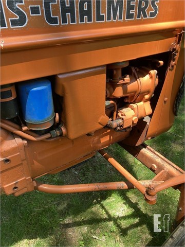

I was looking at a D12 with a hydraulic oil tank between the distributor housing and oil filter. It connects to a pulley driven pump off the crank just under the distributor drive and has lines running to rear of tractor.
Was the setup better/worse than rear pump setups? Redundant? Owner didn't know anything about it. Thanks.
Here is a pic of the setup on another tractor.

That's be a 'live' hydraulic setup..as long as engine is running, you got hydraulics. With the regular setup, push the clutch in you lose hydraulics.

That was used on many of the earlier D10/12 tractors when a "Traction booster" system wasn't needed, just a lift/lower system. Such as when a tractor was to be primarily only used for cultivating. That pump system also was used to power the power assist steering offered as a option on D10/12 tractors.

Picture above is a original engine gear driven pump .Used on early serial # D 10 12 ,Rear pump where used on later models and if used hard for PTO work would rip splines off drive hub and shaft at flywheel and u lose  power to rear of tractor for PTO n Hydraulics
nonetheless ,still dead.
