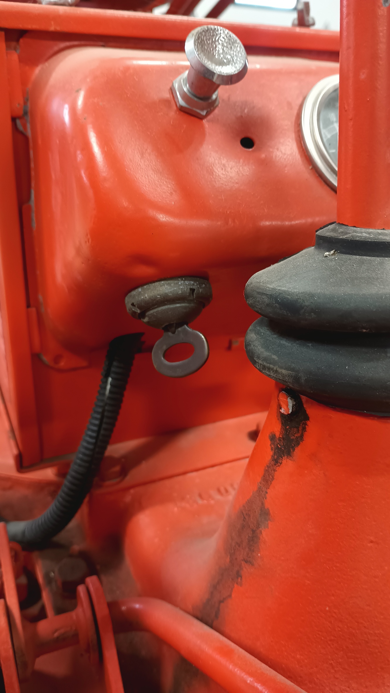

On my WC that I did the same conversion to, I “hid” the solenoid inside the headlight mounting pan under the gas tank. Years ago I converted an Autolite starter for my C and the shop mounted a small cylindrical shaped solenoid right on the starter using the tapped holes that held the original mechanical switch.

Thanks for the pics and ideas

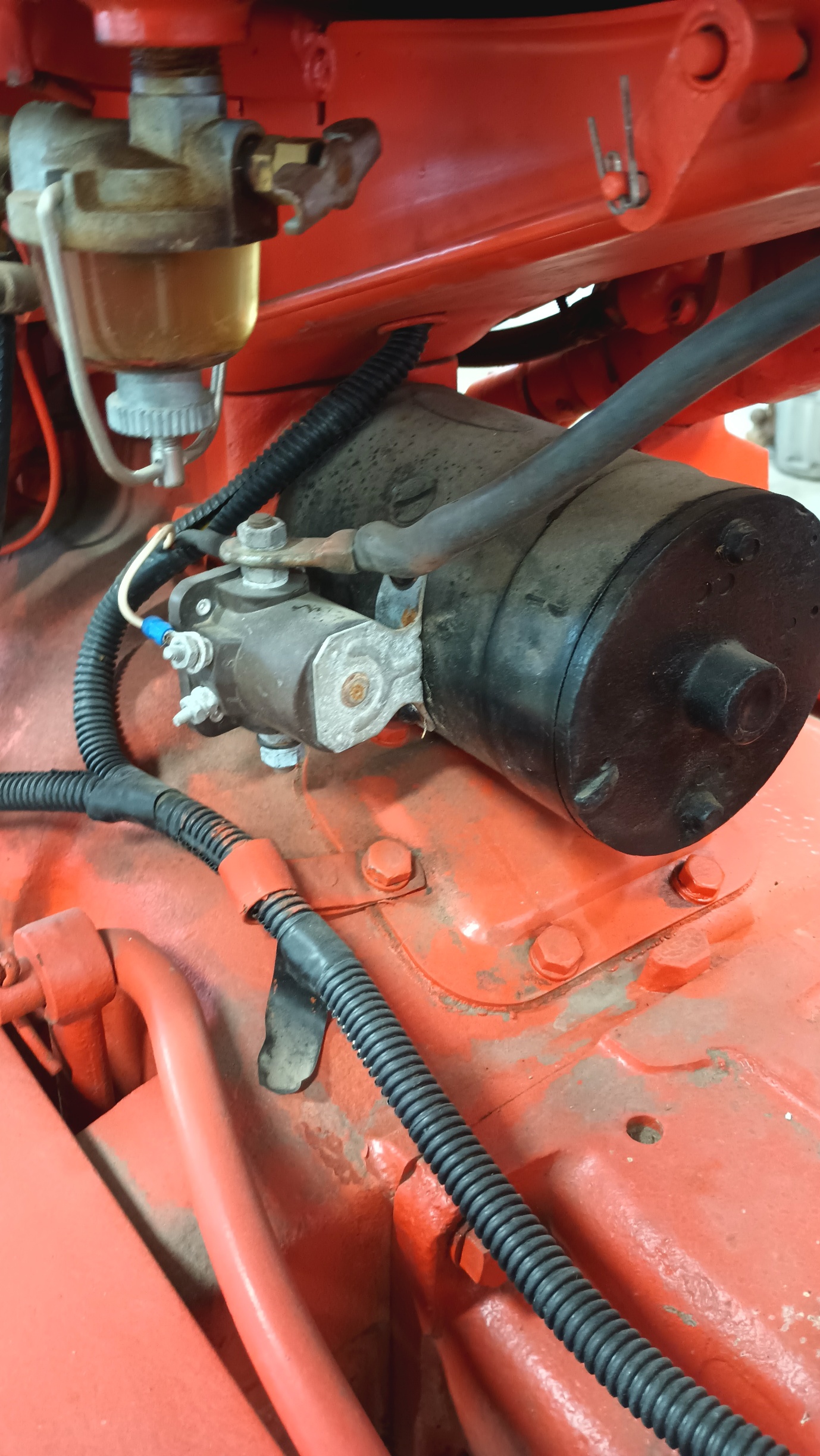

Here's what I did.  Starter solenoid mounted to stater. I had a spare D-17 key switch I used, kinda the same vintage. Very simple and clean. Turn the key to run mode, turn to start and key returns to run mode when released. But any parts store will have a simple start key switch.

I like how you have mounted the solenoid. I will pick up my starter this week.
