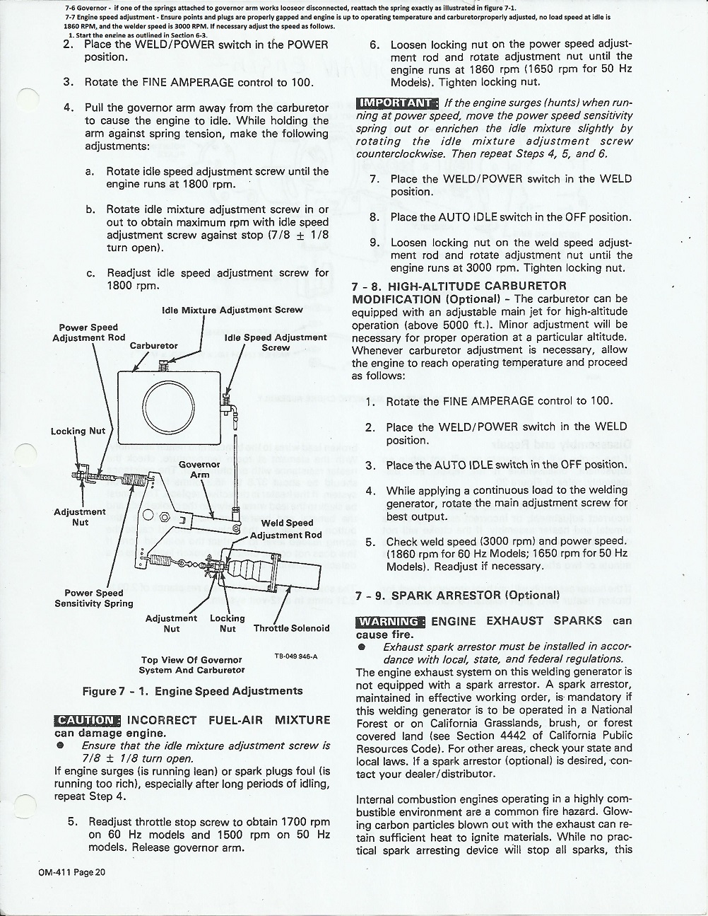

Joe it has a Governor to maintain RPM during load no load running. It must be set at welder speed manually . If the governor is working correct it won’t bog down when you strike the initial ark it will increase RPM just enough to keep it going and back off once the weld starts.

  Hey Thad,Thanks for that info,,,then I guess it is working like it susspossed to,,,,,ClapLooking like I tedious job to replace the gasket on the fuel pump,,,that thing is WAY down there,,,and looks like a 1/4" 12 point which I don't have,,,,Wink

Well Sparky, I didn't think ye would like to be called the 'Desert Flasher' whilest you were arching and sparking thet old welder...
  Here is a photo copy from a page in an AEAD manual. Wink  Finally figured out this was the welder you were werking on some several years back. And it just looked a bit different than mine did.
  Think this shows your gov arrangement.
https://www.allischalmers.com/forum/uploads/242/AEAD_gov_s.jpg

Geez, DJ, I fails you... Run across three pages more on the governor system which includes a tractor type throttle system for setting speed... sorta like the config on your machine, I didn't have a hand throttle lever, just the solenoid that yanks the chain to speed her up to the 3000 and a switch that ye flipped for generator, auto  and  continuous run (weld) position.
  Always thought it would have been nice to have a 'decelerator' on the engine to slow her down when shutting off instead of going into full throttle mode as it died.
  If you want yet, I could scan those three pages too.

 Well,,Thas OK ,,,,,UMMmmmm,,,,Errrrrrr,,,,aw chit I'll just call you JC,,,there I like that,,,,,LOLLOL
 Thanks for going to the trouble of finding that for me,, I followed the instructions but since I purchased a new carb the settings are not quite the same,,,,AND,,,,the dude that wants to buy it is on my azz to deliver,,,,,Wink
 The dang gasket under the fuel pump had a small oil leak and I did not want it to leave with any issues so I pulled the manifold cause them two friggin little bitty bolts are NOT accessible AND they are 12 point and I no gotty one ,,,, WEnt to several car part stores and not one to be found so,,I gonna have to make something ,,,I DID find a 1/4" 12 point BO wrench in one of my 6 toolboxes so it ain't gonna be a BO for very long,,,,,WinkWink

 Well, got the fuel pump re-gasketed, fired it up and,,,,and,,,all is good,,! So,,I started to make a bolt-on hold down clamp for the battery and dang near cut my friggin thumb OFF on right hand,,,,!!! I was using my 4 1/2" grinder to cut some friggin angle iron,,,now get this,,,I was holding the grinder with right hand and the angle iron with LEFT hand,,,when the grinder disc hung for an instant, and flew out of my hand, I jerked away from the work and next thing I knew,,,,,the grinder was in my LEFT hand,,still running and obviously running unbalanced as half the grinder wheel was gone,,,sounded like a bunch of BEES!!!  Jamie was working on his new boat close by so I hollared for him to come quick as my RIGHT hand was bleeding some fierce!!!!  He got the grinder out of my hand, turned it off and he grabs his phone and starts to call 911 cause it was bleeding so bad,,,,,I grab a rag and try to stop the bleeding and see my right thumb is bleeding right on the knuckle and also in the meaty part of hand right under the thumb. We go inside and get warm water going on it and while it does look ugly, I have a pretty deep gash from fingernail to almost halfway around thumb,,!  Yikes,,!! The meaty part of palm also has the same gash and bleeding  like a faucet,,,,!! The bleeding finally slows down and I start putting Lots of Neosporin on the cuts and bout that time the ambulance shows up. They take a look and agree with Dr Desert that all is good but I should get a current tetnaus shot. We kiss em on da cheek and I start puttin the band-aids on when the pulsating starts gettin serious!!!! I grab a 600 Mg Gabapentin. Jamie  wants to know WHY I don't take one of my Hydros as my pain is gettin serious,,,, ON ME,,the Hydros causes great issues of CONSTIPATION,,which is a story I need to pass on later,,,,
