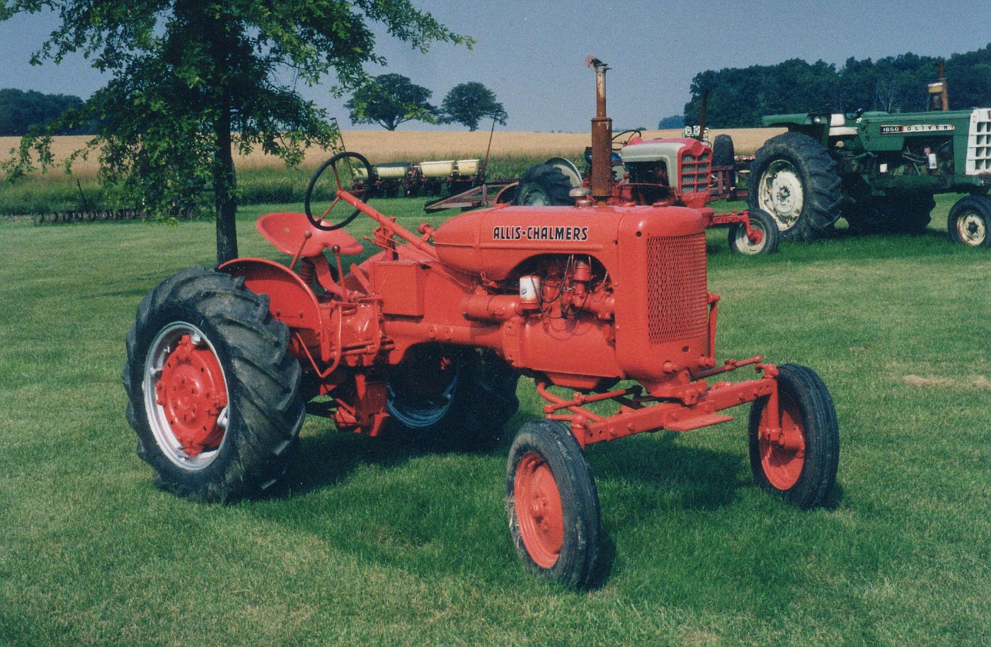

Yeas ago over on YT there was a guy in Michigan that was asking advise for over a year trying to get his CA to run. All kinds of advise of what was wrong but after trying to follow the different advices it would not start and run. One day he said he wanted it gone. He had decided that something was wrong with the engine that would cost more than he was willing to put into it. I emailed him and ask what he had to have. After responding I drove up into Michigan and winched it on my trailer. When I was home in my drive I crawled up on the trailer, set the timing, hit the starter, it came to life and I drove it off the trailer.
In that same time period another guy in Michigan had his Dads Oliver 66 that had set in a barn for years and would not run. He told me several people had looked at it and tried everything to get it to run but it wouldn't start. When I got there he had a couple of guys trying to start it. When they walked away I set the timing, hooked up my Jump & Carry, sprayed starter fluid into the carburetor and it started. I kept misting starter fluid to keep it running and didn't see any bad smoke. I paid for it, winched it on. When home I cleaned the carburetor and the next weekend I took it to tractor pull and took second place in the 3,000 pound class. The two guys that was trying to start it when I got there to look at it walked up to the side of the trailer while it was still loaded. I was coming back from sighing up and over one say that tractor look like the one some crazy bought from so and so. Yup, I said I be that crazy fellow.
Knowing how to time an engine is kinda important.
This is the CA
