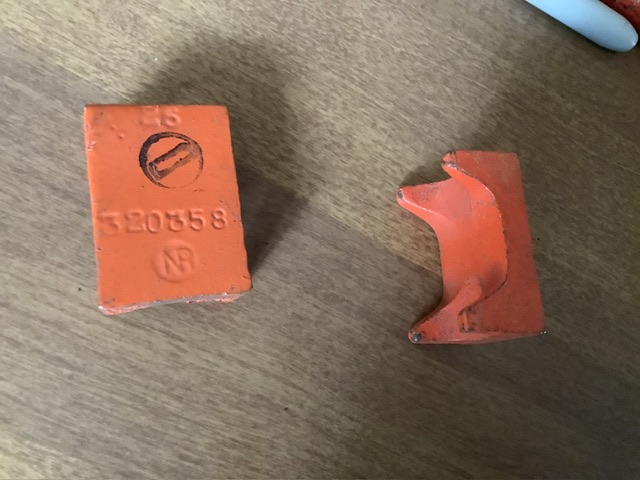

Post Options Post Options   Thanks (0) Thanks(0)   Quote dfwallis Quote  Post ReplyReply Direct Link To This Post Posted: 11 Apr 2026 at 12:40pm
Here is what the plow pullbar (clip) spacer 320358 looks like.  So, either the line drawing in the plow manual was inaccurate or they changed the design at some point without changing the part number.  Since I couldn't find an image of it anywhere online, this is a good place for it (although I think older images get deleted from the site, from looking at very old posts).
Image courtesy of Mikez:
