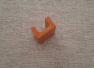

Post Options Post Options   Thanks (0) Thanks(0)   Quote dfwallis Quote  Post ReplyReply Direct Link To This Post Posted: Yesterday at 11:31am
I wanted to make sure I have something ready for my next trip, so I made a draft (clip) spacer for the pickup plow pull bar.  I'd still like to acquire the correct one, but this should work if I can't.
This is probably too thick to set the tongue at the right angle so I'll probably have to shave the bottom slightly.  I don't think that's really critical though since you're never going to have a plow and tractor on perfectly level ground in the real world.  If it works as-is, I'll probably not modify it.  If I have to modify it, I'll consider cutting the sides at the same time to match the snap coupler rendering rather than the pin hitch rendering in the plow manual.  What is the purpose of the side cutouts?  Perhaps better moisture drainage?  Better greasing access?  Change for change sake?
