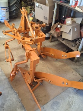

12/04/2025 Status:
In order to complete assembling the plow, I needed two "locking" bolts that I didn't have.  Dr P was sending me some, but had not received them (they may have arrived later after I left).  So I made some out of stainless steel.  I used some nice 1/2" "thumb" screws from McMaster-Carr.  Chopped off the sides and top and hand ground to the right curvature.  They actually fit the slots "better" than the originals.  They are just a little long, but could shorten if it was needed.
I'm not quite happy with the way the plowshare attaches.  The spacer section on one is not meeting correctly because I didn't get the bracket bent back quite right.  I'll need to work on that a bit more.
I was hoping to get further along, but it was a bit chilly and I had motivation problems...:(  I also had to wait for some parts.  I originally intended to use stainless in strategic areas, but some of the bolts I bought were of such low quality, that they kept galling with only enough force to close the lock washer.  I quashed that and got grade 8 bolts instead.  Actually had to cut one off that hadn't even been tightened enough to keep the parts from sliding around.  After I cut it off, I tried getting the nut off and could not putting it in a vice and using a 24 inch pipe wrench.  It was firmly welded in place :(
It was leaf mulching time, but all of the mowers were broken.  It was about to rain, so I tried to get one of the riders going.  I replaced the two deck spindles (which were probably used on another one), sharpened the blades, cleaned, and painted.  I also straightened the deck wheel brackets.  I moved to the engine itself, replaced the battery and got it started, but the float was sticking and dumping a huge amount of gas into the cylinder.  I cleaned the carburetor but all of the rubber gaskets were deteriorated.  So I ordered a new carburetor for about the same price as a gasket set.  It didn't arrive until the last day of the trip when I was trying to get things cleaned up to leave.
Since it was clear I wasn't going to get the rider fixed, I went to town and bought the lowest end push mower they had and mulched the main areas.  It was very wet and things didn't mulch well.
I also took some of the Dunham Lehr disc tongue and rear gang mounts to the welder to be straightened up.  He straightened the tongue brackets pretty well, but was unable to straighten the angle iron sections.  Couldn't get enough heat on them.  I opted to have him make some replacements I'll pick up in a few weeks.
I took the hydraulic cylinder to a shop for repair.  He seemed optimistic about being able to repair it (even optimistic about locating a replacement head/cap section).  He can also make one if needed.  It's a pretty simple design in aluminum.  Hopefully, that will be ready also to be picked up in a few weeks.
I put primer on various parts so they don't rust before I get around to painting them (including the above straightened brackets).

Post Options Post Options   Thanks (1) Thanks(1)   Quote Sugarmaker Quote  Post ReplyReply Direct Link To This Post Posted: 05 Dec 2025 at 8:35pm
dfwallis,
You are always busy with projects! Your blast vac is similar to the one I added to my old blaster. It helps a lot. The other thing is that I added a very bright portable light inside the cabinet also.
Your plow project is coming along nicely!

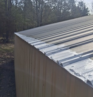

I had medical, insurance, and tax issues to deal with so didn't get much done in January and February.  In March, most of the work was focused on getting the barn roof ready for recoating.   The eaves were severely rusted and on the verge of rusting into the interior.  So I applied (kludge) flashing beneath the eaves with pop rivets and then a thick coating of sealant on top.  The flashing was primarily to give the sealant something to stick to.  I think it will extend the life for a few more years before new tin is required, as long as the coating is maintained.  New coating may get applied in April (weather permitting).

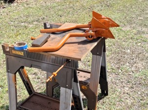

I was able to return to assembling the plow and now have it mostly complete.  I had to make some plow bolts.  I can find #7 head plow bolts online, but nothing smaller than 5/8" (need 3/8").  Dave the Plowman sent some but only partially covered the moldboard assembly.  I found the closest currently available plow bolts and ground them to fit.  They fit very well, about as well as the originals.  I ran out of grade 8 3/8 bolts, washers, and nuts and didn't have time to go to town.  They're on order and should be there before the next trip.  This is primarily for the jointer clamps.  I'm also missing the spacer that goes between the pull bar and the top through bolt of the U clamp.  It looks like a U channel in the pickup plow manual (see other thread).
Aside from installing the jointer clamp bolts and the spacer for the pull bar (clip spacer?), the remaining tasks are to adjust the coulters and jointers, tighten up most of the bolts, and apply some touchup paint.  Then I need to figure out where to store it, hopefully out of the weather.
