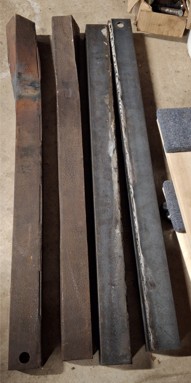

I also took some of the Dunham Lehr disc tongue and rear gang mounts to the welder to be straightened up.  He straightened the tongue brackets pretty well, but was unable to straighten the angle iron sections.  Couldn't get enough heat on them.  I opted to have him make some replacements I'll pick up in a few weeks.
