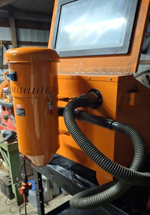

Edit:  I also built a mounting system to add a vac onto the sand blast cabinet.  This is the unit sold for the larger (vevor) blast cabinet.  Was pretty easy to adapt.  I liked it better than the small/puny one sold for this cabinet.  I still can't operate it at the same time as the compressor though (inadequate supply current).  I'll either have to run a long drop cord or work on getting the other leg of the 220 from the pump house to the barn.  It's already probably wired, but does not seem to be energized at the pump house, which I'd have to dig up.

dfwallis,
You are always busy with projects! Your blast vac is similar to the one I added to my old blaster. It helps a lot. The other thing is that I added a very bright portable light inside the cabinet also.
Your plow project is coming along nicely!

I'll probably have to improve the lighting.  I'll know better once I test the vac operation.
