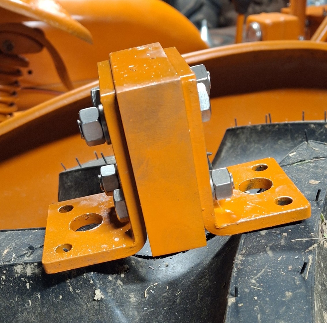

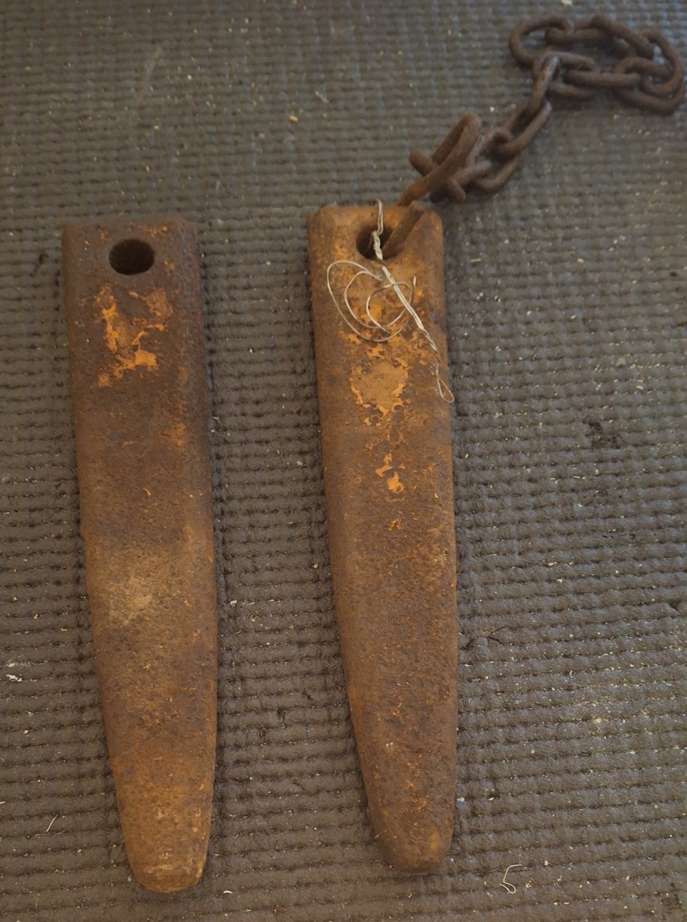

In preparation for attaching the first 3pt implement, I attached the new front wheel weights.  It probably wasn't necessary.  The finish mower is 524 lbs.
Because the right side rim was damaged (calcium chloride damage) and welded all the way back in the 60s, the wheel weight isn't sitting flat on the right side.  I'm probably going to have to grind the weld down more to get the weight to sit flat and reduce wheel wobble and then see if I can balance it better.  If I have to get a new rim, I will.

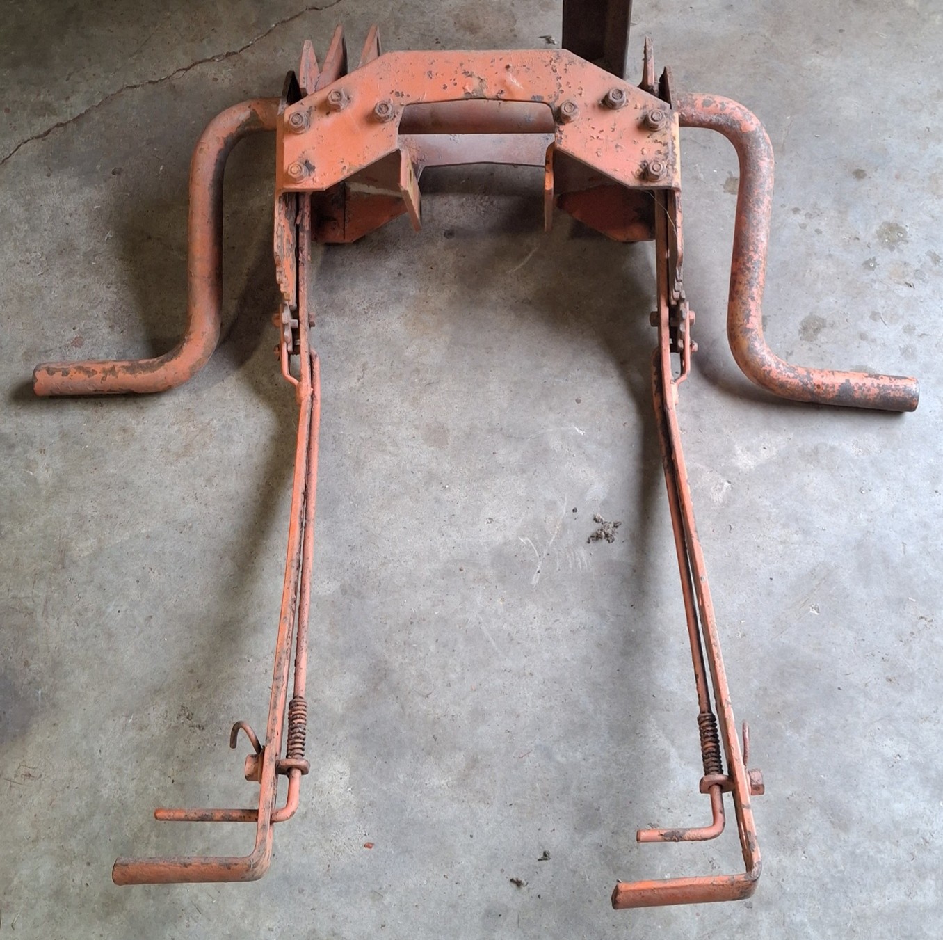

First attempt connecting a 3pt attachment.  It worked fairly well although the rockshaft mounted top link bracket makes for an extremely short top link requirement.  I have some improvements in work (including for improved safety).  The CA PTO shaft is a bit too high and too close to the top link bracket.  I have some design tweaks to make to eliminate any potential collisions when the top link angle declines.
The tractor picked the mower up with not even a hint of complaint (524lbs).
The remote is still leaking.  The pipe extension was pretty rusted, I'll probably have to change it out.  I think I have some spare stainless pipe extensions.
I also installed an overrunning clutch.
Another repair was to fix the rear tail light.  It turned out that the entire fender was not grounded.  I had added some largish flat washers to distribute the load on the thin fender metal.  I guess grounding was previously via the lock washers digging through the paint.

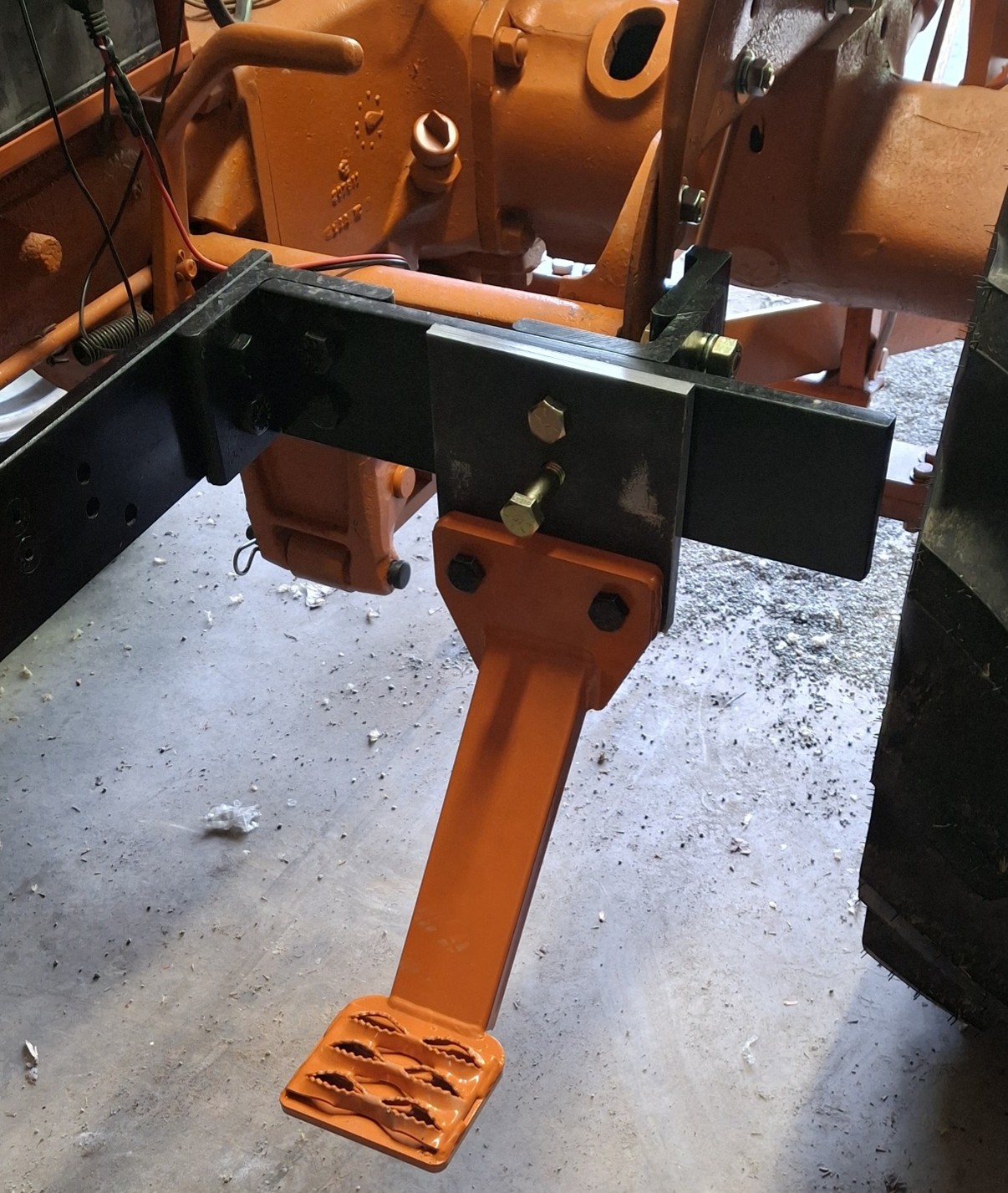

5/28/2025 Status:  Quite a bit of progress was made on this recent trip:  1) Replaced the venturi in the TSX486.  The one received was not a good match but I machined to match (length, new one was too long for the top of the carb to tighten into position).  The major hole diameter of the venturi was also smaller.  Was not happy about that, I was very clear to the vendor to ensure it was correct for a TSX-486 (can't tell from the online pic).  The documentation implied it was correct, but it obviously was not a good match (I've since ordered the correct venturi).  Anyway, the engine does run better and noticeably leaner (did not overheat with a good workout).  The spark plugs are no longer rapidly coating with carbon.  So, I'm sure that was part of the problem (although still not fixed correctly).  It still misses sporadically.

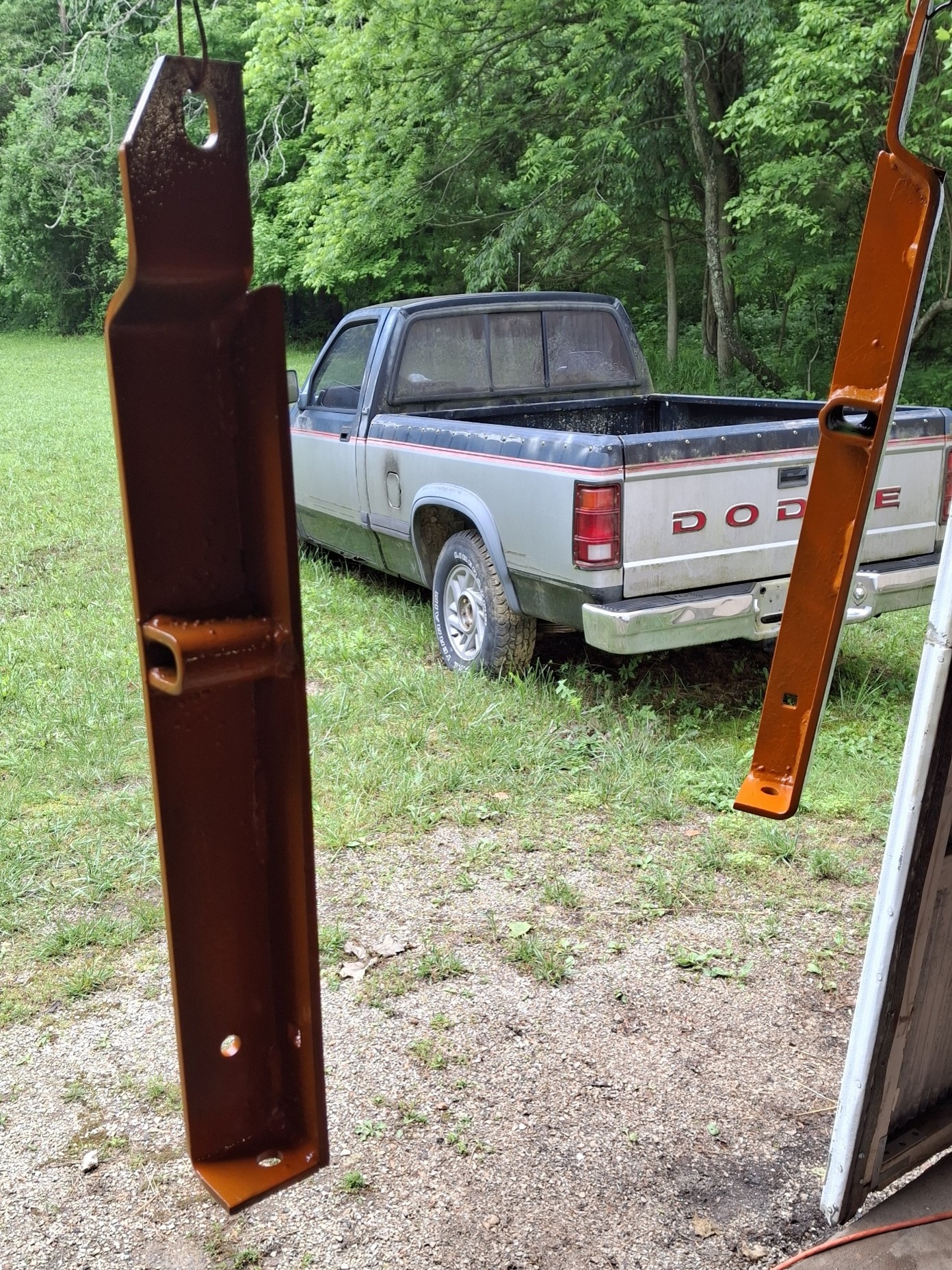

2) I Completed the bracket for mounting the step on the left side rail in front of the clutch pedal and mounted the step.

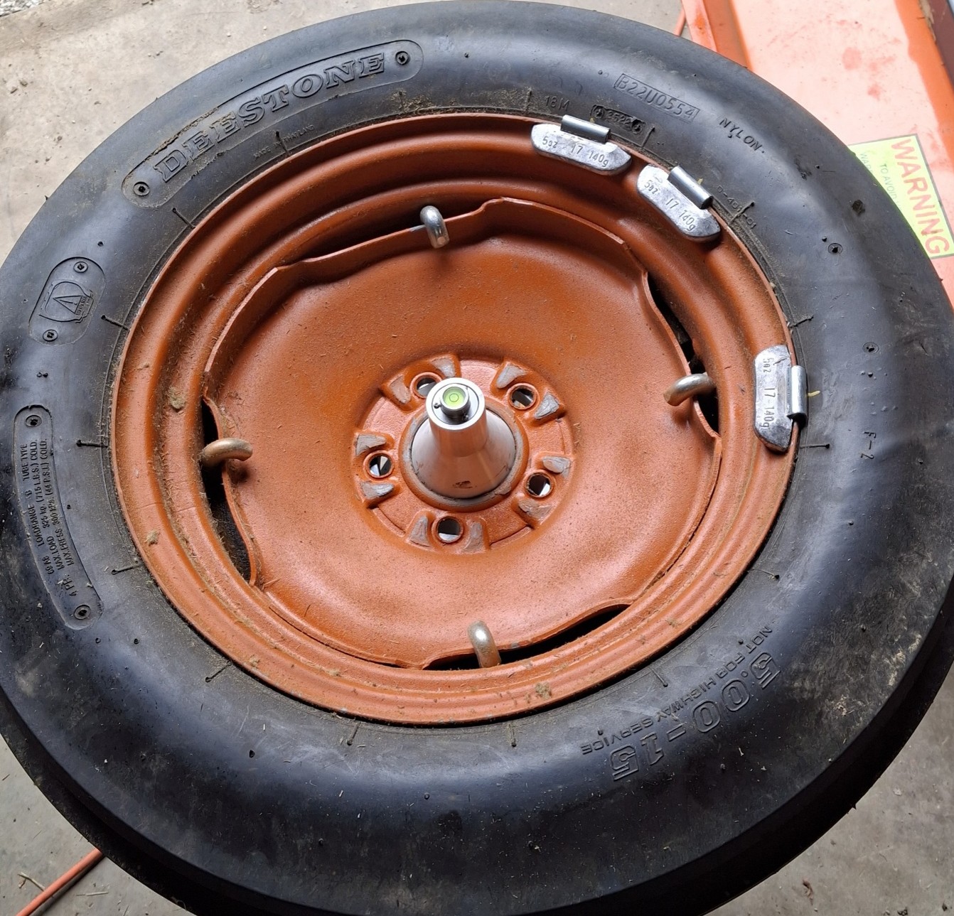

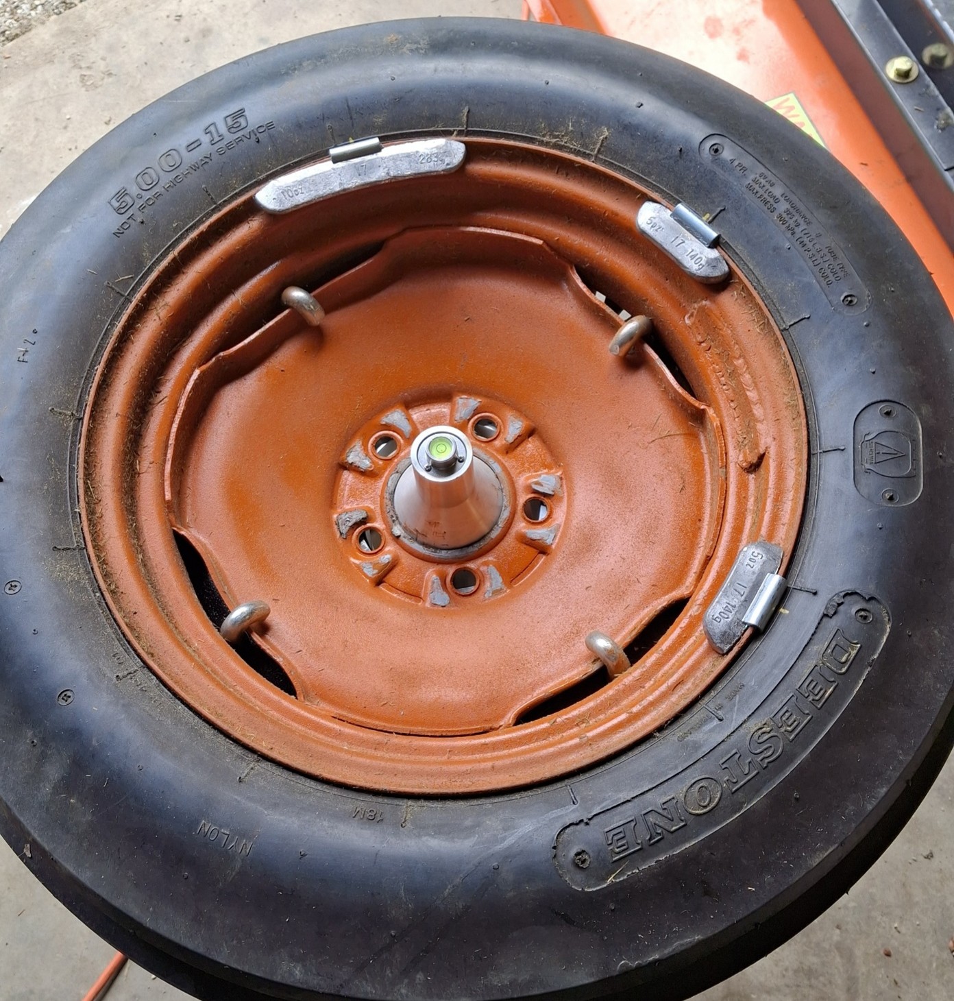

3) Balanced the front tires.  On the road, the wheels and steering wheel were WILDLY oscillating.  Several of the tire places I called didn't want anything to do with it (thinking it couldn't possibly matter going that slow, but it DOES in 4th), so I bought a harbor freight bubble balance and some I7 weights and did it myself.  The result was a dramatic improvement.  No more wild oscillation.  The tires were each off around a pound.  It took 20 oz to balance one and 15 oz to balance the other.  Depending on whether they were in or out of sync, the amount of oscillation could be dramatically different as well.

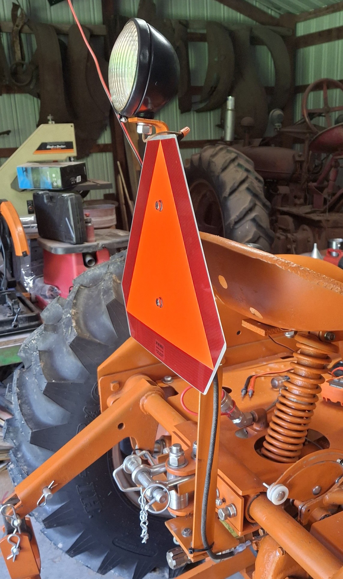

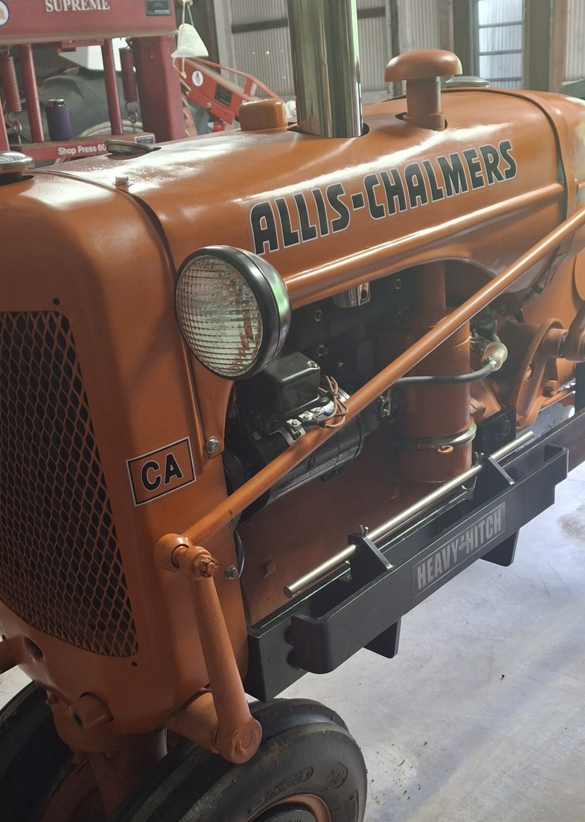

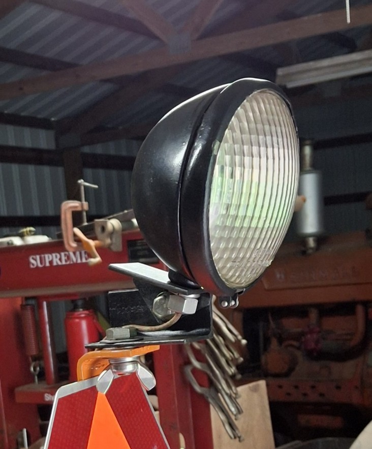

5) Made brackets for the safety emblem and added a spotlight above it on the rear of the tractor.  Wired the spotlight.  First switch position is headlights/taillights, second position adds the rear spotlight.  I purchased separate magnetic flashers for occasional use on multiple tractors.

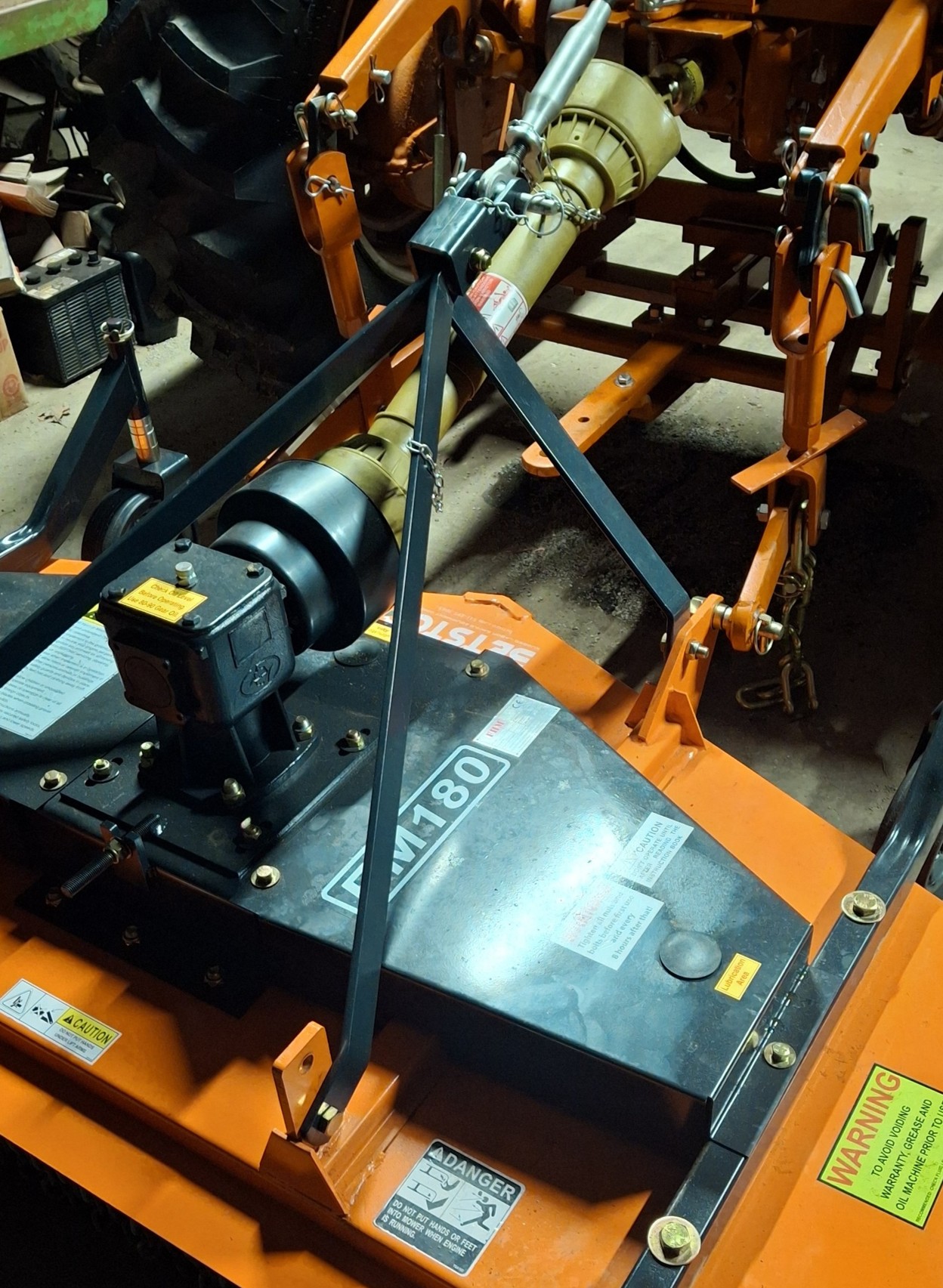

12) I added an extension on the PTO shield to keep the rockshaft mounted top link bracket from going down too far and contacting the PTO shaft (if something went wrong).  This allowed me a convenient mounting point for the safety emblem (it was previously on the old original PTO shield, which I have saved unmodified).

Mounting of the step on the left side in front of the clutch.  This is a better location than the designed placement at the cultivator mount on the torque tube.  I never really had any trouble getting on/off, but this does make it a bit easier.

Tires balanced.  It took 15oz for the left front tire and 20oz for the right front tire.  This dramatically improved/eliminated the wild oscillations in 4th gear.  I was disappointed in the tire shops I called pooh poohing balancing these tires.  Both rims show to be bent but they are very large gradual bends all but invisible unless you use a straight edge to compare with.   The right side tire has a heavy weld in two spots where the rim was destroyed by a tire ballast leak in the 60s, but surprisingly, that was not where the imbalance was.  I did have to grind the weld down a little in one spot to get the wheel weights (not the clip on balance weights) to center.
Edited by dfwallis - 28 May 2025 at 11:11am

I added an extension on the PTO shield to keep the rockshaft mounted top link bracket from going down too far and contacting the PTO shaft (if something went wrong).  This allowed me a convenient mounting point for the safety emblem (it was previously on the old original PTO shield, which I have saved unmodified).  I also added a spotlight on the top.  This is one of the original headlights.  Both were pretty mangled, but I made one good one out of the two and a repair kit for the bulb socket.  It has an LED bulb, but I'm not sure if it's bright enough.  There are LED bulbs in the headlights too, but I couldn't locate the same non-polarized bulbs I used.  The headlight bulbs are 2X brighter.  The bracket is just a tad too close to the seat, but I don't think it will be a problem.  I can always move it back if it is.
I created an adjustable bracket for the spotlight.  I can point it pretty much anywhere I might need it.  It isn't quite convenient because you do need a wrench to hold the bolt while tightening the wing nut.  I may find or create a lock for the bolt heads to make it easier.  I ordered some 2-tab washers that may work if the tabs are long enough.  Bend one tab up and one tab down.

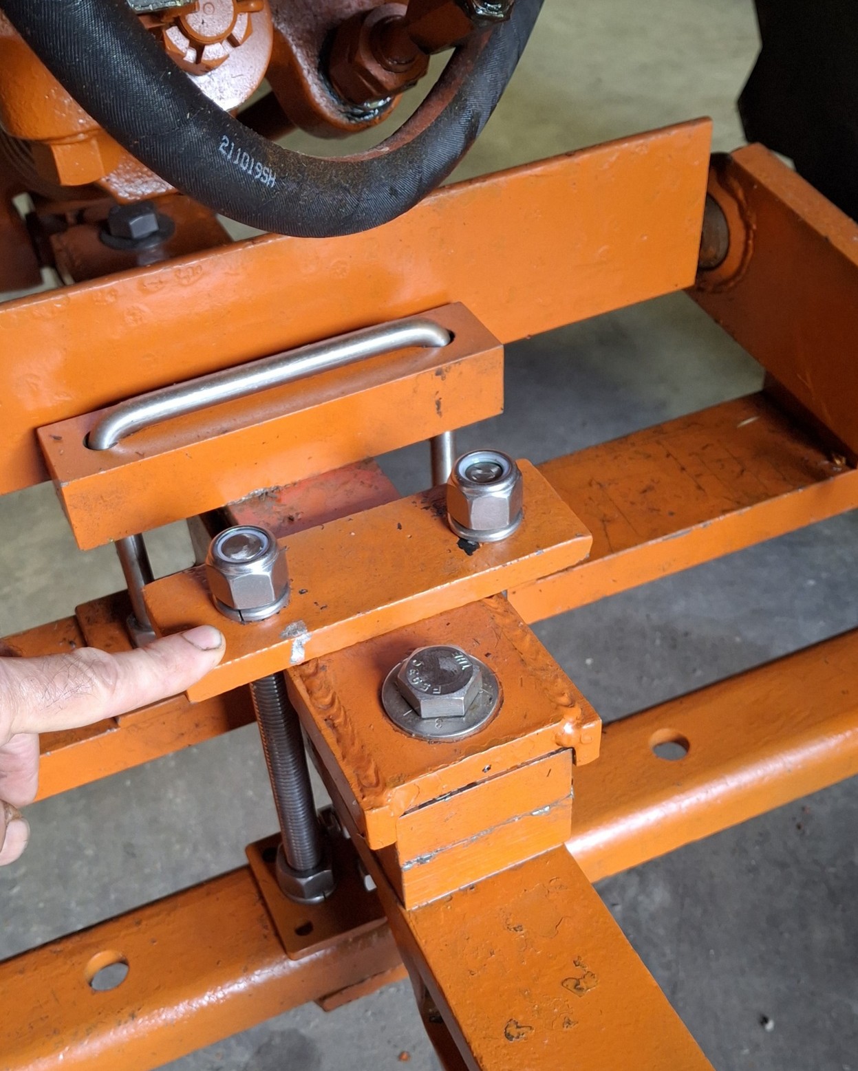

The original bail was initially just moved furthest back in the hangar on the bottom side of the draw bar.  In order to get it further out of the way of the 3-point lift arms, it needed to go further back about 3 inches.  This necessitated a spacer (shown below).  The original bail is used to provide part of the horizontal stability of the add-on bail.  It still only requires removal of 3 pins to completely remove the drawbar (e.g. to connect the plow).  However, it is a bit heavier, and advisable to remove the 3-point arms to lower the weight a bit.
The bracket needed to move the bail forward required a 3 inch spacer which I luckily had an exact 1 inch thick x 3 inch remnant available (got a few more coats of orange after this pic).

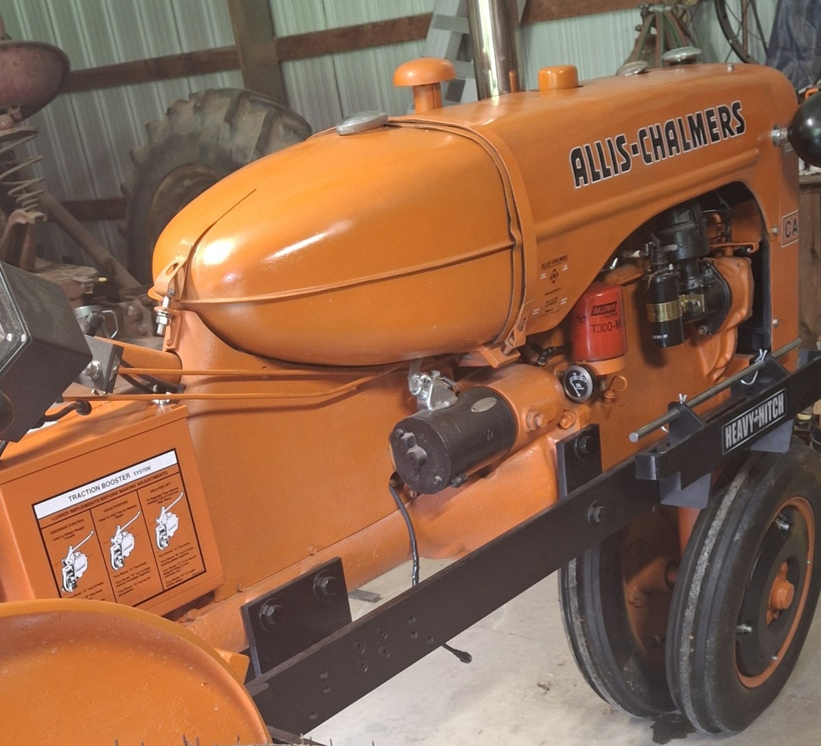

One of the last things done was to apply all the decals (not all technically in the right positions).  I don't think the "CA" decal was designed quite right.  It had a rectangular box around it which caused the decal to wrap around the front of the cowling.  I guess I could have placed it lower, but the directions indicated it should go in front of the lower hood bolt.
The hood and gas tank were severely damaged in various logging accidents.  I spent more time than I had trying to improve them, but there were too many other mechanical issues I had to get to so I cut my losses.  I may revisit it one day.

In order to keep the PTO shaft from hitting the implement top link bracket, I modified the rear to top link braces to bring the top link bracket fully vertical and inline above the lower lift arm attachments.  This significantly improved the PTO shaft clearance by several inches (mostly problematic at the lowest lift position).  The old Zephyr 510 450RPM 1/2 inch drill nearly broke my arm drilling those large holes.  I remember it almost broke my arm in the 60s when I used it too.  I was surprised it's still functional :).

Explore ROPS and Canopy (I've used (thick) flat steel so far and I know C-channel might be better/stronger but flats are easier for me to fit).  I think 3/4" flats will be acceptably strong as compared to a typical thin walled C channel or square tubing, when corner braced.  I could easily go thicker if needed.  Of course, adding a ROPS will complicate removing the drawbar with 3-point in use, since it will attach to the secondary bail I created for the 3-point mods.  That's not very desirable since I want it to be easily reconfigurable.
Explore secondary hydraulic pump mounting options.  I'm inclined to design the bracket to support either mounting via rear belt pulley or on the front via the installed cultivator bracket (i.e. both places as needed), designed for easy removal to reconfigure for cultivator use.  I've been looking at the front engine pulley (adaptors, spline rods) that's commonly sold.  It does not support the hand crank, but I think I can mod it to supply both a spline and a hand crank fitting.  That is, if there is room for the hand crank fitting which is doubtful (from memory), but I haven't measured it.  I might try cutting the hand crank notch out of the spline fitting if there's enough metal to work with.  Possibly silly, but I want to keep the hand crank capability.
Edit:  I intentionally chose a CW pump to interface with the belt pulley better in my selected mounting location.  I would need a CCW pump to mount on the front.  I'll probably go ahead and make the dual bracket, but I'd have to buy another pump (SAE B mount) to use it on the front.

My brother thinks he remembers seeing one of these "recently", but I searched high and low to no avail.  So I found these online for a pretty penny.  I have both the original chains, they were still attached to the bracket.  I could probably take a metal detector and scour the 40 acres and find them both...  I don't really like those cheap knockoffs they're selling, but I could probably have machined them to look a little closer to the originals.
