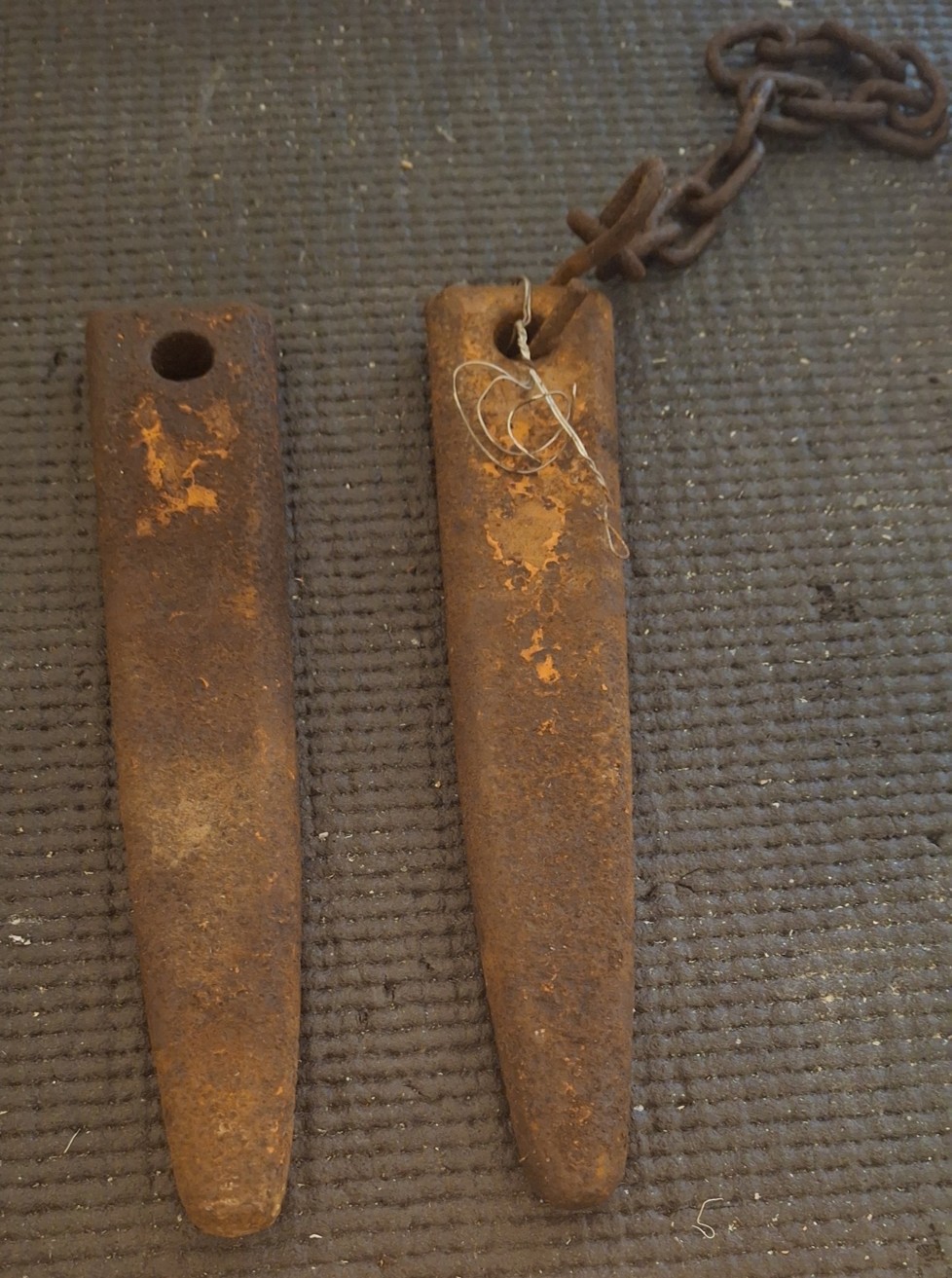

In preparation for attaching the first 3pt implement, I attached the new front wheel weights.  It probably wasn't necessary.  The finish mower is 524 lbs.
Because the right side rim was damaged (calcium chloride damage) and welded all the way back in the 60s, the wheel weight isn't sitting flat on the right side.  I'm probably going to have to grind the weld down more to get the weight to sit flat and reduce wheel wobble and then see if I can balance it better.  If I have to get a new rim, I will.

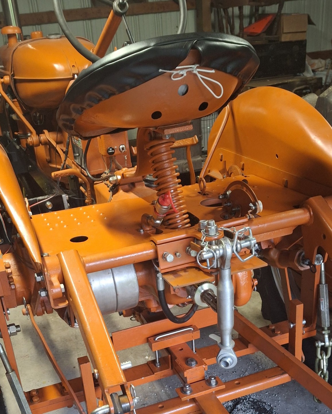

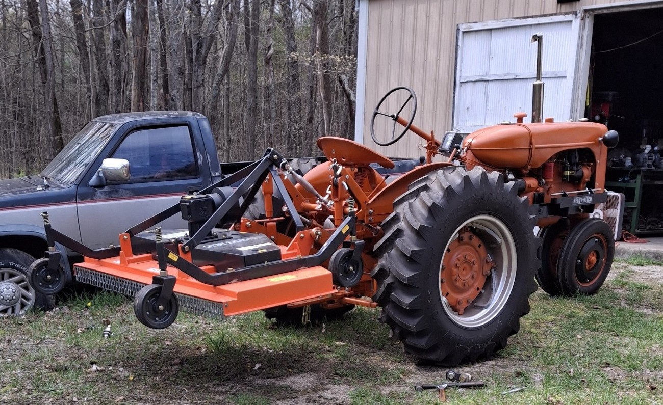

First attempt connecting a 3pt attachment.  It worked fairly well although the rockshaft mounted top link bracket makes for an extremely short top link requirement.  I have some improvements in work (including for improved safety).  The CA PTO shaft is a bit too high and too close to the top link bracket.  I have some design tweaks to make to eliminate any potential collisions when the top link angle declines.
The tractor picked the mower up with not even a hint of complaint (524lbs).
The remote is still leaking.  The pipe extension was pretty rusted, I'll probably have to change it out.  I think I have some spare stainless pipe extensions.
I also installed an overrunning clutch.
Another repair was to fix the rear tail light.  It turned out that the entire fender was not grounded.  I had added some largish flat washers to distribute the load on the thin fender metal.  I guess grounding was previously via the lock washers digging through the paint.

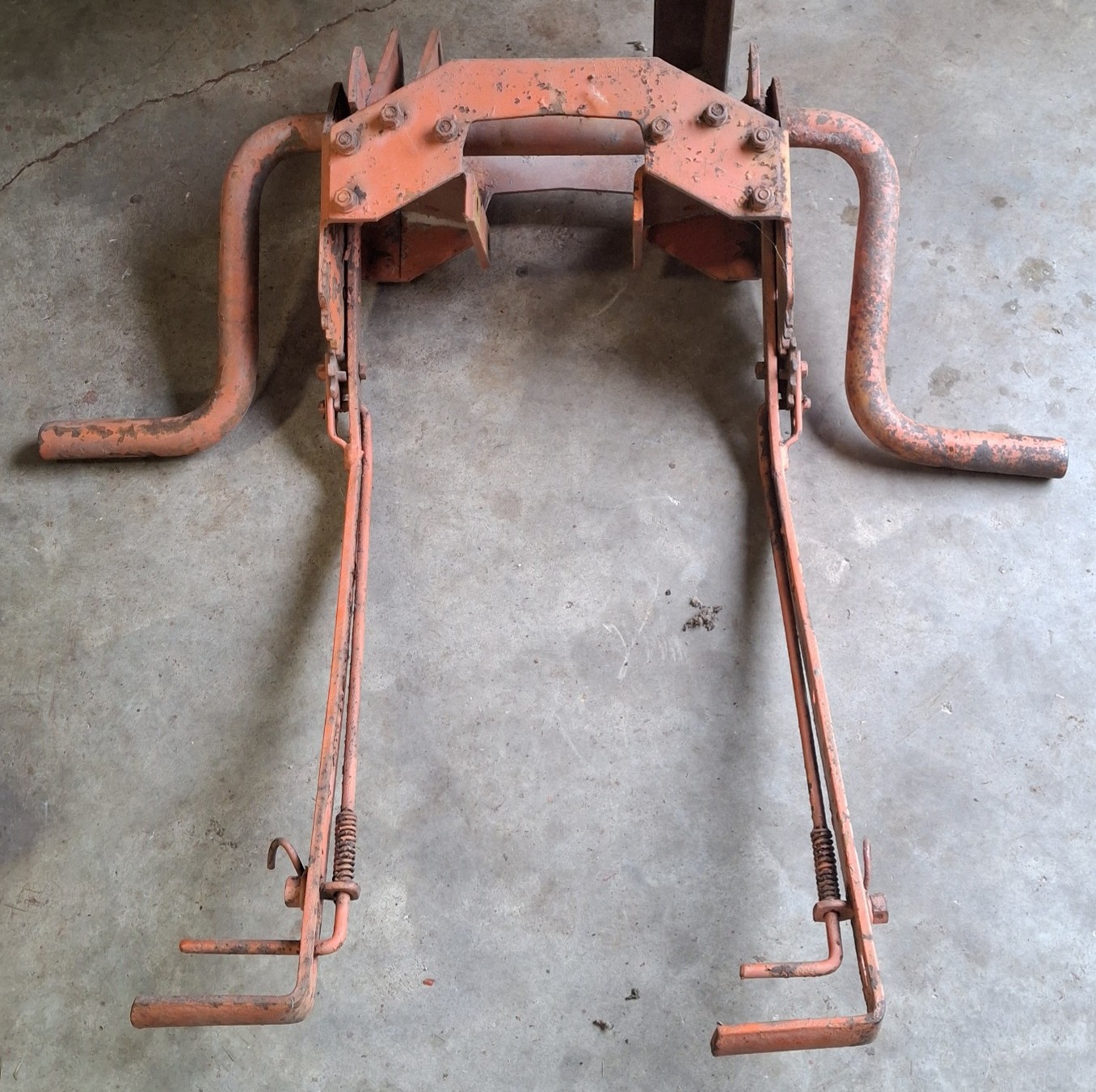

I worked to get some additional basket case implements out of the dirt and up on blocks.  The more I look at this twisted heap (Krause), the sadder I get :(  The rear disk sections are a few hundred feet behind.  I'll have to cut them out of the saplings.  The disk sections and the wheels turn fine.  Most of the disks seem like they might be cleaned up.  I only saw one that was severely disintegrated along the bottom (and one broke in half).  Straightening out some of those major frame twists might be difficult.  Local body shop perhaps (if I proceed, probably not this year).  I guess somebody used it to try to disk down large trees :(

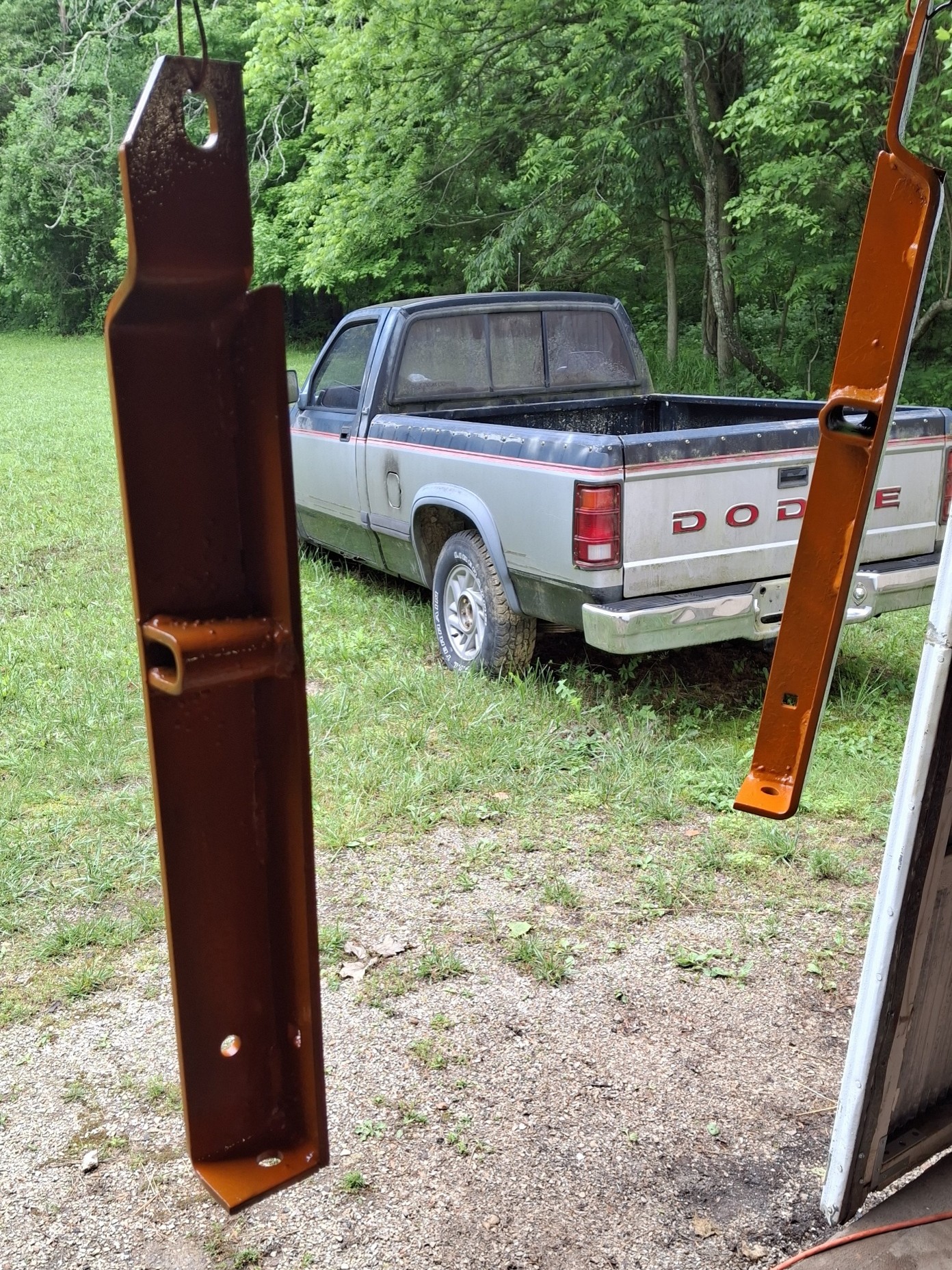

5/28/2025 Status:  Quite a bit of progress was made on this recent trip:  1) Replaced the venturi in the TSX486.  The one received was not a good match but I machined to match (length, new one was too long for the top of the carb to tighten into position).  The major hole diameter of the venturi was also smaller.  Was not happy about that, I was very clear to the vendor to ensure it was correct for a TSX-486 (can't tell from the online pic).  The documentation implied it was correct, but it obviously was not a good match (I've since ordered the correct venturi).  Anyway, the engine does run better and noticeably leaner (did not overheat with a good workout).  The spark plugs are no longer rapidly coating with carbon.  So, I'm sure that was part of the problem (although still not fixed correctly).  It still misses sporadically.

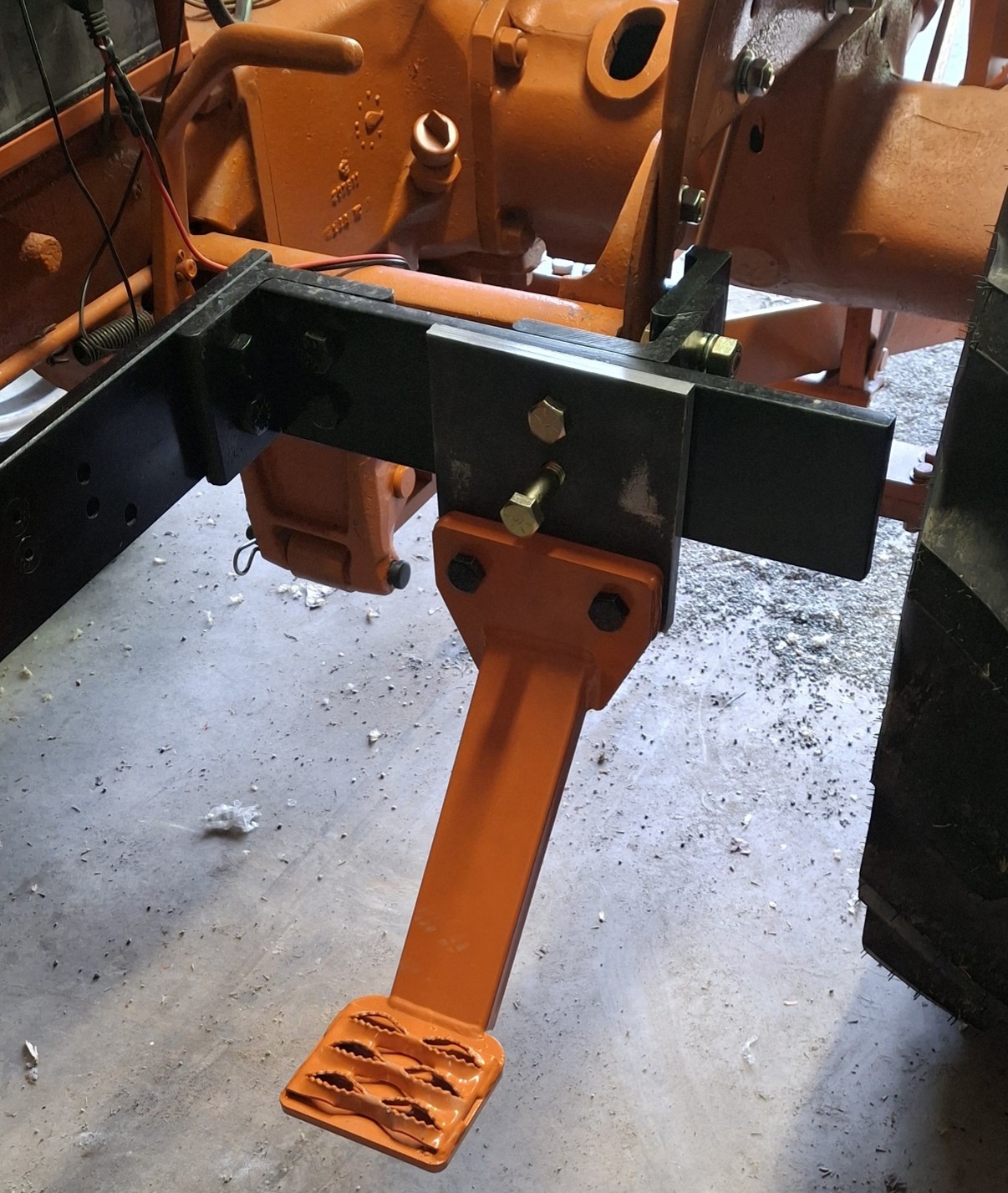

2) I Completed the bracket for mounting the step on the left side rail in front of the clutch pedal and mounted the step.

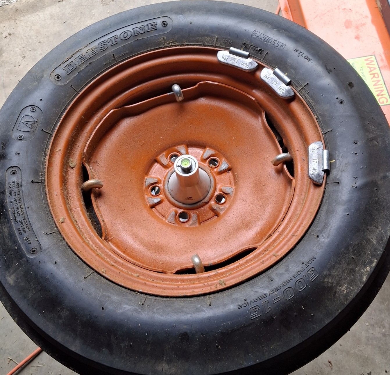

3) Balanced the front tires.  On the road, the wheels and steering wheel were WILDLY oscillating.  Several of the tire places I called didn't want anything to do with it (thinking it couldn't possibly matter going that slow, but it DOES in 4th), so I bought a harbor freight bubble balance and some I7 weights and did it myself.  The result was a dramatic improvement.  No more wild oscillation.  The tires were each off around a pound.  It took 20 oz to balance one and 15 oz to balance the other.  Depending on whether they were in or out of sync, the amount of oscillation could be dramatically different as well.

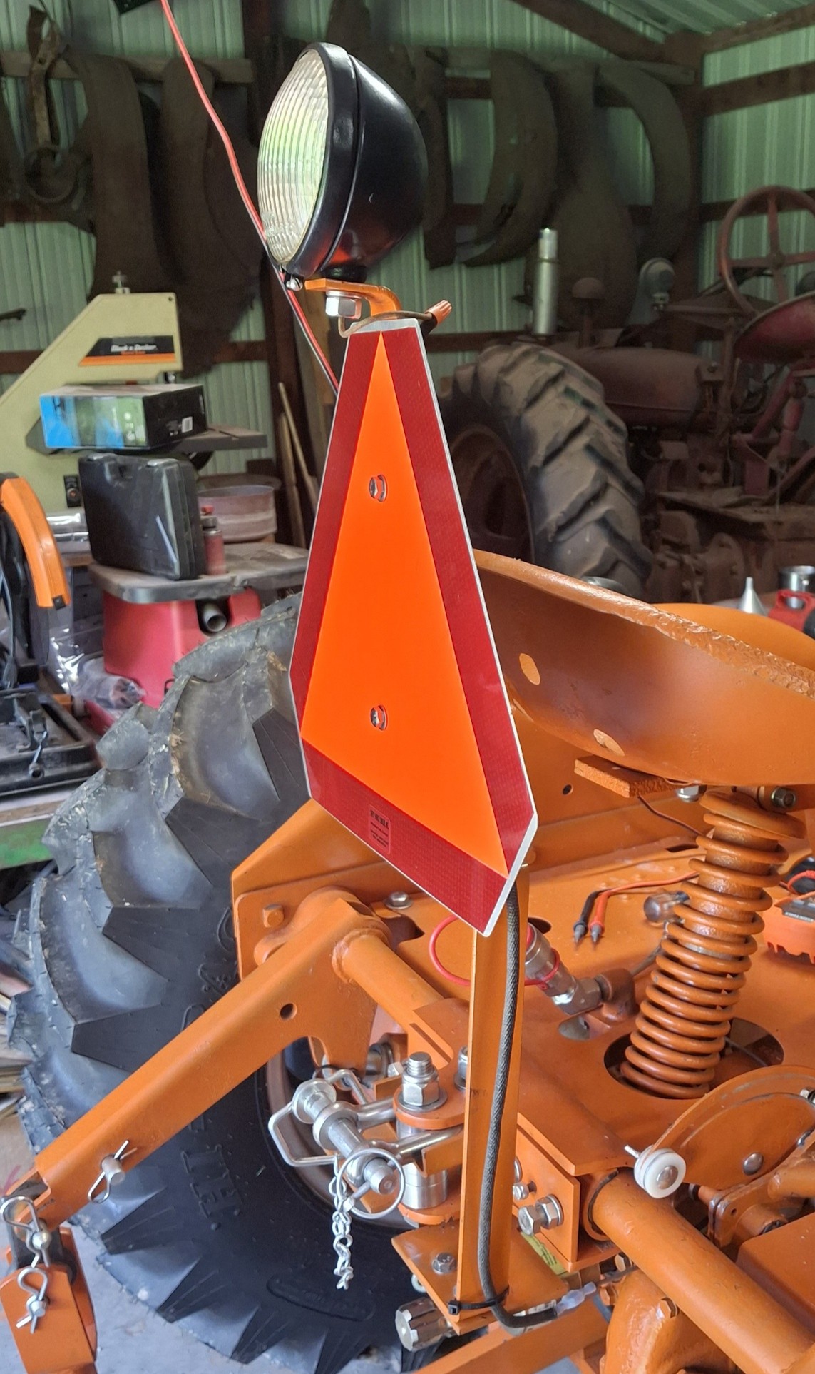

5) Made brackets for the safety emblem and added a spotlight above it on the rear of the tractor.  Wired the spotlight.  First switch position is headlights/taillights, second position adds the rear spotlight.  I purchased separate magnetic flashers for occasional use on multiple tractors.

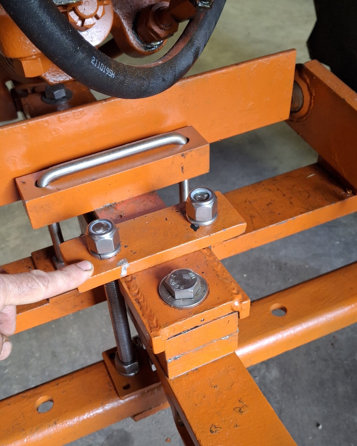

Mounting of the step on the left side in front of the clutch.  This is a better location than the designed placement at the cultivator mount on the torque tube.  I never really had any trouble getting on/off, but this does make it a bit easier.

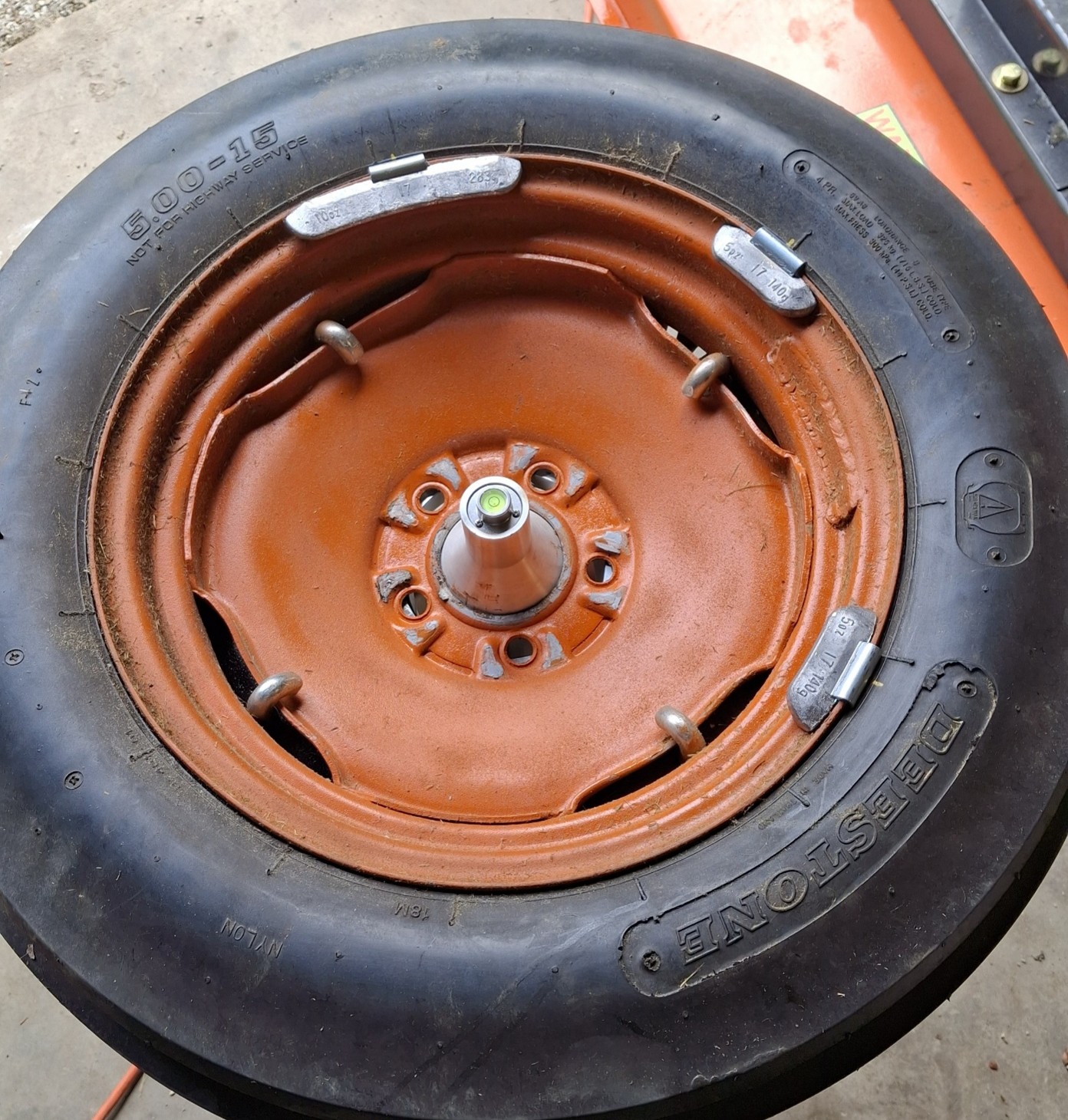

Tires balanced.  It took 15oz for the left front tire and 20oz for the right front tire.  This dramatically improved/eliminated the wild oscillations in 4th gear.  I was disappointed in the tire shops I called pooh poohing balancing these tires.  Both rims show to be bent but they are very large gradual bends all but invisible unless you use a straight edge to compare with.   The right side tire has a heavy weld in two spots where the rim was destroyed by a tire ballast leak in the 60s, but surprisingly, that was not where the imbalance was.  I did have to grind the weld down a little in one spot to get the wheel weights (not the clip on balance weights) to center.

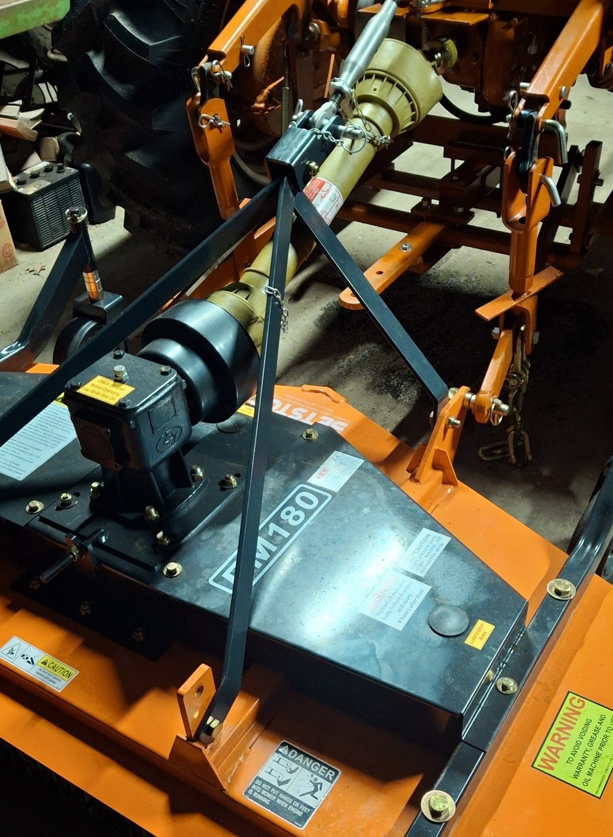

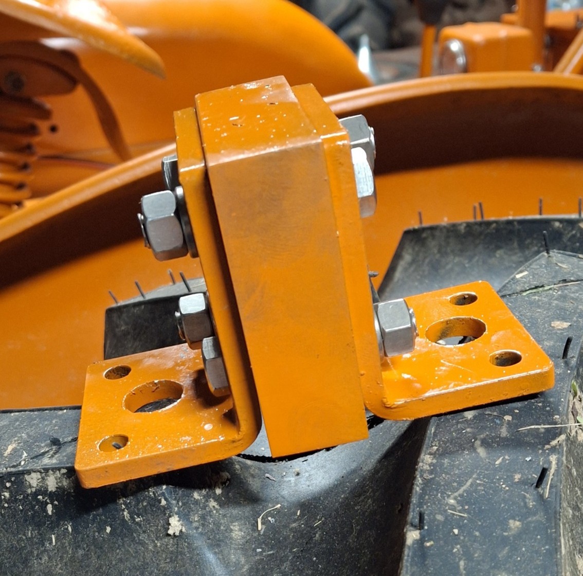

I added an extension on the PTO shield to keep the rockshaft mounted top link bracket from going down too far and contacting the PTO shaft (if something went wrong).  This allowed me a convenient mounting point for the safety emblem (it was previously on the old original PTO shield, which I have saved unmodified).  I also added a spotlight on the top.  This is one of the original headlights.  Both were pretty mangled, but I made one good one out of the two and a repair kit for the bulb socket.  It has an LED bulb, but I'm not sure if it's bright enough.  There are LED bulbs in the headlights too, but I couldn't locate the same non-polarized bulbs I used.  The headlight bulbs are 2X brighter.  The bracket is just a tad too close to the seat, but I don't think it will be a problem.  I can always move it back if it is.

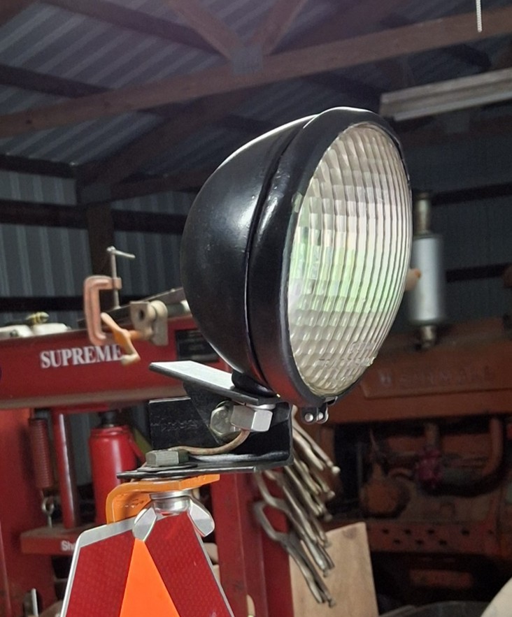

I created an adjustable bracket for the spotlight.  I can point it pretty much anywhere I might need it.  It isn't quite convenient because you do need a wrench to hold the bolt while tightening the wing nut.  I may find or create a lock for the bolt heads to make it easier.  I ordered some 2-tab washers that may work if the tabs are long enough.  Bend one tab up and one tab down.

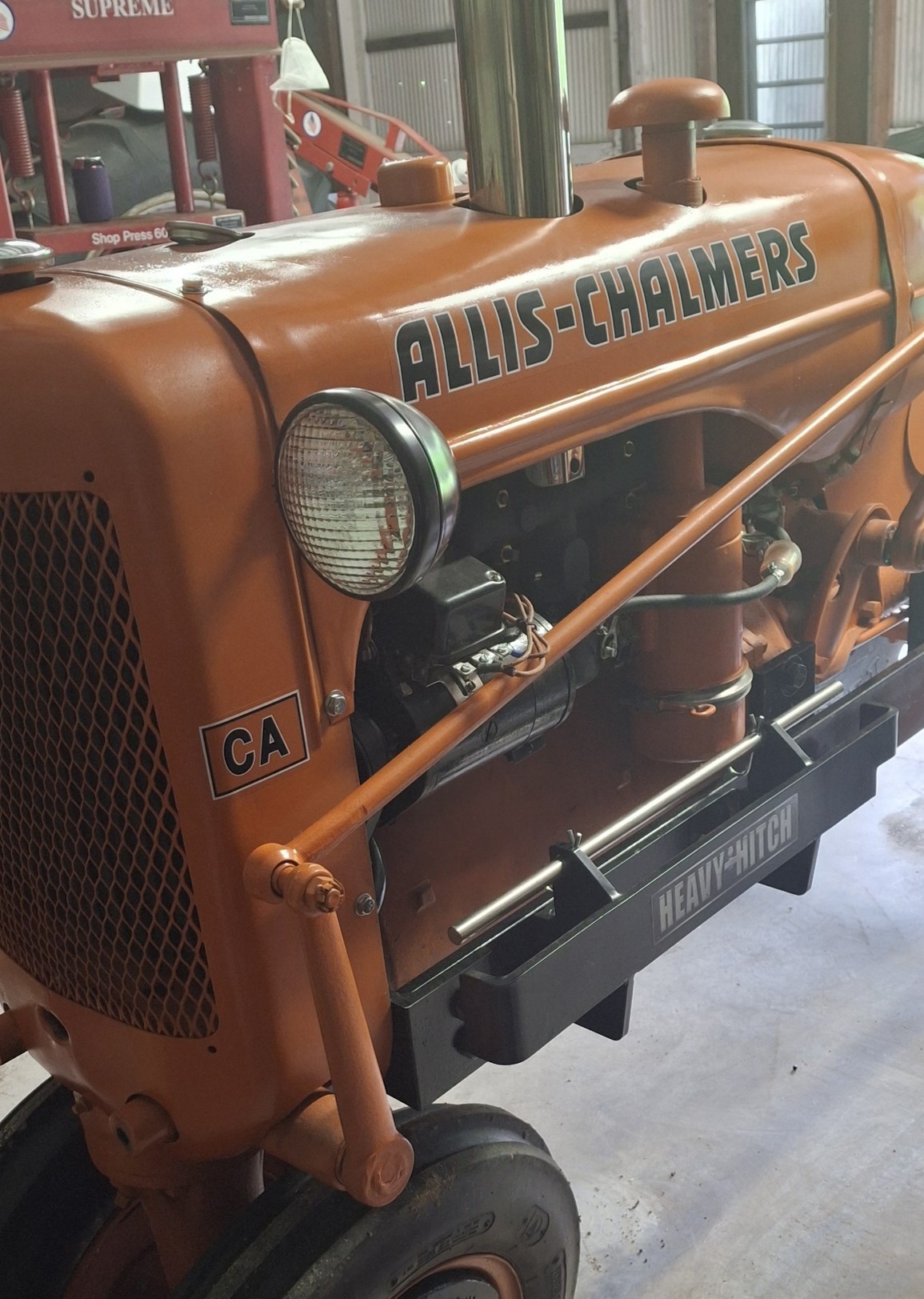

One of the last things done was to apply all the decals (not all technically in the right positions).  I don't think the "CA" decal was designed quite right.  It had a rectangular box around it which caused the decal to wrap around the front of the cowling.  I guess I could have placed it lower, but the directions indicated it should go in front of the lower hood bolt.
The hood and gas tank were severely damaged in various logging accidents.  I spent more time than I had trying to improve them, but there were too many other mechanical issues I had to get to so I cut my losses.  I may revisit it one day.

In order to keep the PTO shaft from hitting the implement top link bracket, I modified the rear to top link braces to bring the top link bracket fully vertical and inline above the lower lift arm attachments.  This significantly improved the PTO shaft clearance by several inches (mostly problematic at the lowest lift position).  The old Zephyr 510 450RPM 1/2 inch drill nearly broke my arm drilling those large holes.  I remember it almost broke my arm in the 60s when I used it too.  I was surprised it's still functional :).

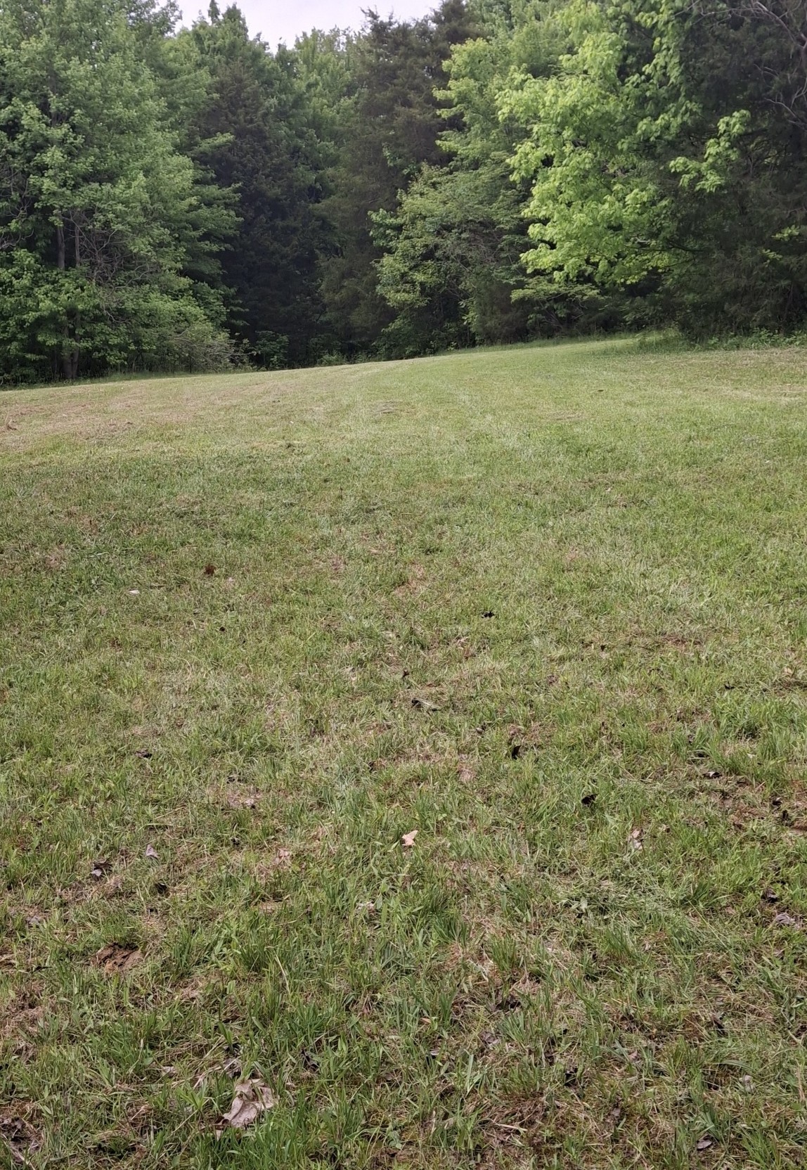

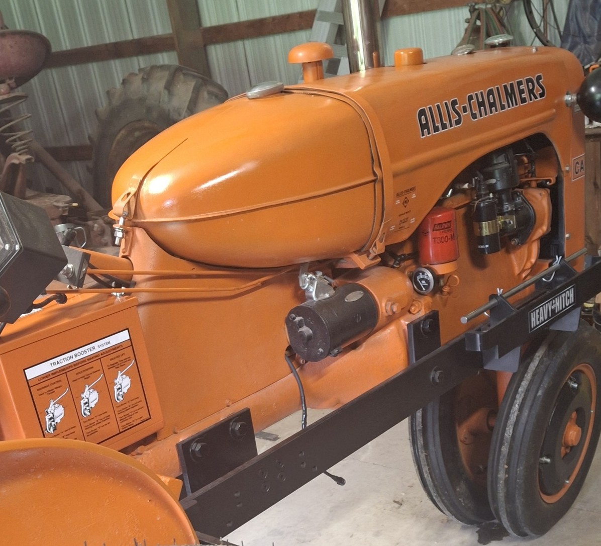

First use after 30+ years was to mow a small field with a finish mower at the highest cut setting.  It did fairly well.  Two videos are posted at:  https://www.youtube.com/@OrangeAcres-h2k
One shows the tractor state as of March of 2023.  The other shows the tractor in use mowing this field.  I didn't start recording until after the field was mowed and I was going back over chopping the "wind rows" and missed sprigs.  This was 3 feet tall in spots.

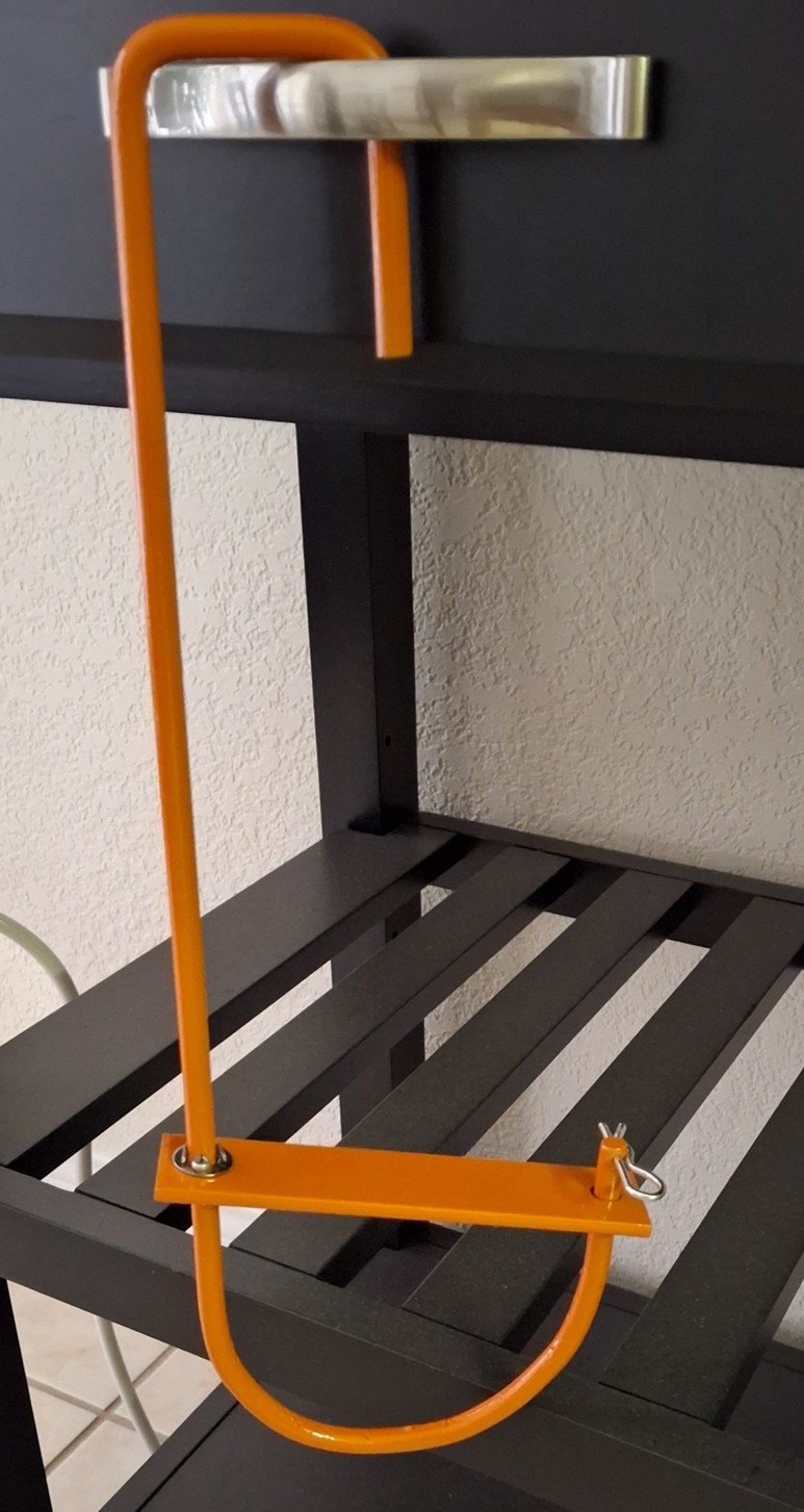

I'm not sure how often it might be useful, but I don't like the idea of going down the road with the implement raised in the "hold" position with the PTO off (to stop blades from turning, etc.).  I've not detected any droop so far, but for longer distances between fields, I might just disconnect the PTO shaft and leave the pump on.  So, I made a little PTO shaft hanger with a lock mechanism (probably unnecessary).  It should hang on the PTO shield extension through a single hole (to be drilled).  I had intended to add a little flare of the top hanging end straight outward as a sort of locking mechanism for the top attachment, but I should have added that bend first because it no longer fit in the bender tool or vise conveniently.  I doubt it would bounce out anyway though.  If I decide not to add the bend later, I may need to shorten the top hook just a bit to avoid the PTO shaft if needed.  Surprisingly, my cheap tubing bender bent this solid rod easily.  But it didn't quite have enough throw length, and I had to finish it in the vise.  I looked at some rebar benders that look useful for these types of brackets.  I typically do these in a vise.  I have an Eastman bender that does a good job, but sometimes the bend radius is not sharp enough and sometimes the bend is too complex (or part too small) to fit the part in.
Edit:  I compromised and bent the tip of the top end straight back (90deg) instead of out.  The hole in the PTO shield bracket will need to be slightly larger to accommodate inserting the upper end and rounding the 90 degree bend.  I only scuffed the paint a little.

I did have a canopy that I fabricated the framework out of 2” steel square tubing and angle iron for the feet to bolt between the fenders and on top of the platform. I used a canopy top from a Ezgo golf cart for the top.
It is Not Rollover approved, but worked well for my lawn maintenance applications!
