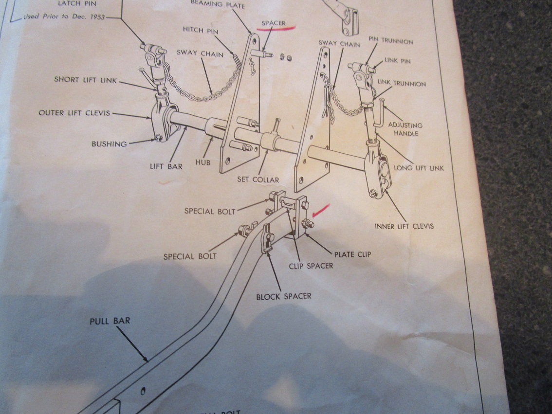

What does the "special" refer to relative to the bolts used for the pickup plow?  Those I checked were fine thread.  Were these hardened beyond 4140?

Two bolts below were 3/4 hex head bolts both fine threaded and labeled "special".  Would those be "shear" bolts?  Or would they be higher strength bolts?  The second one is the upper bolt of the U bracket.  I used grade 8.  I don't think it matters much at this point, was just curious.

Post Options Post Options   Thanks (0) Thanks(0)   Quote Mikez Quote  Post ReplyReply Direct Link To This Post Posted: 02 Apr 2026 at 6:26pm
The original part numbers for those were
321893 then the numerical book says use 916290 which are grade 5. 3/4” x 3-1/2”
321896 numerical book says to use 916292 which are grade 5. 3/4” x 4-1/4”

Post Options Post Options   Thanks (0) Thanks(0)   Quote dfwallis Quote  Post ReplyReply Direct Link To This Post Posted: 02 Apr 2026 at 6:34pm
Hmm, grade 5 is roughly equivalent to 4140 which most everything else was, I thought.

Could it be a shoulder bolt? I've seen that in manuals too. Had that sort of stuff apart but been a long time ago and can't remember.

Post Options Post Options   Thanks (0) Thanks(0)   Quote dfwallis Quote  Post ReplyReply Direct Link To This Post Posted: 03 Apr 2026 at 10:43am
The two bolts referenced were normal hex bolts (I'm reasonably sure the bolts I removed were original), only they were fine thread.

Post Options Post Options   Thanks (0) Thanks(0)   Quote dfwallis Quote  Post ReplyReply Direct Link To This Post Posted: 03 Apr 2026 at 11:08am
I think my conclusion is that "special" just means any characteristic that is different from a standard hex head coarse thread (4140?) bolt.

Post Options Post Options   Thanks (1) Thanks(1)   Quote wjohn Quote  Post ReplyReply Direct Link To This Post Posted: 03 Apr 2026 at 2:20pm
In general "special" could mean any deviation from whatever hardware standard (i.e. ISO etc. documentation) "typical" bolts come from. Could be as simple as the threads being a different pitch, a different hex size for the head, a non-standard length of threads on the shaft, a specified length of chamfer on the end leading to the threads, etc. etc. or something really obvious like a weird shape, totally different head type, or different material.
All "special" really tells you is that technically there is at minimum one small thing that doesn't line with the standard. Sometimes you can get away with an off-the-shelf bolt built per whatever standard, and sometimes you can't, but the manufacturer (AC in this case) typically had some reason for choosing that special bolt in the first place. It could just be something that made it easier to assemble or it could be something that kept it from failing in the field.
