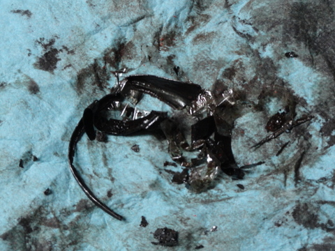

This is what was found wrapped up in the oil intake pipe....

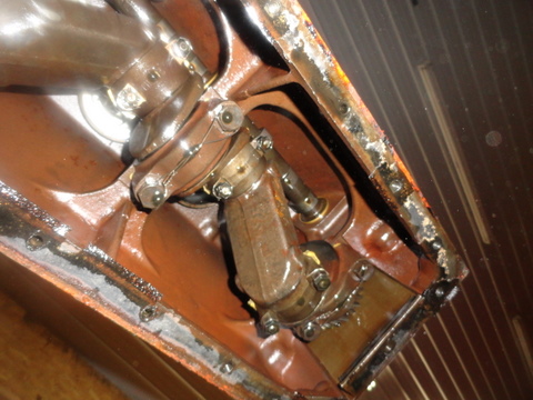

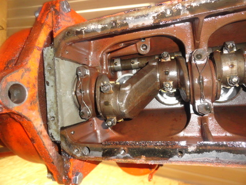

other than that it looks clean and runs great (except the trans problem:)....

Josh, that looks pretty ugly allright but what is it?
BTW the inerds look reall pretty! - like mine, but i still had the knock!

plastic, some metal, and hair of some kind. other then that it looks good.I haven't got to run it much since I put the new gasket on since the trans problem. hope to get that fixed in a week or so.

For all the crud in the oil screen, everything else sure is clean!  Looks like someone believed in detergent oil for a long time.

Why did you take it apart? was there noise or no oil pressure?

From all the crud you have a picture of, might want to take bearing off and clean all the oil journals.   I bought a tractor that had a tick in it, and part of the oil pump had broken, got beaten into a million pieces and a small piece of metal got caught in the oil journal to a rod bearing.   Had to have crank turned.   Had I caught it before I could have saved a bunch of money.
