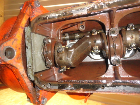

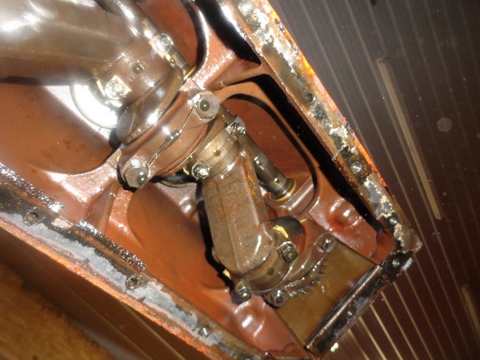

This is what was found wrapped up in the oil intake pipe....
other than that it looks clean and runs great (except the trans problem:)....

Josh, that looks pretty ugly allright but what is it?
BTW the inerds look reall pretty! - like mine, but i still had the knock!
It's on the back burner for now but I'll get to it (The elusive "round tuit")

plastic, some metal, and hair of some kind. other then that it looks good.I haven't got to run it much since I put the new gasket on since the trans problem. hope to get that fixed in a week or so.

For all the crud in the oil screen, everything else sure is clean!  Looks like someone believed in detergent oil for a long time.

Why did you take it apart? was there noise or no oil pressure?

From all the crud you have a picture of, might want to take bearing off and clean all the oil journals.   I bought a tractor that had a tick in it, and part of the oil pump had broken, got beaten into a million pieces and a small piece of metal got caught in the oil journal to a rod bearing.   Had to have crank turned.   Had I caught it before I could have saved a bunch of money.
