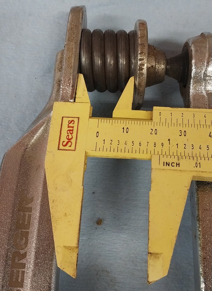

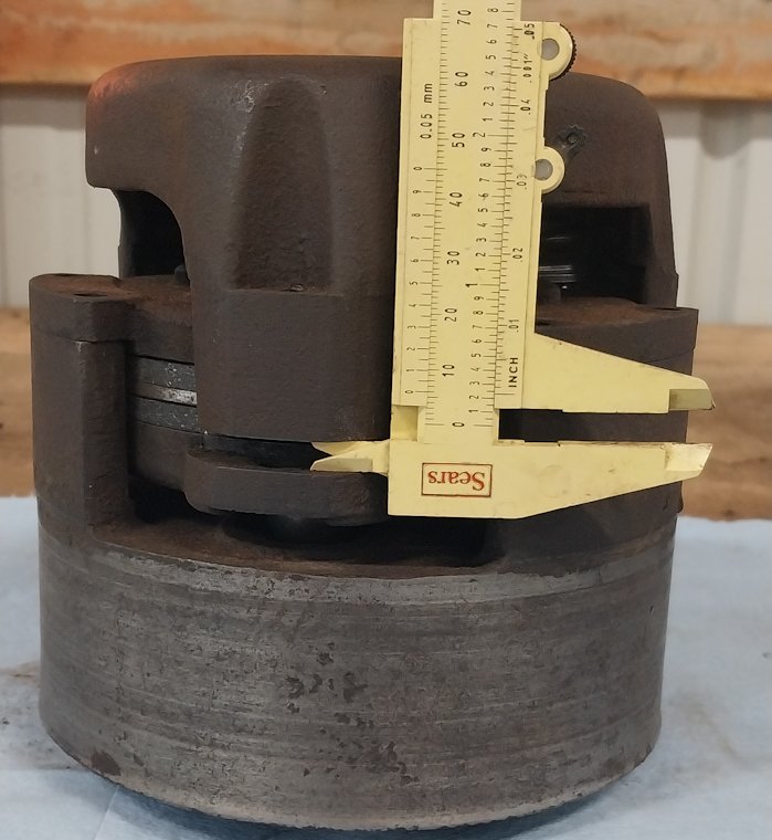

I snapped more photos of measurements that may be worthy of consideration.
This is the spring cover sitting on three springs, when fully assembled there will be no gap. These are the spring cover ears that would need to be milled shorter in order to increase the spring's holding force.
This is a spring fully collapsed in a c-clamp; it would require a massive amount of milling before a stock spring would approach coil bind, but it is something to keep in mind.
