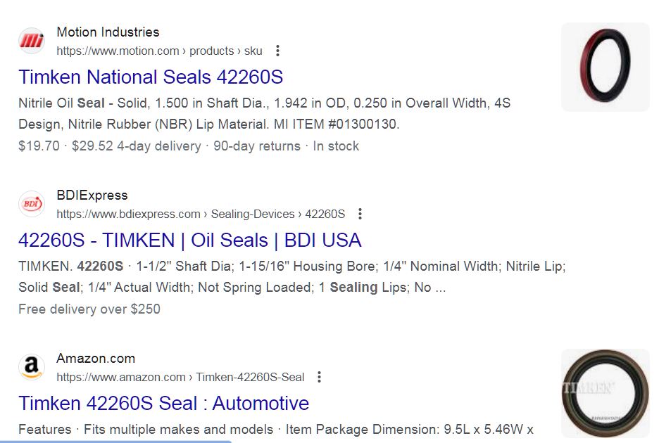

i think your shaft is 1.500 and the housing bore is 1.938 inch..(1-15/16).... the seal you can get is a 1.942 OD  ....... check these out...

Thanks Steve for the reply. I’ve tried that size seal . It fits the shaft but not the bore. I measure the bore at 1.922. I’ll measure again to double check later this afternoon.
