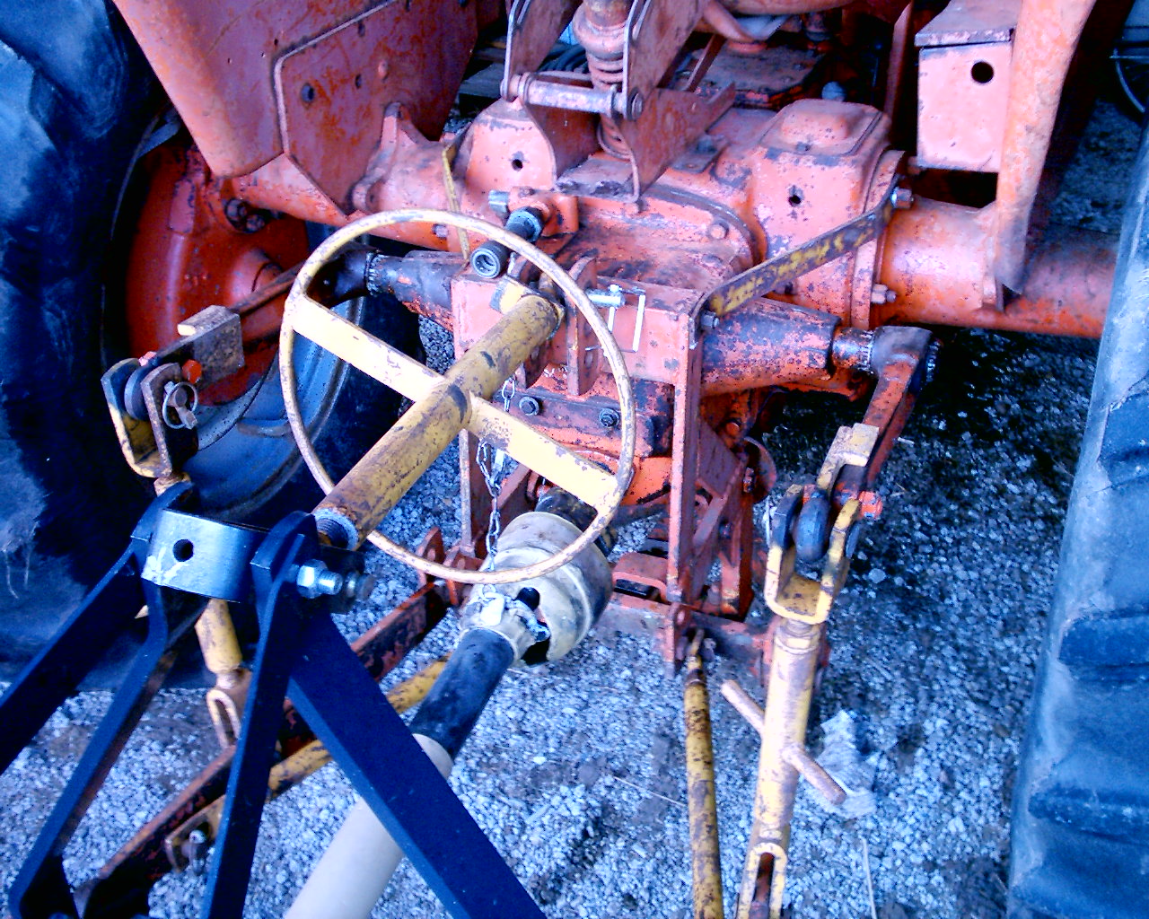

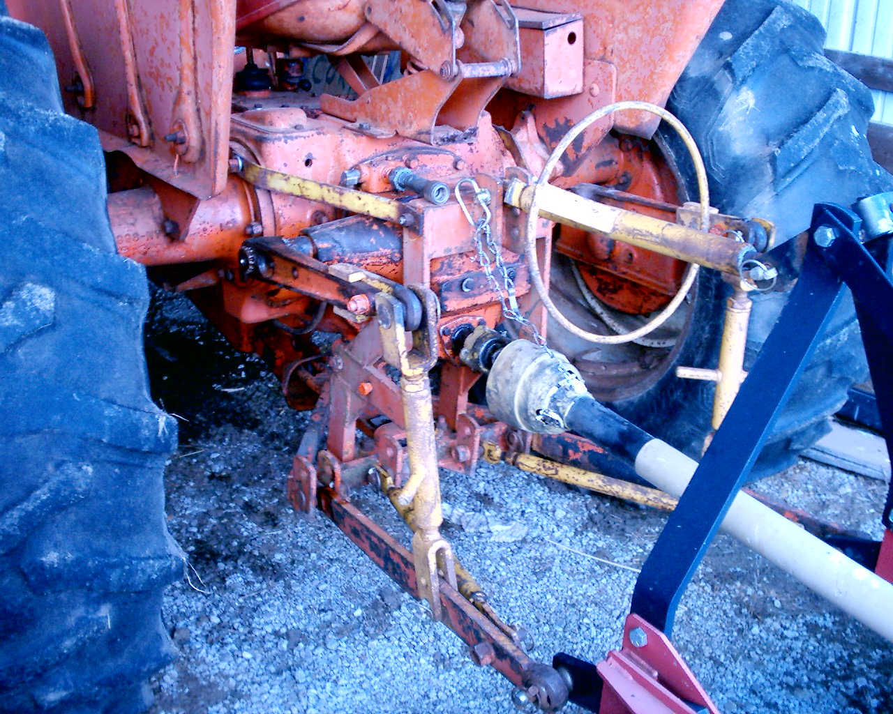

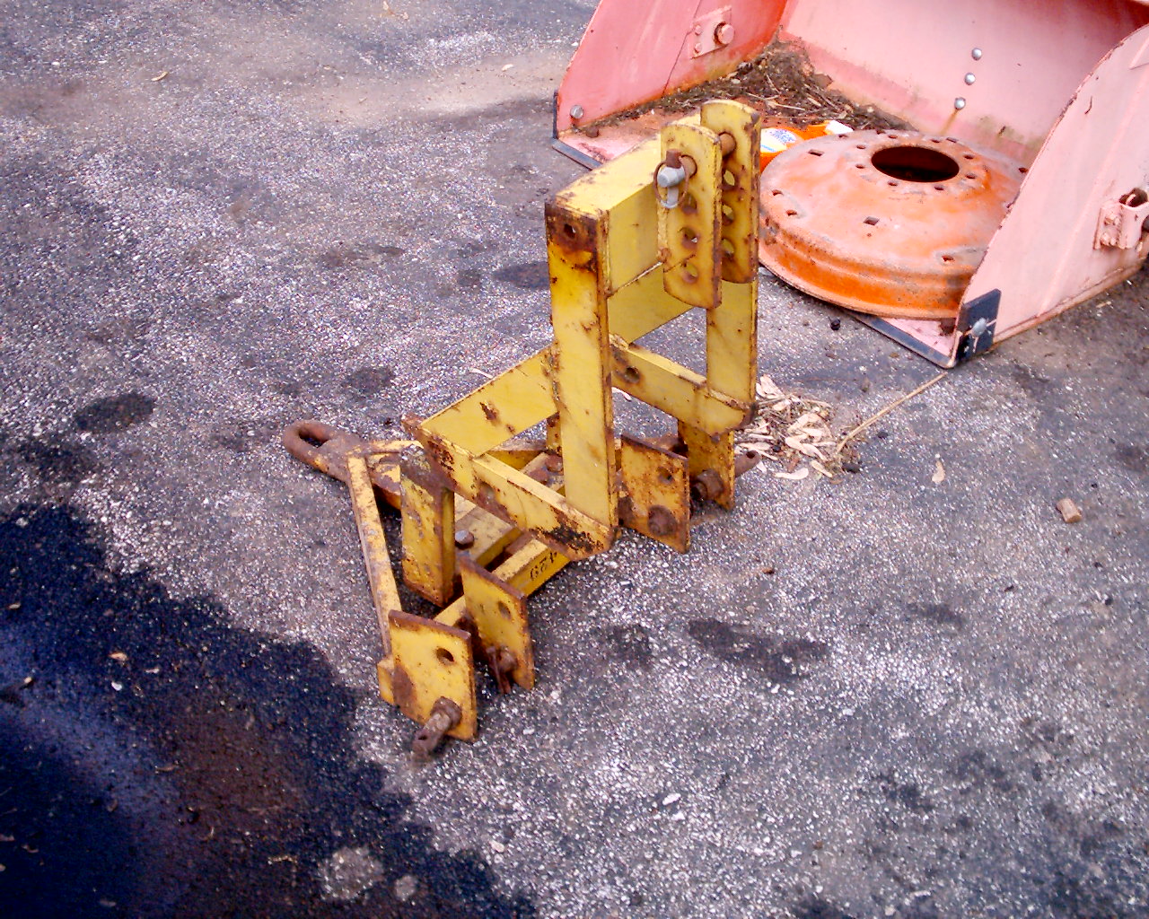

Tracy: Here is the pictures of my Speco 3 point units, one mounted and one not.

Dave/ Tracey. That looks like it BUT It does not have anything to go snap into the bell.  It looks like it bolts to back of tractor or something.  It also uses a different type top link that goes around shaft on back.  Its about a foot long.  I see how the extra links hook to the lift arms, and the balls with different size holes in them..  The top link wheel is not nearly that big on this one.  Same paint but it says AC 1423 on it where I can see 429 on yours

Tomorrow I will get that entire number off of the yellow unit.  Dave.

Thanks Dave, I had never seen one of those. Seems like alot of work . How does it work geometry wise? Does it bole to drawbar bail brackets? Thanks Tracy Martin

Tracy, I have one of those on my D17D III. It was also on a D14 originally. Works great. Needs some tightening up. Mine doesn't have the braces from the top to the axle bolt, but may have soon. If you need to look at it let me know. Eric

It is very easy to install. Just snap into bell, install the pins that you install for a drawbar, and then bolt on the two braces on top. I didn't realize it used the two braces until I bought the second unit. It is very stable, you just tighten the sway bars to desired stability and nothing moves. It works perfect for my Bush Hog AT99.
