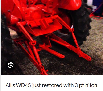

Post Options Post Options   Thanks (0) Thanks(0)   Quote steve(ill) Quote  Post ReplyReply Direct Link To This Post Posted: 11 Apr 2025 at 8:56pm
John... just to double check.. You have the rock shaft and upper arms on the tractor and that works ?  Your wanting to install lower arms with or without the drawbar.. to attach to the mower...( do you have a drawbar and frame ?)  Will you need the drawbar after that ?  Will the mower basically stay on the tractor full time ?
Edited by steve(ill) - 11 Apr 2025 at 8:57pm
Points: 89114
Post Options Post Options   Thanks (0) Thanks(0)   Quote steve(ill) Quote  Post ReplyReply Direct Link To This Post Posted: 11 Apr 2025 at 9:00pm
here is the basic idea.........
if you have a snap coupler and dont need a drawbar.. here is another version..
Edited by steve(ill) - 11 Apr 2025 at 9:08pm
